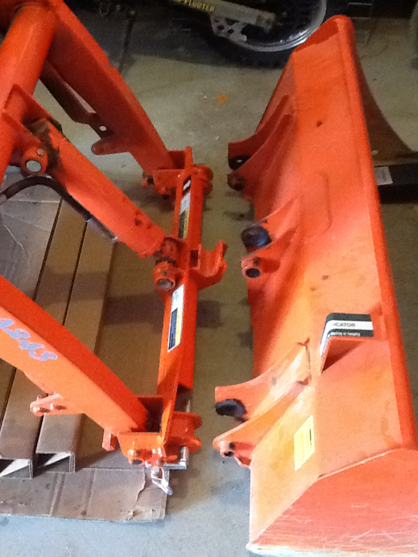

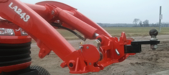

Just posted a pic with Kubota's QA on my bx2350. I got the pallet forks also. I've been happy with it.
   / Putting a BX25D FEL quick attach on an BX24 #6
I have the Kubota quick attach and pallet forks on my BX24. I haven't had them very long but I like them very much. The QA pinned on with no problem, took longer to clean the old grease off than to install the QA. I'll try to post some pics if anyone is interested.

   / Putting a BX25D FEL quick attach on an BX24 #8
Matt
Can you get a zoomed out picture of the whole tractor with just the QA on the loader?
Been thinking about one of these so I can just remove the bucket instead of the whole loader assembly but wasn't sure if the arms would stick out too far when just mowing around stuff.
Thanks
