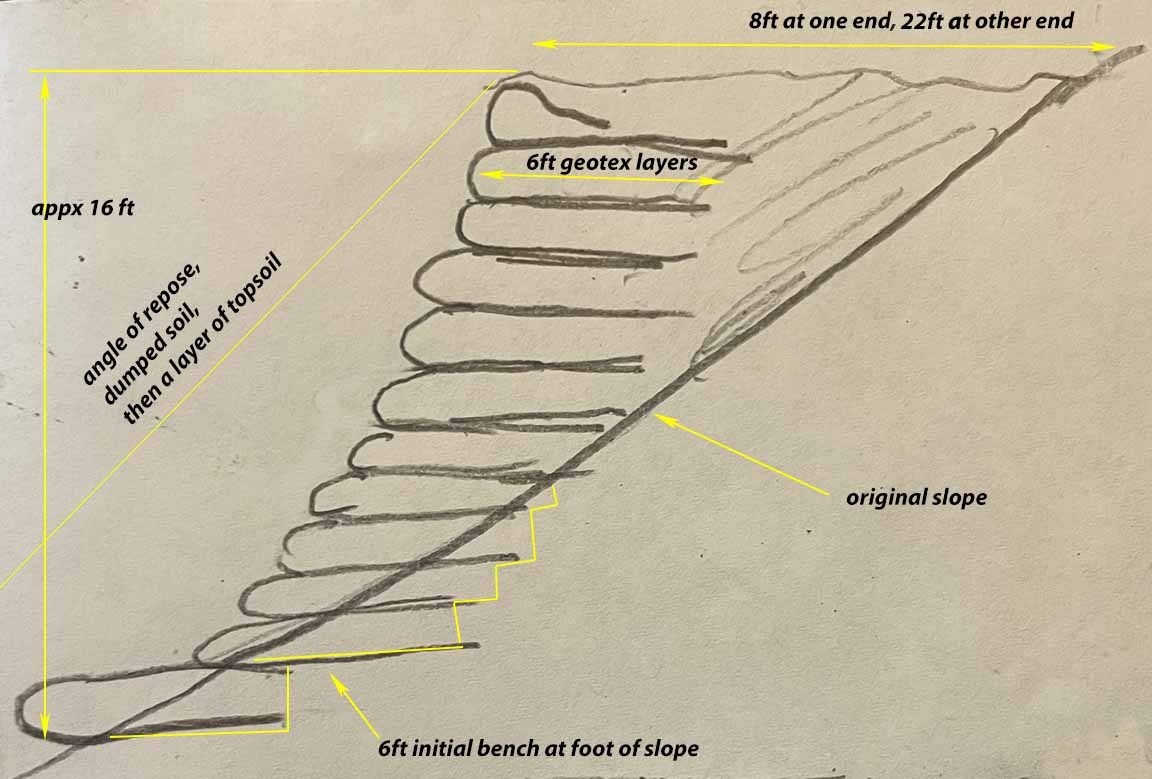

Several location on my (steep) land are 'fills' that have been here since ?1960s? and they are still OK. They don't move.
And they have no geotextile reinforcement.
I have some other areas that I have filled even 12 feet thick, simply dumping the dirt over the slope. Areas where there's no consequence to soil slippage. They are firming up, not moving.
There's no water source above, and no earthquakes (yet).
I don't think many have a concept of how substantial geotextile reinforcement is.
A lot of folks understand "roots".
Geotextile is like permanent, horizontal roots, but much stronger because it's 2-axis. And it doesn't die then decompose.
The "foot" of my geotextile layup is near the base of the slope, so there's nowhere for this layup 'to go'.

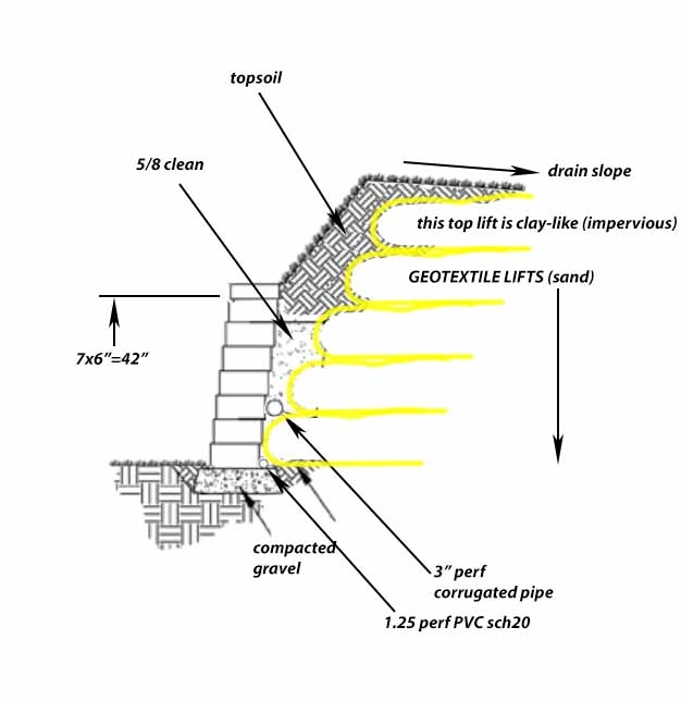

Here is a quick sketch.
I expect the topsoil to completely cover the (sand) lifts and protect them from erosion.
I do not expect enough water to erode anything.
In April, vegetation will grow with a vengeance.
Around here soil that has been undisturbed for 40+ yrs is considered stable for building.

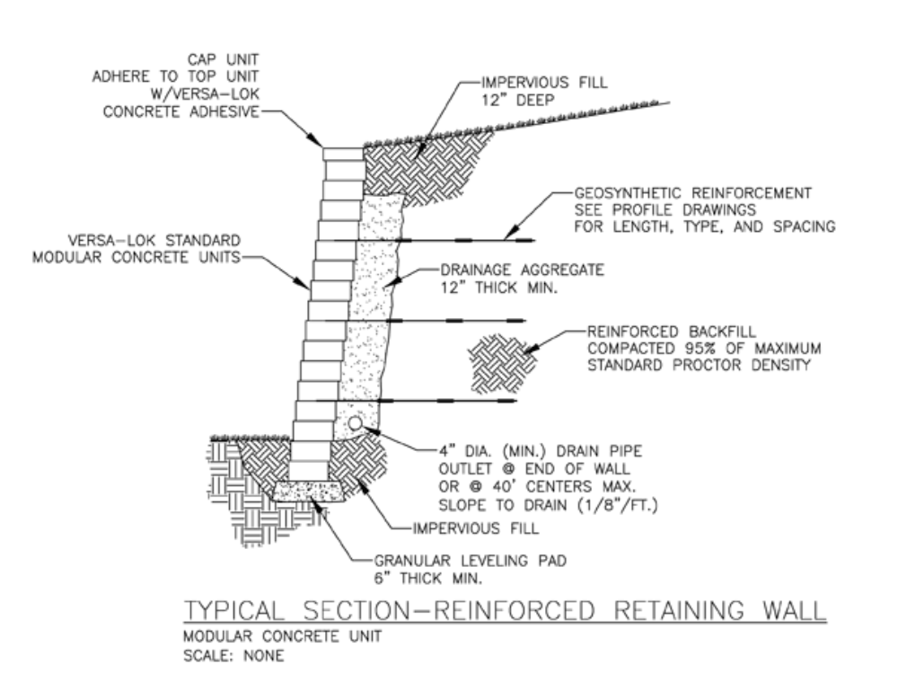

I made this image with photoshop from an install doc posted by airbiscuit.

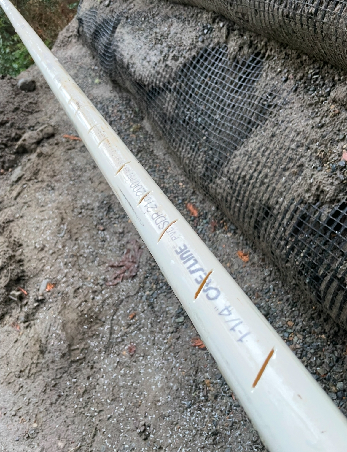

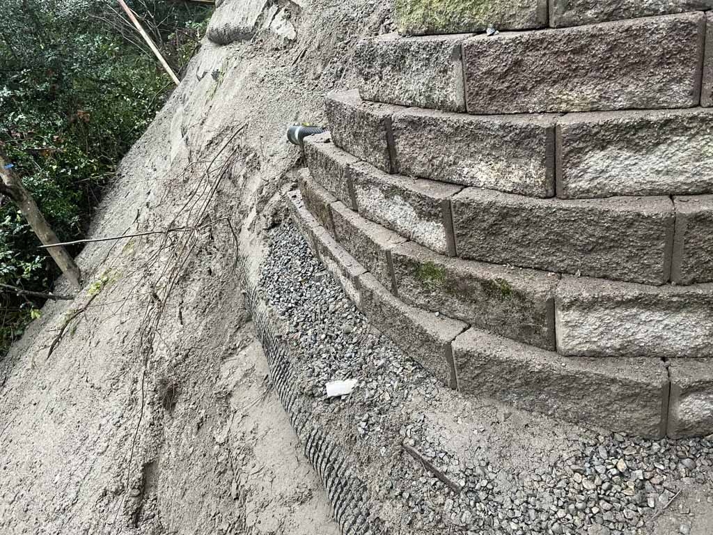

here's the two wall drains
1.25" drain at the bottom, and the 3" corrugated at the 3rd course.
Not even "one drip" has exited either pipe since installation in January.
Each pipe has "original dust" in its end.
But someday, when the gravel drains fill with silt, the open pipes may begin to carry water out.

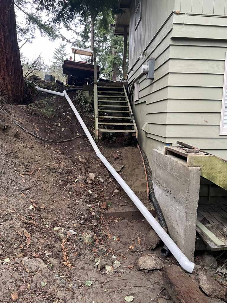

Oooops sorry - this pic was long before the geotex layup.
Here's the driveway + roof downspout drain.
And the perforated pipe at the house foundation.
You can see where I cut the stairway, just past the center supports. Adding a landing.
The cut part of the stairway continues (at right) sitting on the (new) concrete retaining wall.
That little 'whoopee'🧐 in the wall end will get buried, luckily.

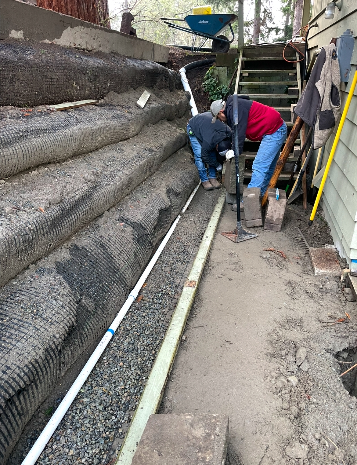

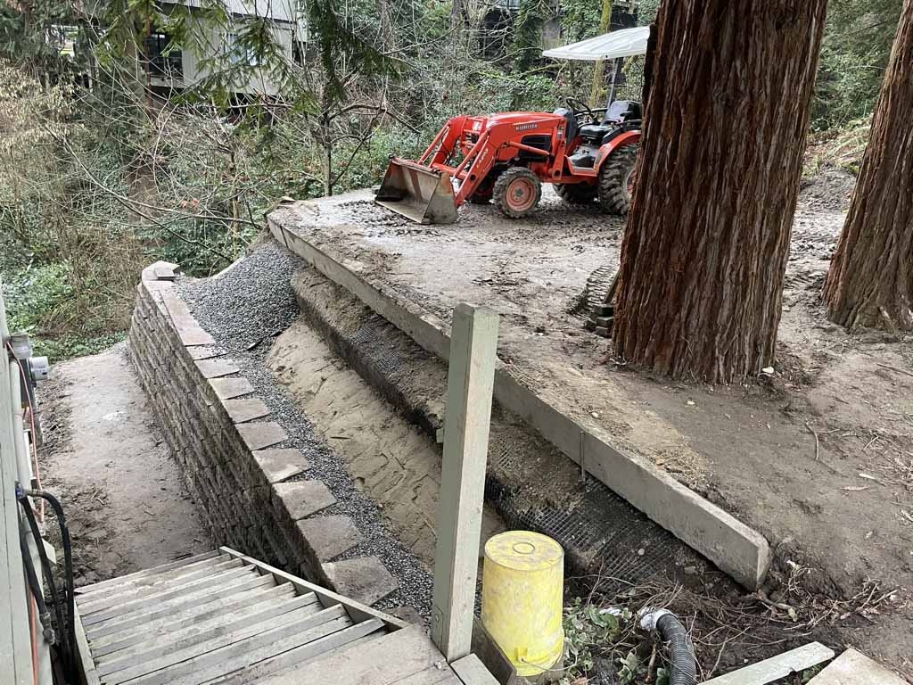

Backfilling wall with drain gravel
Here is today, (6 months later, summertime).
I'll put those large permeable tiles to park on, and grass seed.

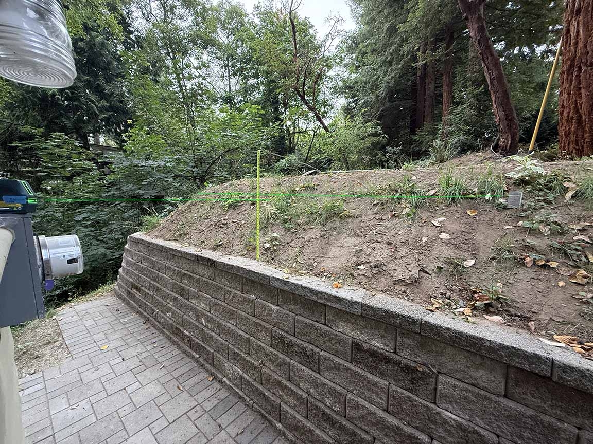

Enhanced pic with 'green-line' added by photoshop

I'll measure & document summertime heights of the wall-tops,
.....then measure again after winter 2025 & report back.

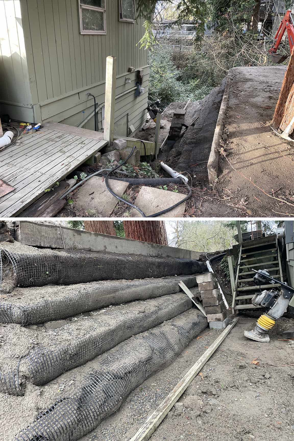

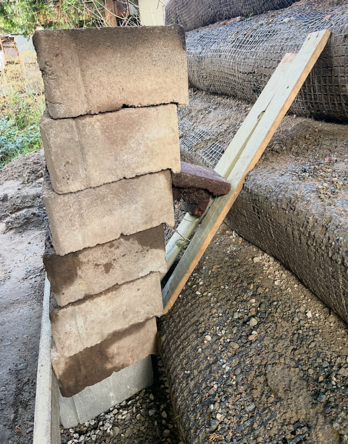

I would have liked to have a real "compactor". But you can't have every piece of eqpt that you wish for just hanging around. DIY can take months.
Finding a trucker to bring me SAND for fill, that concern reduced somewhat. (Free sand !, a little bit moist. and LOTS of it !)
Wish I had a 3rd pic (of the geotex folded over ontop.)
Tracked vehicle doesn't compact much, but it's moist sand, and its heavy.
I suppose it's weight compacts all the lift layers below.
Those form boards are 4x12 held vertical with #5 rebar stakes into the geotex lift below.
I have laser elevations "before", and will be able to measure settling of the top surface as time passes.
What I most needed, and wasn't able to get, was confirmation that a stacked block wall leaning against a Geotex retaining wall was..... "no worries of soil pressure against the block wall".
(re: Civil Engineer member Sam Wise, see post Who knows about stacked-block retaining walls?) who wrote that the stacked block wall was a decorative facing for the (geotextile) retaining wall.
If that's the case.....
and I tend to believe it🧐
then there's almost no pressure on my stacked blocks.
Anyway, I had to press on, with advice from just one TBN engineer who told me what I wanted to hear and of course it was a sweet sound...
block-wall-diagram-jpg.2651749
Any more civil engineers willing to opine......?
Is the block wall subject to soil pressure from the geotextile reinforced embankment?
The 5/8clean gravel and the topsoil heap doesn't look like 'much'.
The block mfr approves 42" max (without reinforcement).
