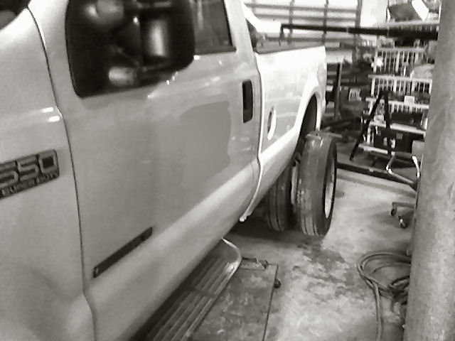

Well the bed is on and straight and lines up well !! I made some brackets to bolt the bed to frame and I have one more set to make and it will be bolted tight and right with a very solid mounting system. The shims/large washers worked great and it is looking nice. Pictures later today for all of us picture lovers LOL

Thanks Bird, I have lots more time than money :D
here are some pictures

Looks good bud!! Nice work!!! A F550 with a pick-up bed.....NOW THATS A TRUCK!!! You will get lots of looks with that!!

I think the only things that will give it away as a F-550 are the wheel size and F-550 emblems other than that it should look like a F-350 dually
