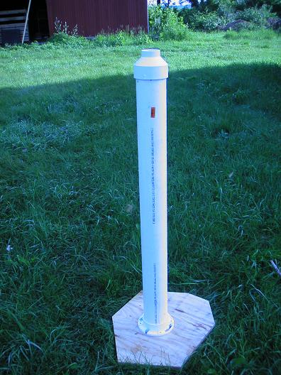

Here is a pic. One thing that is missing from this is some wedges for levelling on unlevel ground. I have to cut some of those yet.

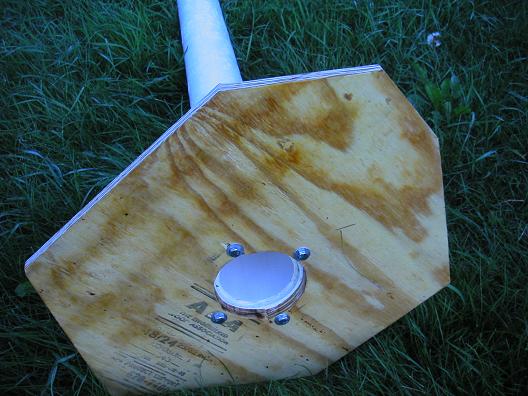

Here is a pic of the base.
   / Putting in steel fence posts with loader #19
here's where you explain that the base shape has been designed after centuries of research to yield the most accurate post placement and ease of use...and not just a scrap of plywood laying around /forums/images/graemlins/grin.gif
   / Putting in steel fence posts with loader #20
I probably missed something, how about showing it working. Looks very interesting,
