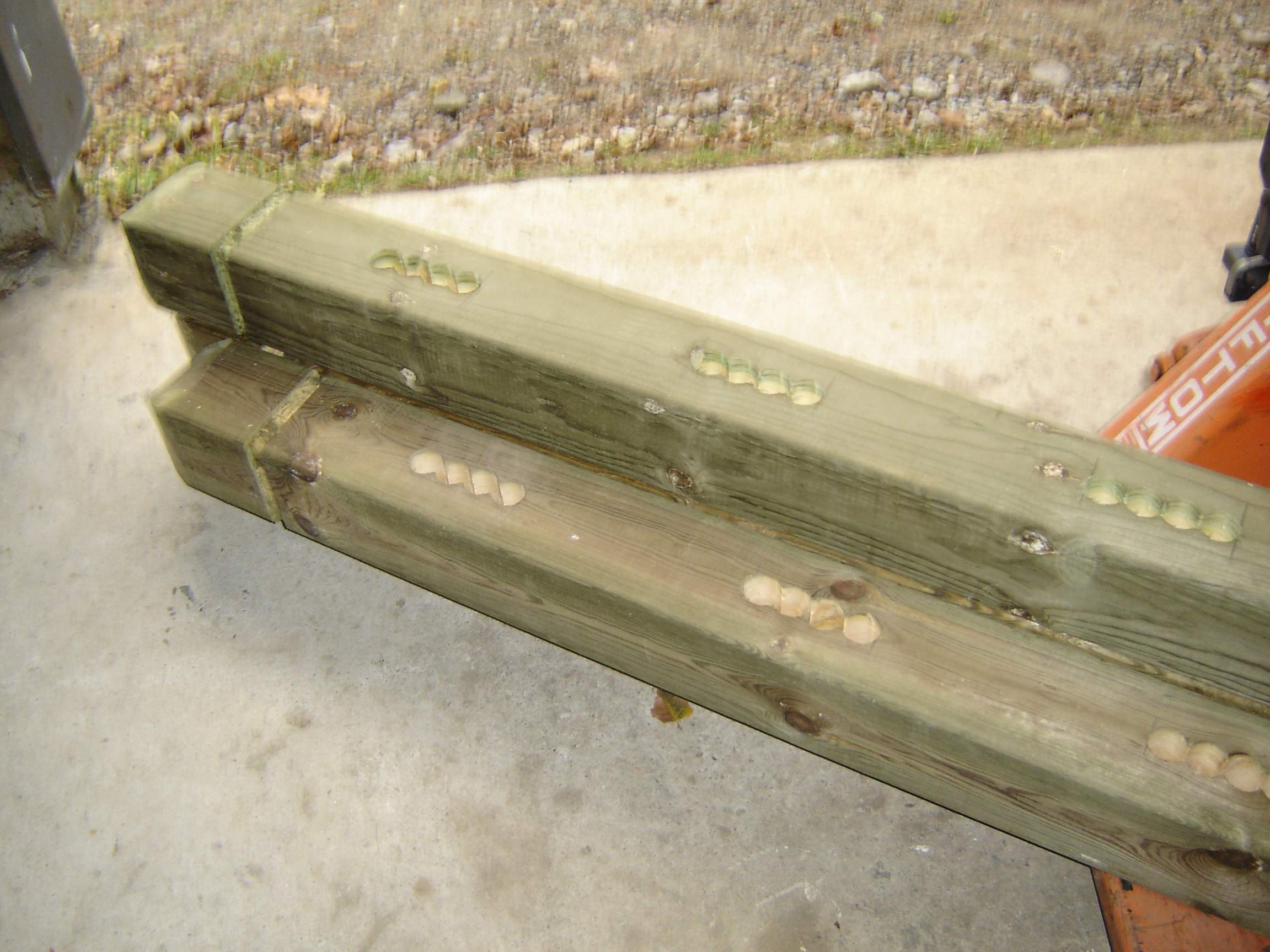

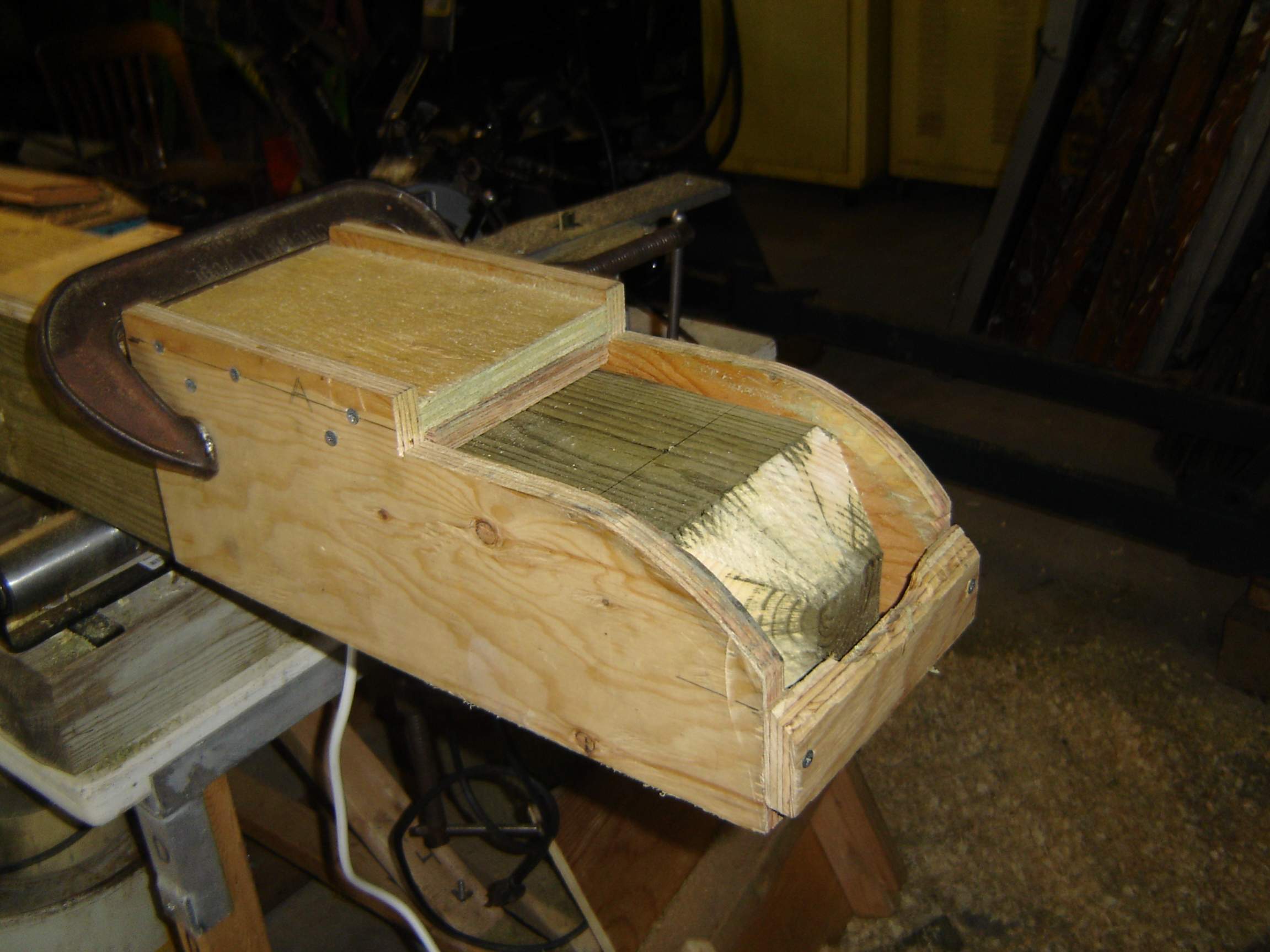

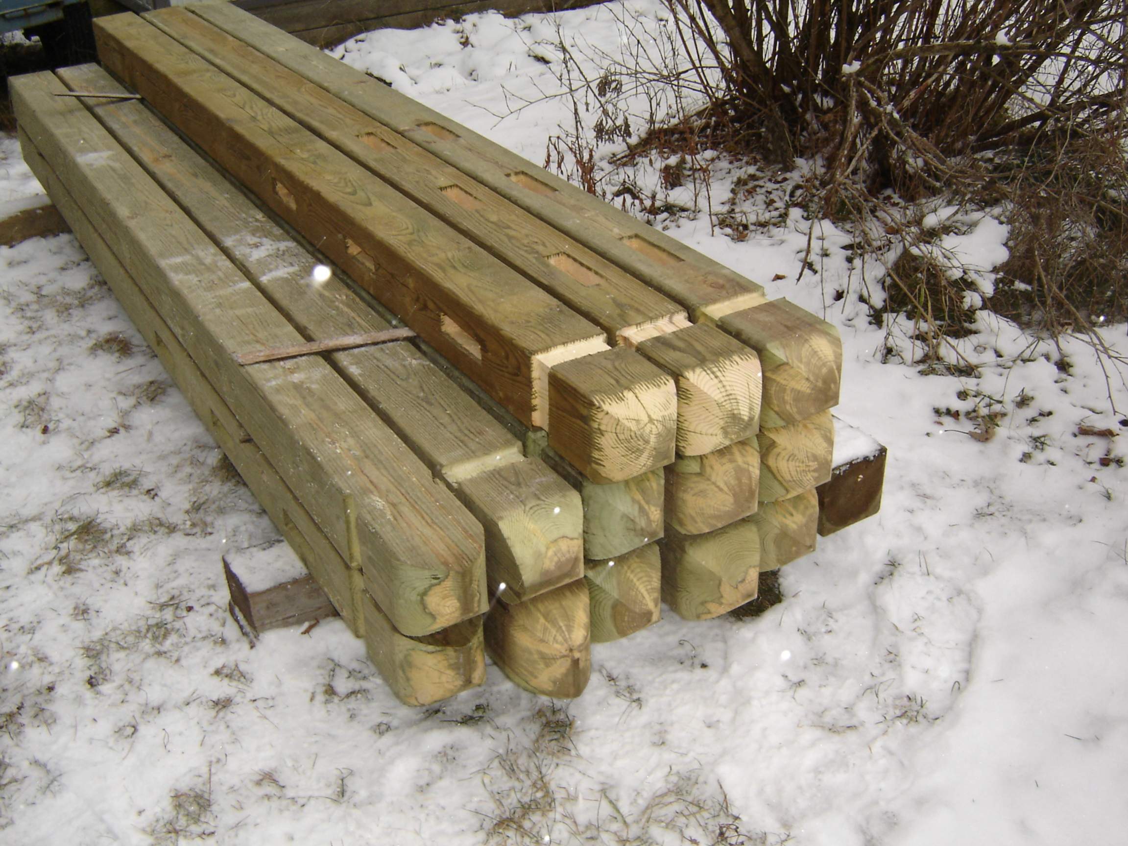

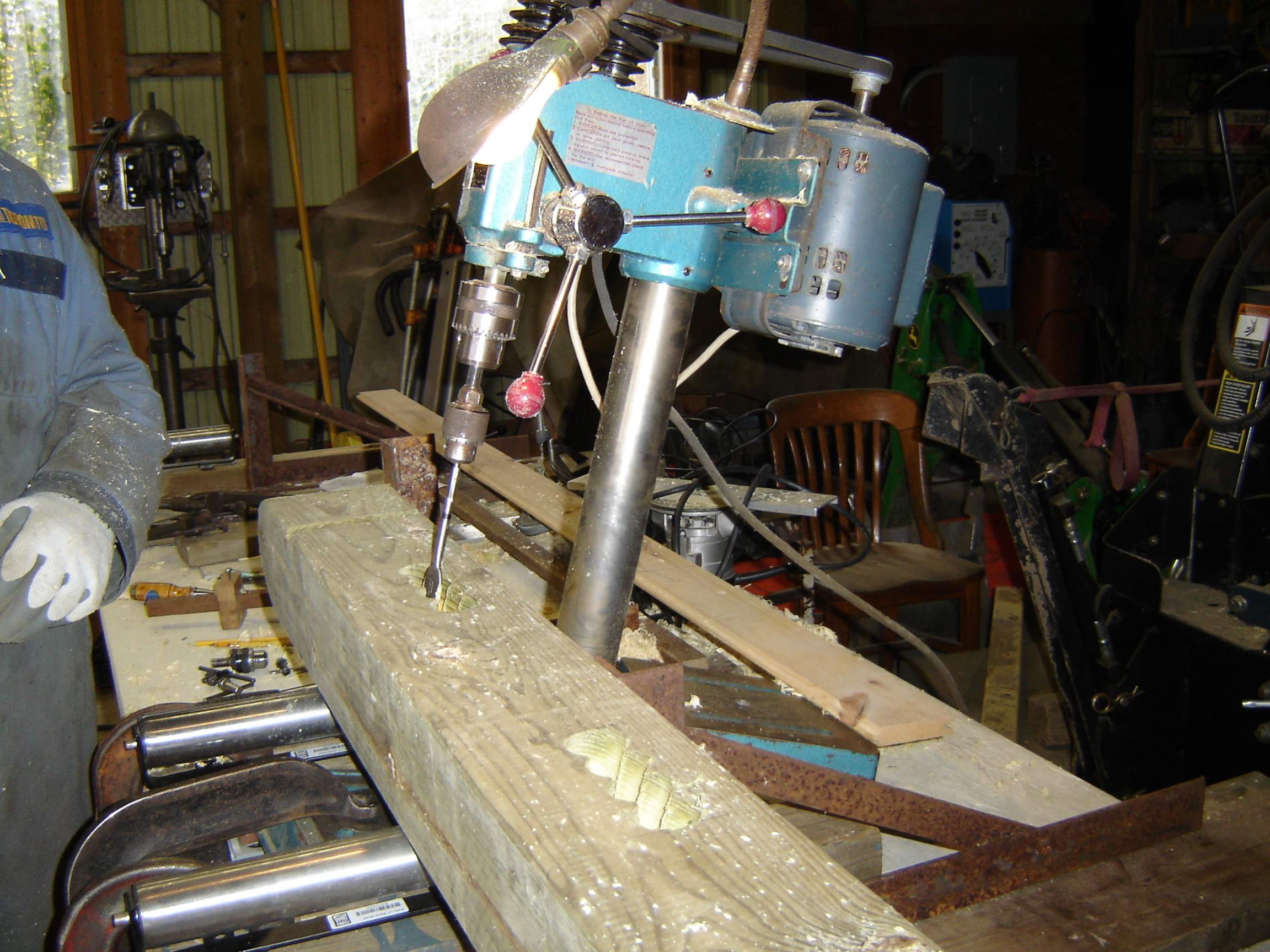

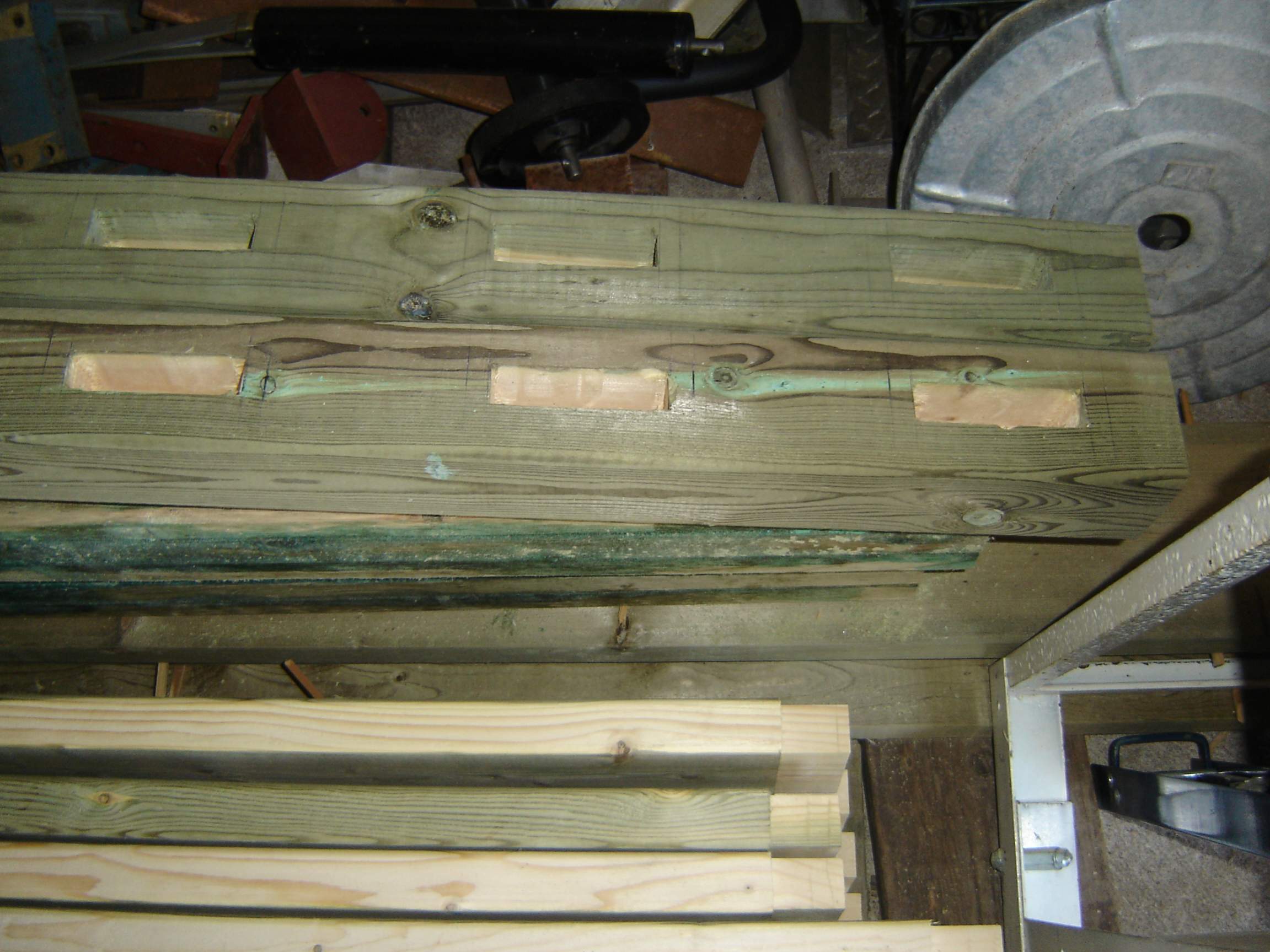

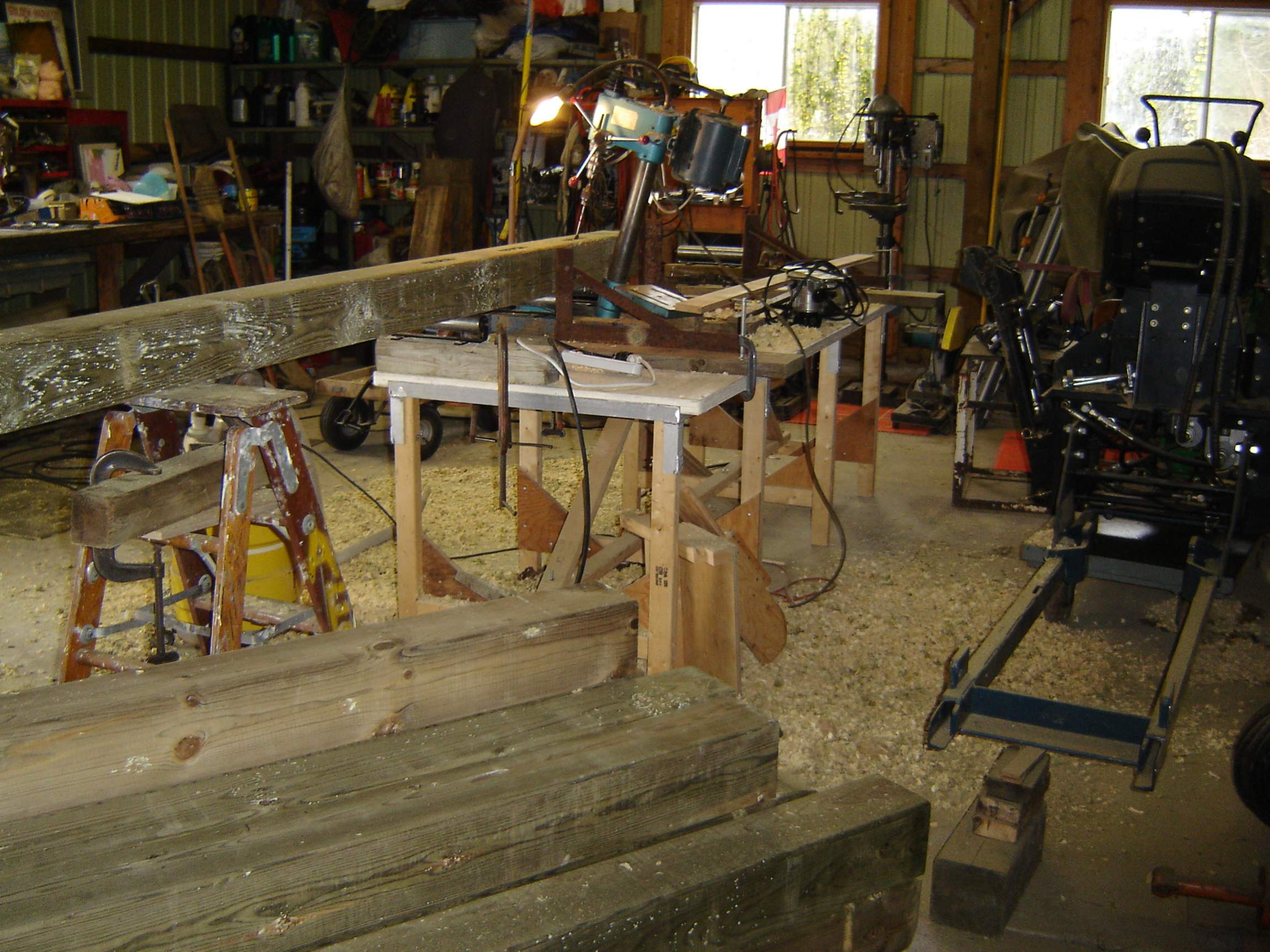

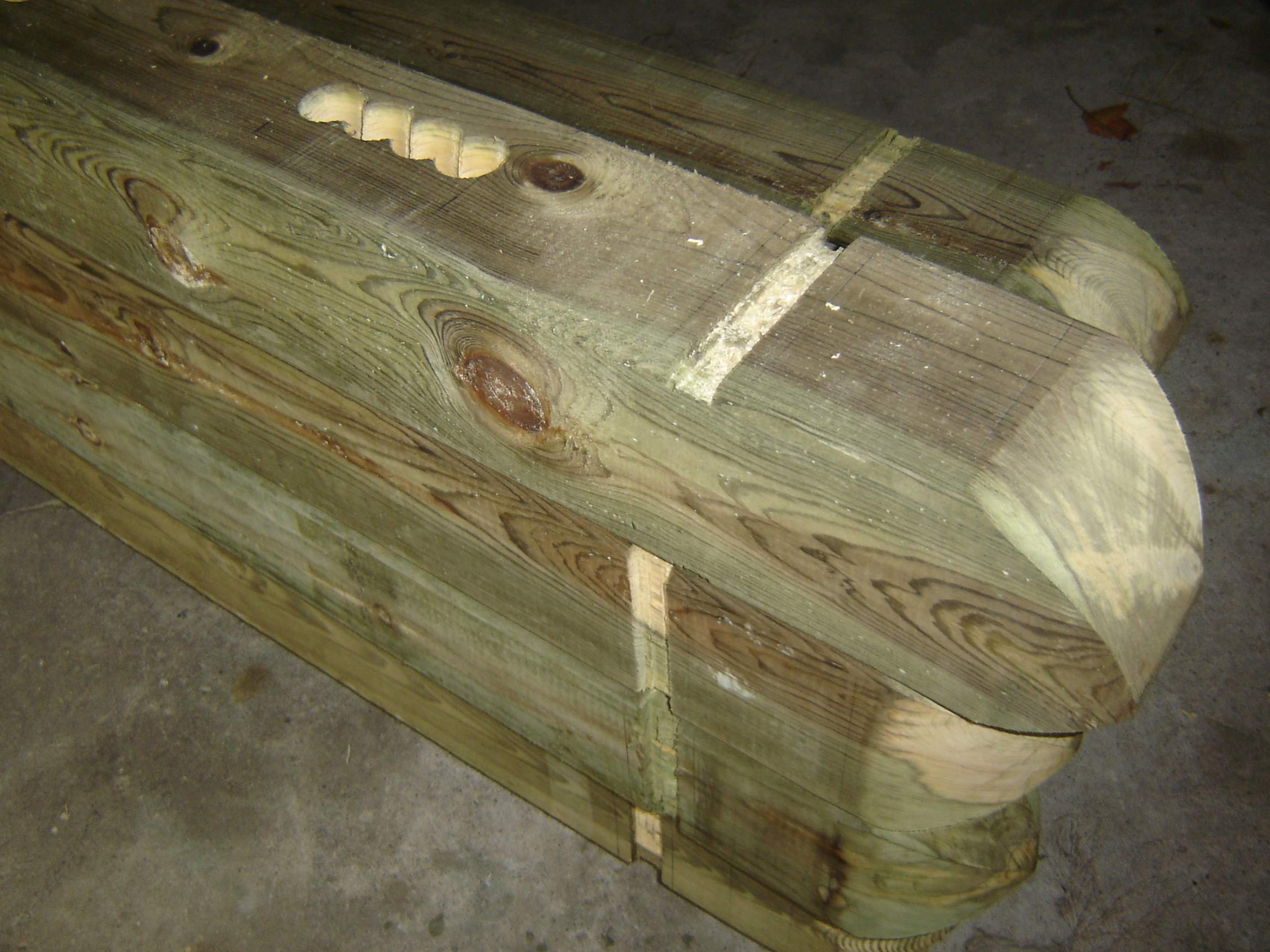

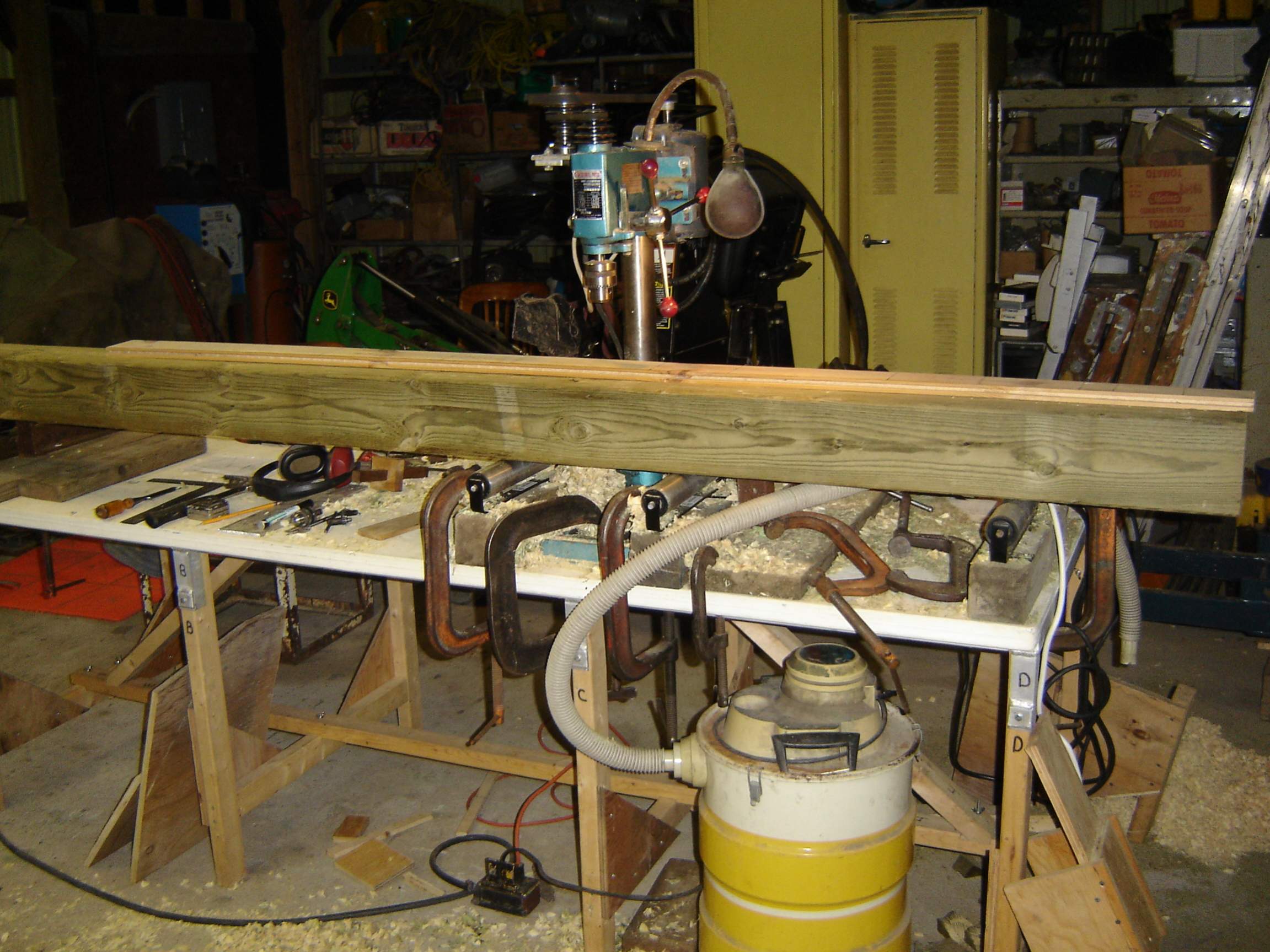

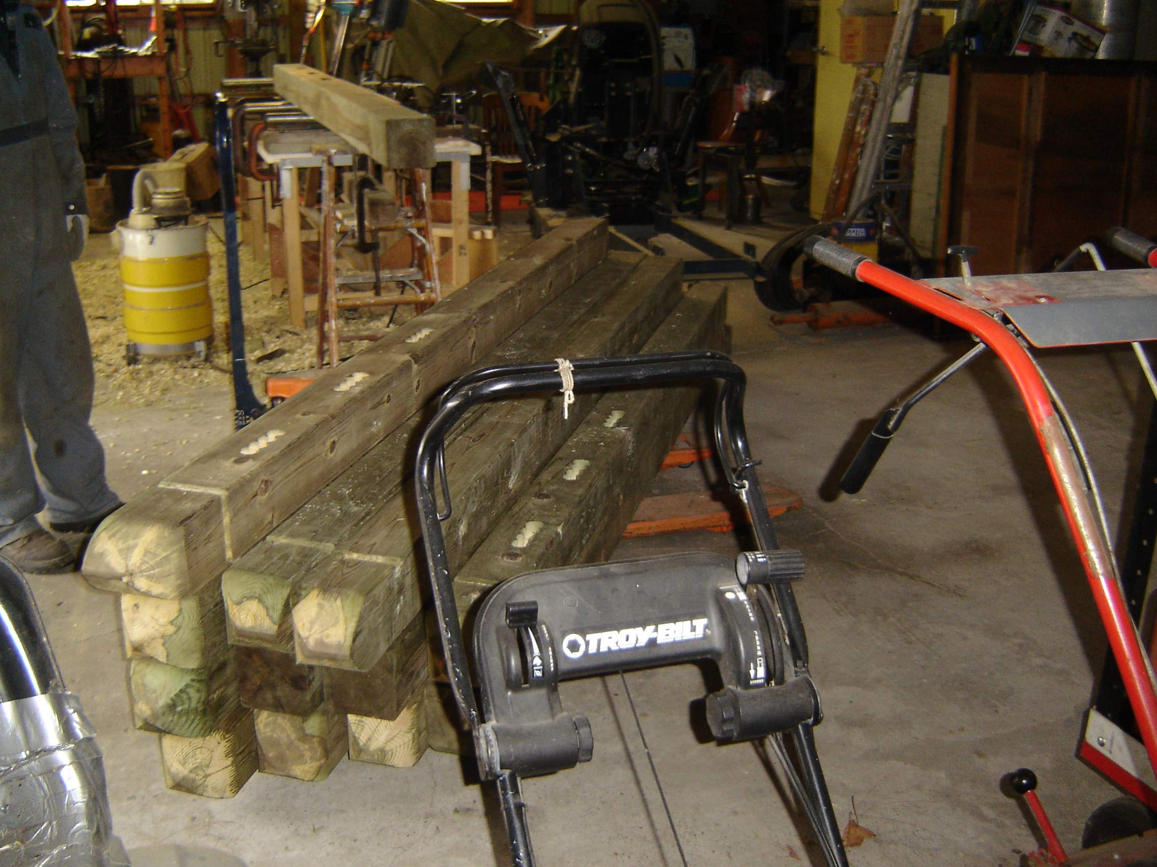

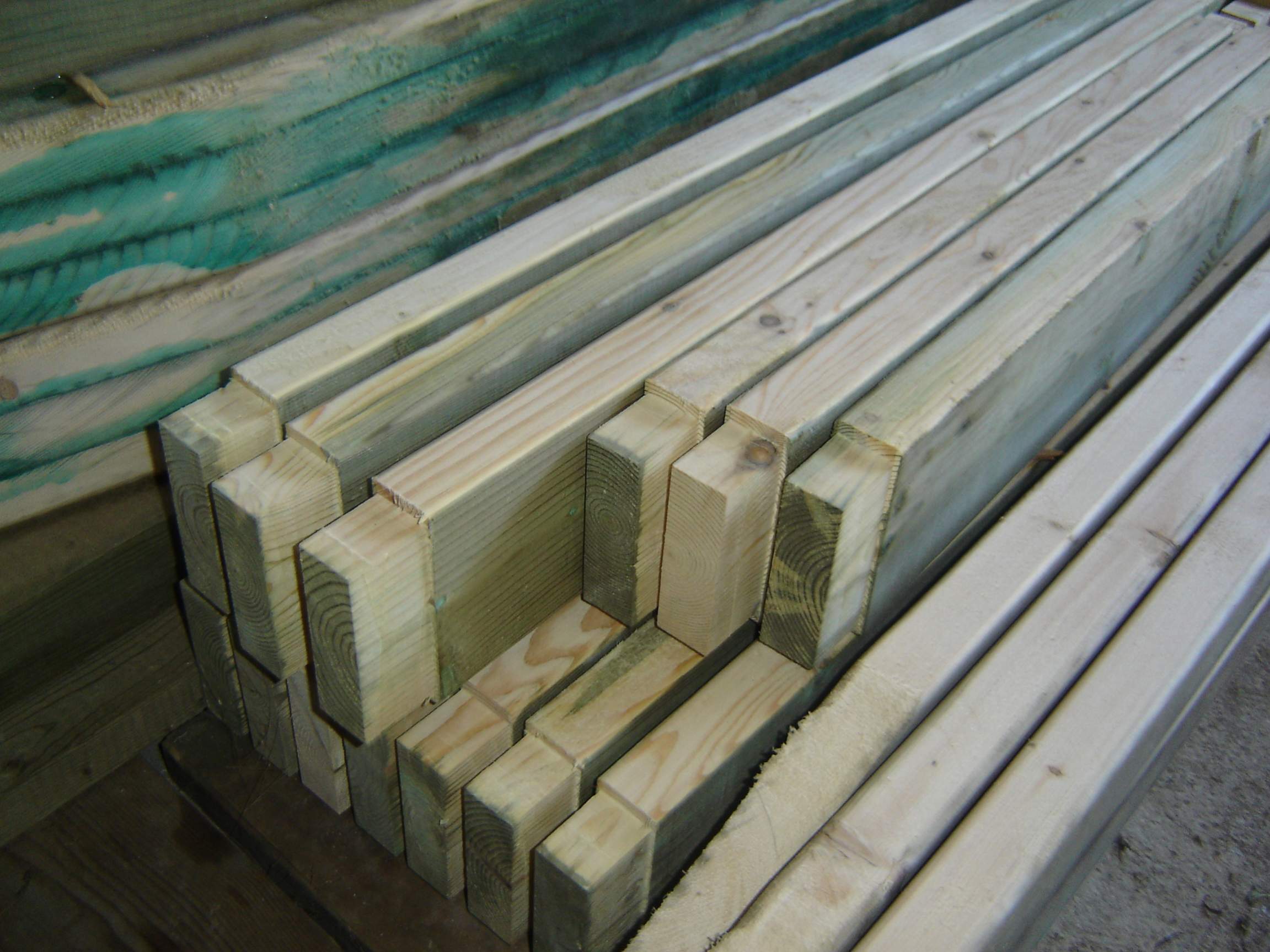

I am presently in the middle of building a 3 rail entrance at the front of the property. I have completed drilling out all 14 6"x6" PT timbers x 10' .Yes they are long but only 4' 8" are going in the ground and the rest has a fancy top. I have pics of the posts but they still in the camera. So I borrowed a pic of what the gate is going to look like. The first side rails are rough drilled out and laying on the bench. i fabed up rollers and used a 1 1/2 " spade bit to drill through using a bench top drill press. As the slots are on angles it was not a 90 degree job. The job went slow but the results are great. Before the ground froze up I cut and chipper ( 4 ) 30 ' trees and used the BH to remove 2 of the stumps.
Craig Clayton
Where are the gate pieces stored in the barn for the winter. They were left oversized by1/8 " to allow for drying shrinkage. I will then run them throught the router in the spring.
