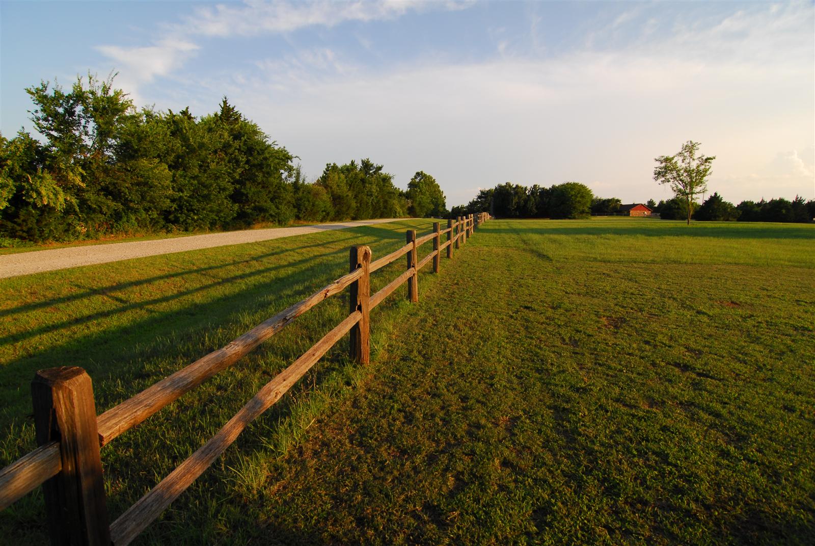

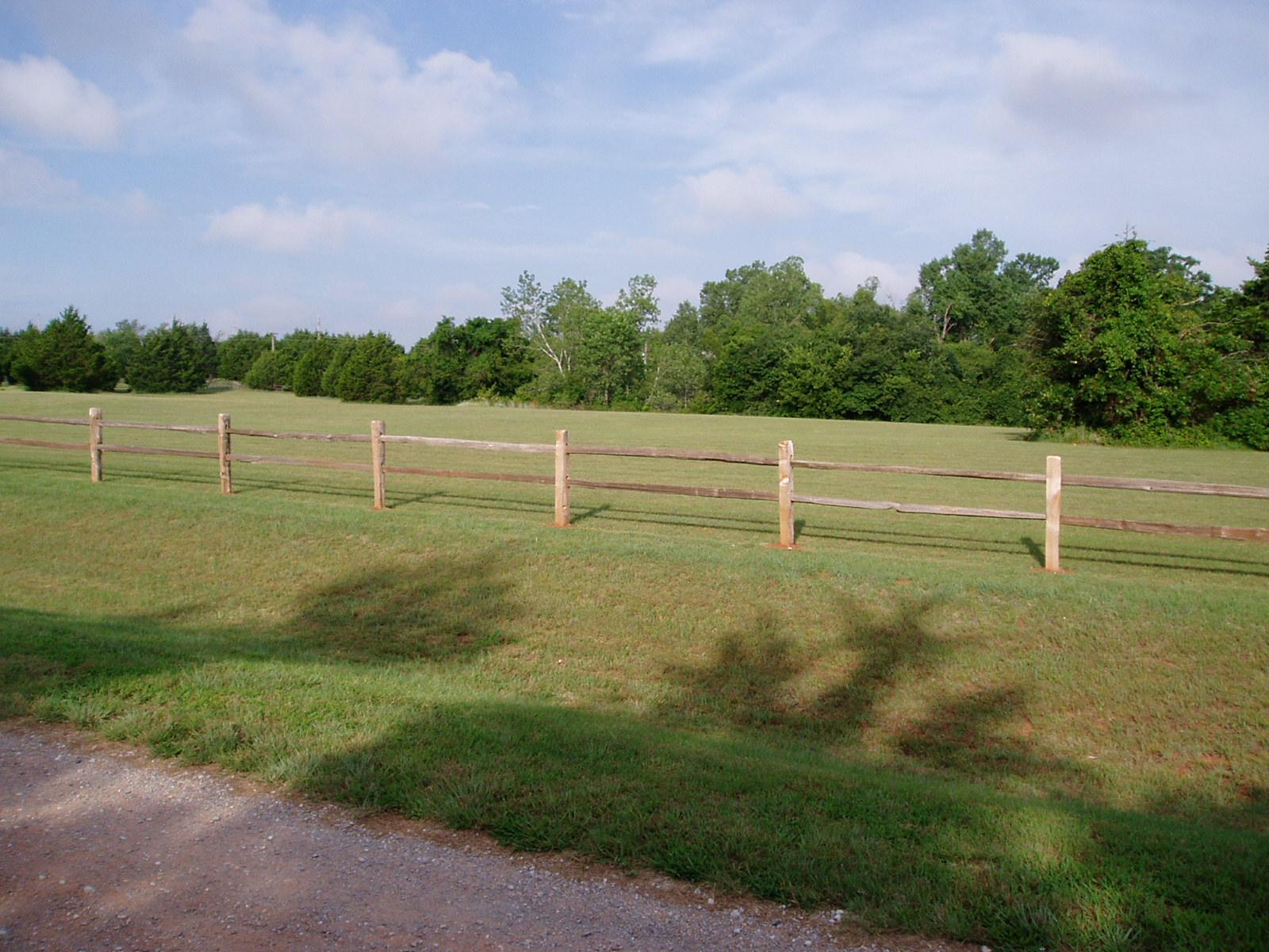

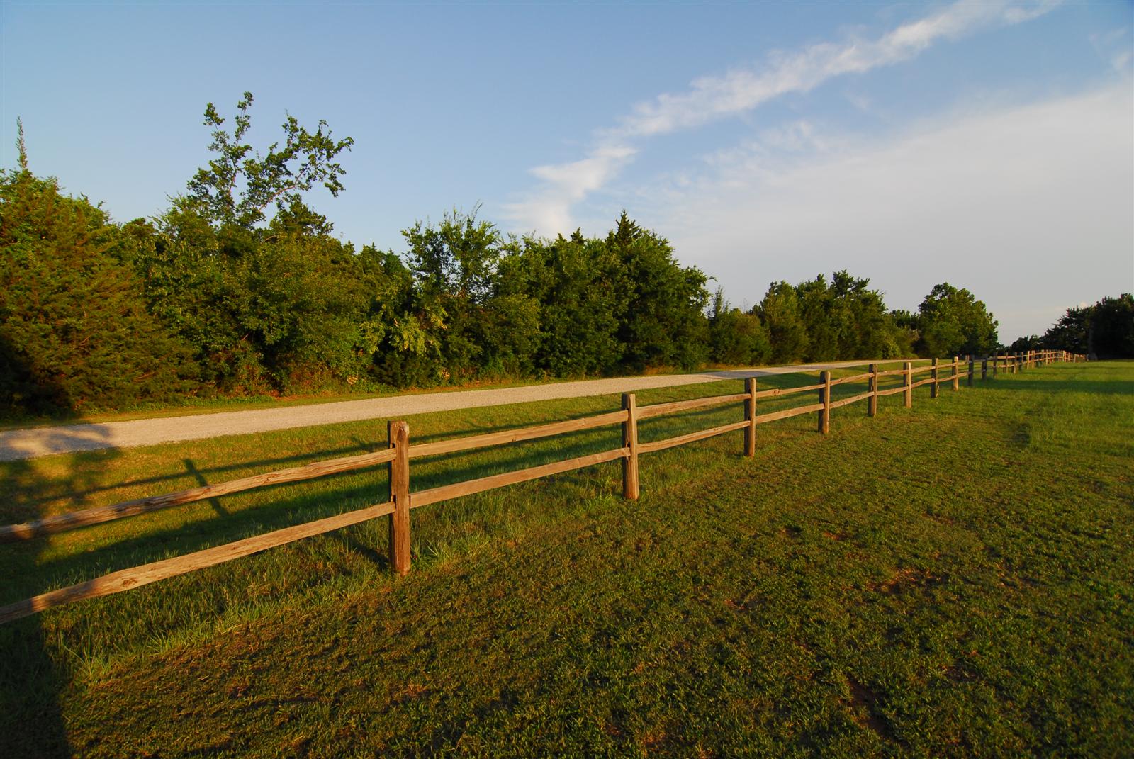

Here's about 450' of two-rail I put in a few years back. It replaced original similar fence but offset by 3' to one side of the old fence, used new posts but re-used all the 30 year old rails by cutting 6" off each end of the original 10' rails and spacing at 9' instead. 3' deep holes not really needed for this type fence, this is not livestock fencing, just red cedar "landscape" fence. 24-28" with a bit of gravel in the bottom for drainage and leveling post tops is plenty deep if posts are well tamped. All hand dug, post/rails fitted one hole at a time, no tractor needed. In fact, I think a tractor & PTO digger would just have been in the way and more trouble than it would be worth. This is nice pleasant summer upper-body exercise. Not that hard to do, I was 63 when I put this in. Forget concrete and deep holes, around here natural cedar posts will eventually rot out at ground level no matter how you set them, just plan on replacing the posts every 15 years or so. Or use that phony-looking white plastic fake stuff you see everywhere. :laughing:

I was not planning on doing the cutting, but buying the posts w/ the slots in them. Commonly available for $9 a post or so.
Well I learnt something today :cool: as I did not know you could buy fencing like that, with the notching already done. Guess the only tricky part from looking at the pics from picker77 is you have to make darn sure of the post placement. :)
Good observation Mousefield. And it is the reason for putting the next post hole in one at a time if a tight connection of the rails is desired.
picker77's fence shows he put in a lot of care and planning along with the hard work. Very neat and tidy fence to add to the attractive landscape. Makes for a warm feeling for everyone driving down that lane/road. :)

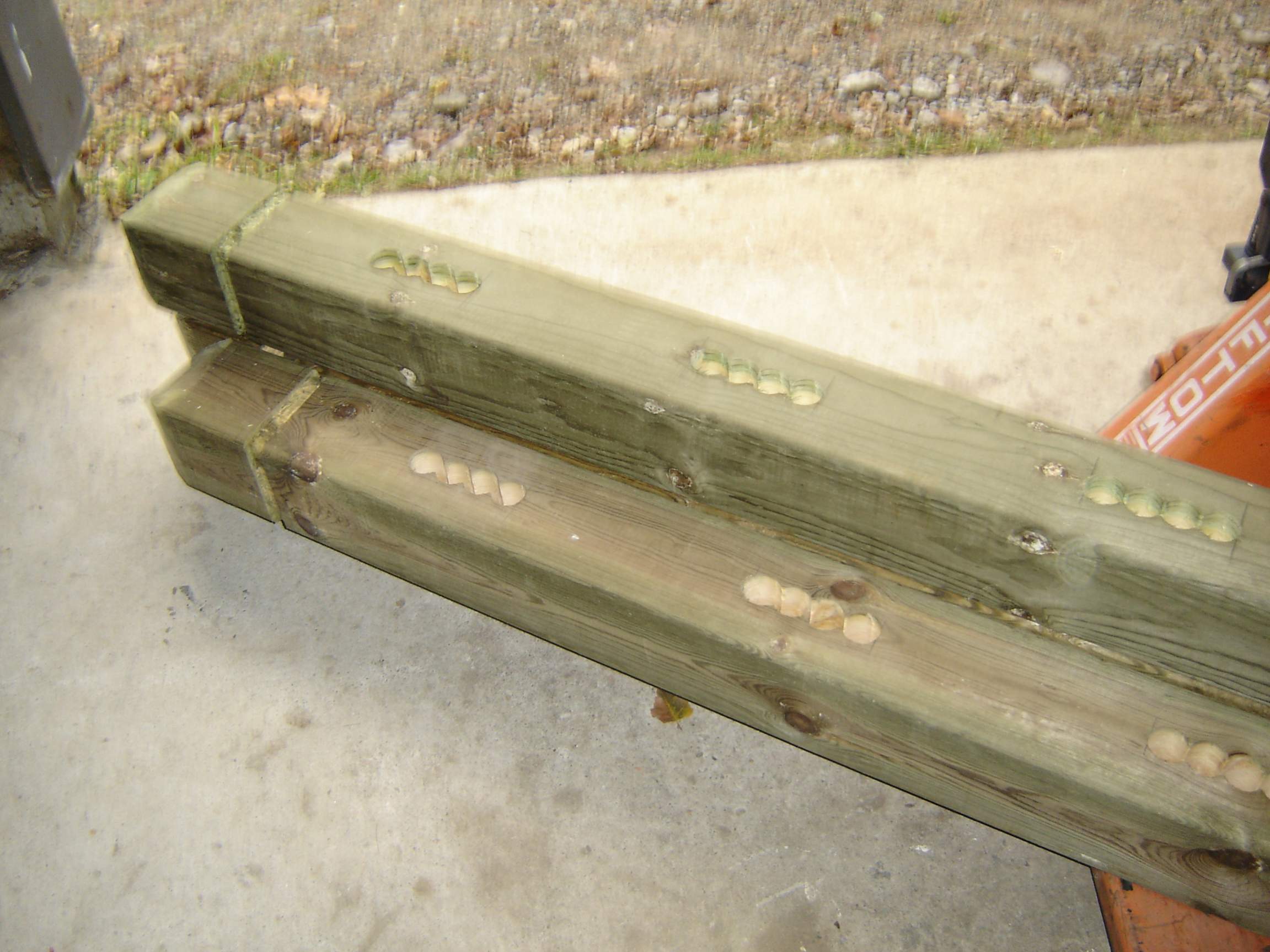

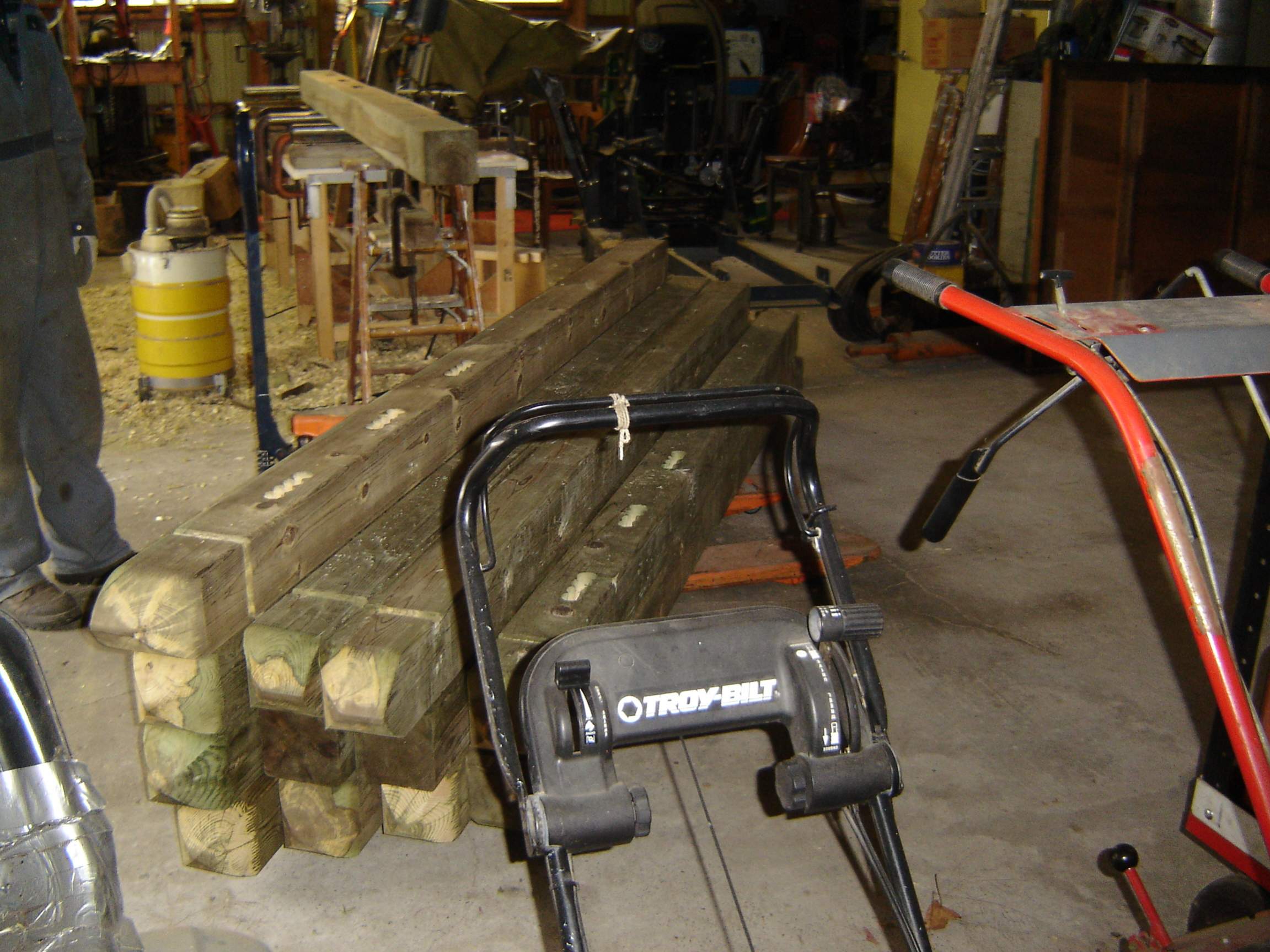

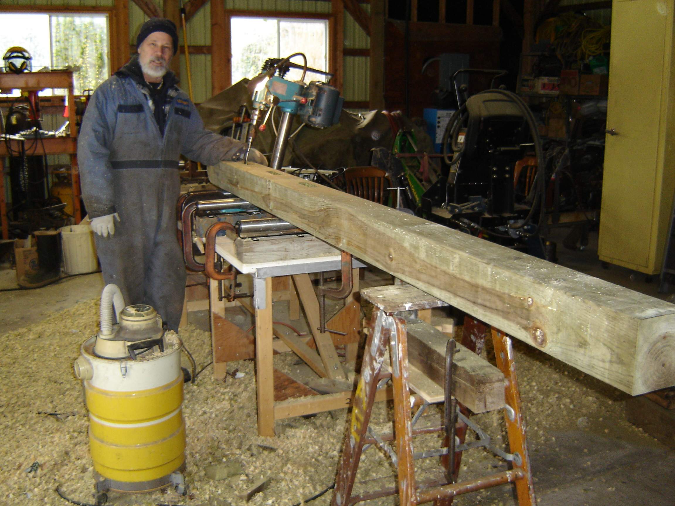

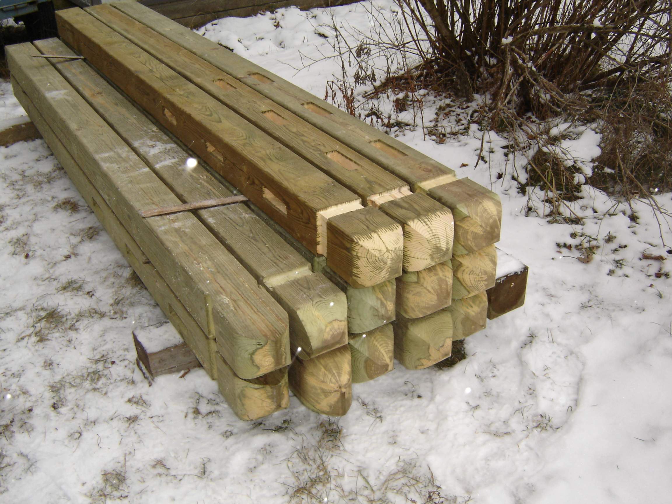

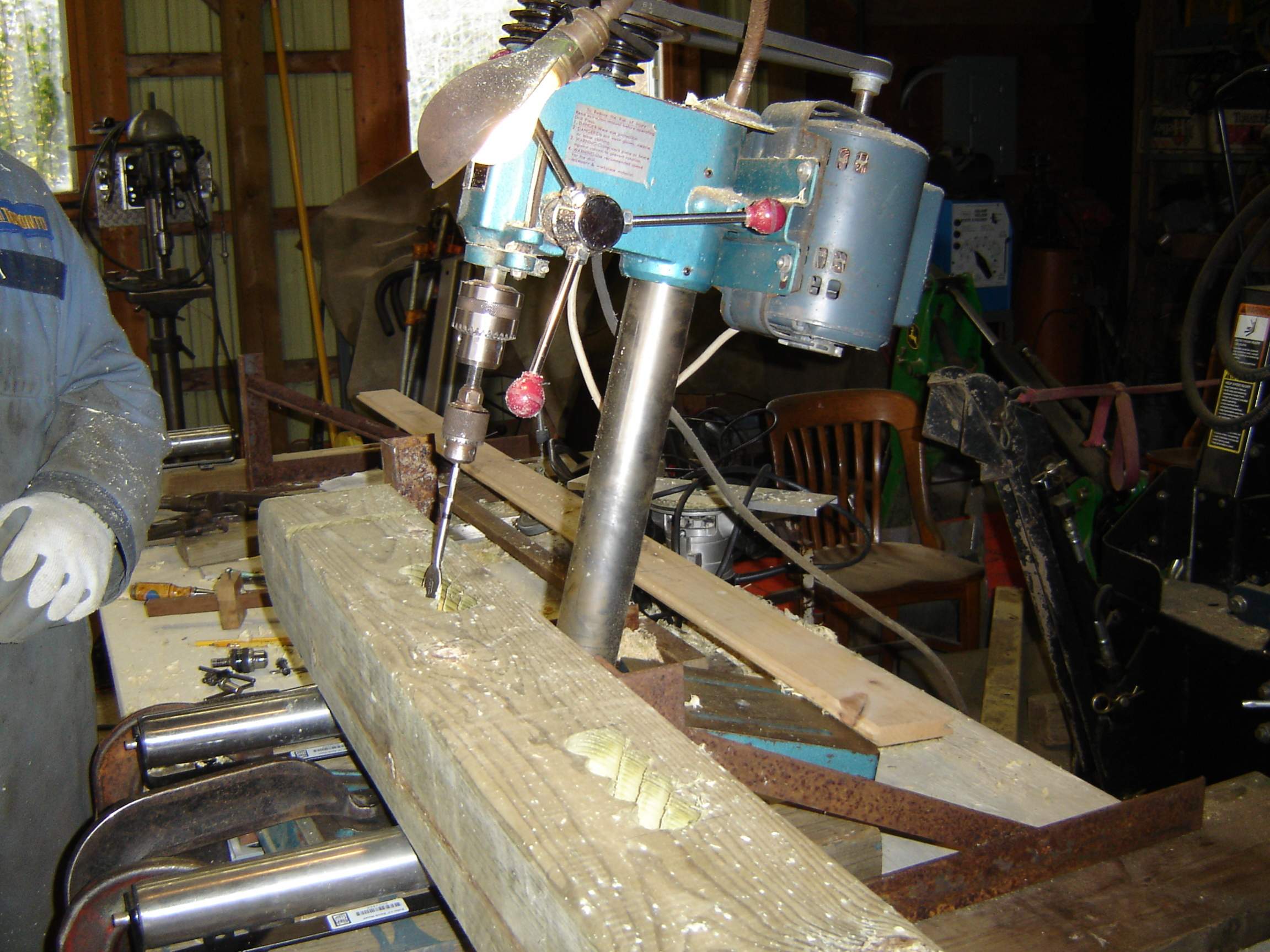

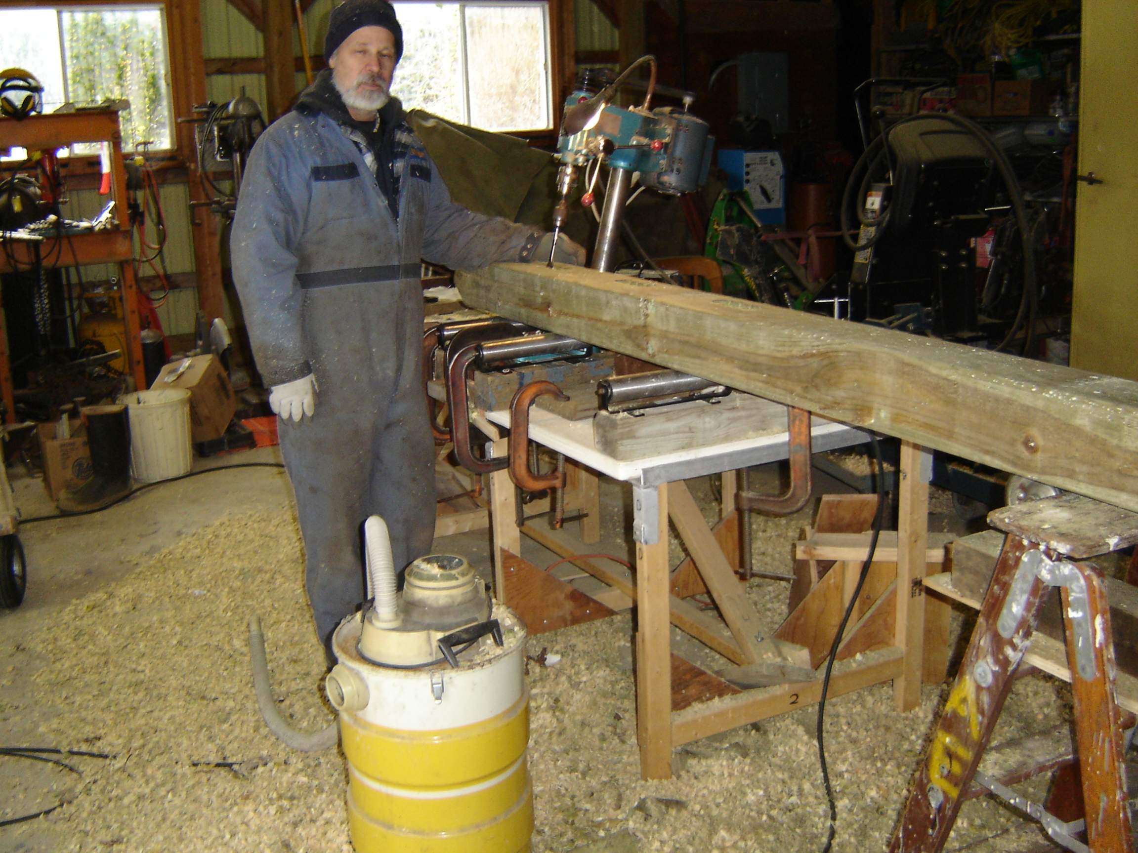

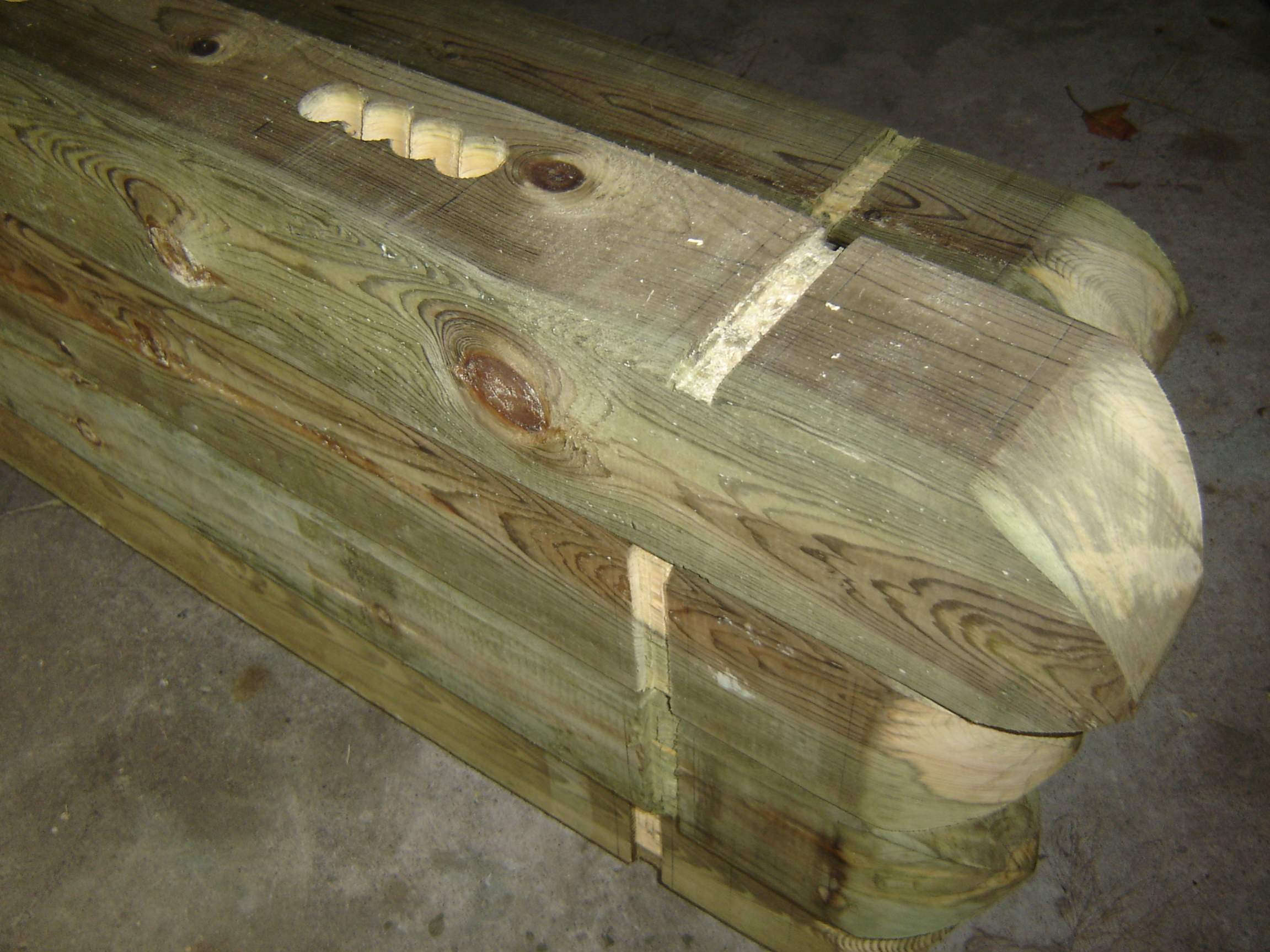

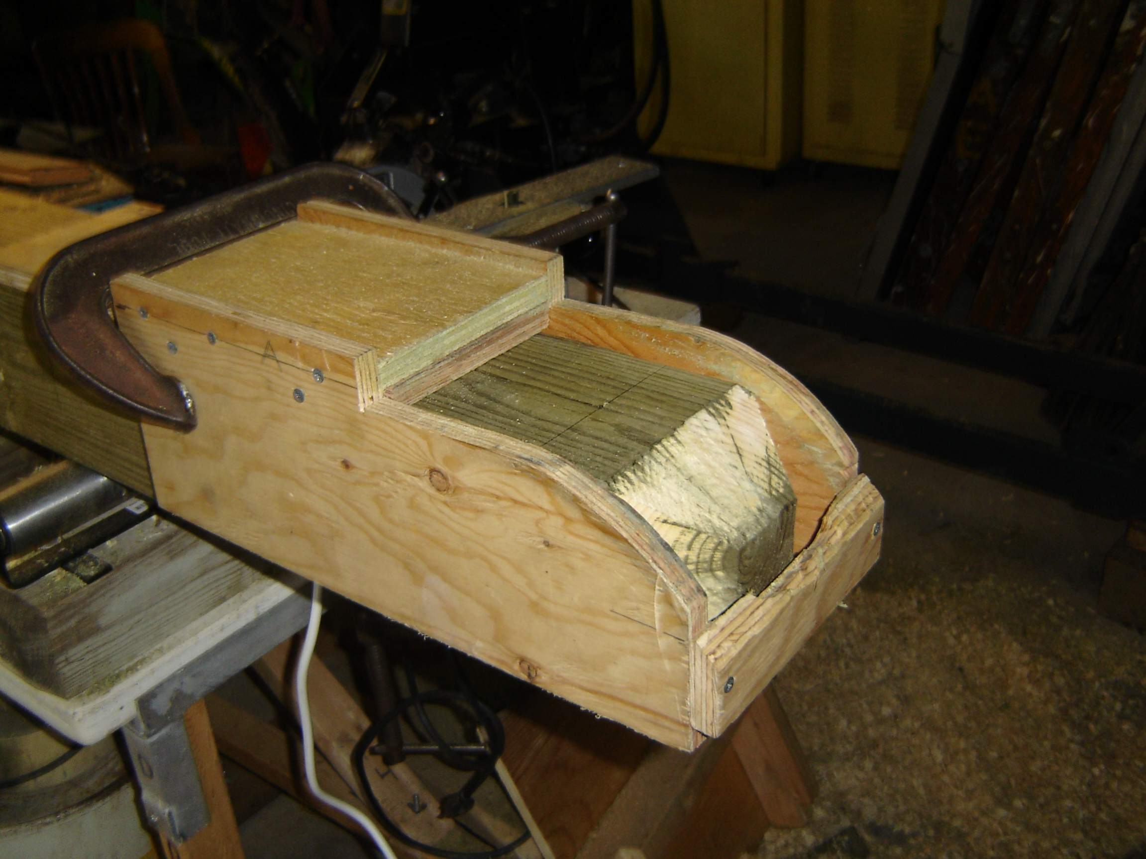

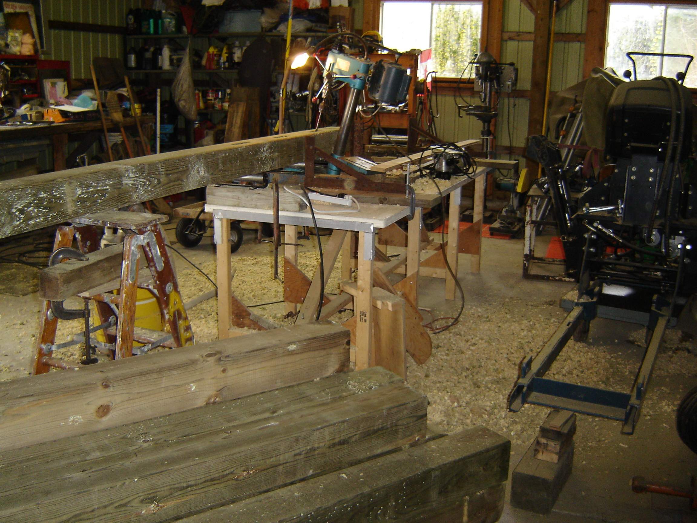

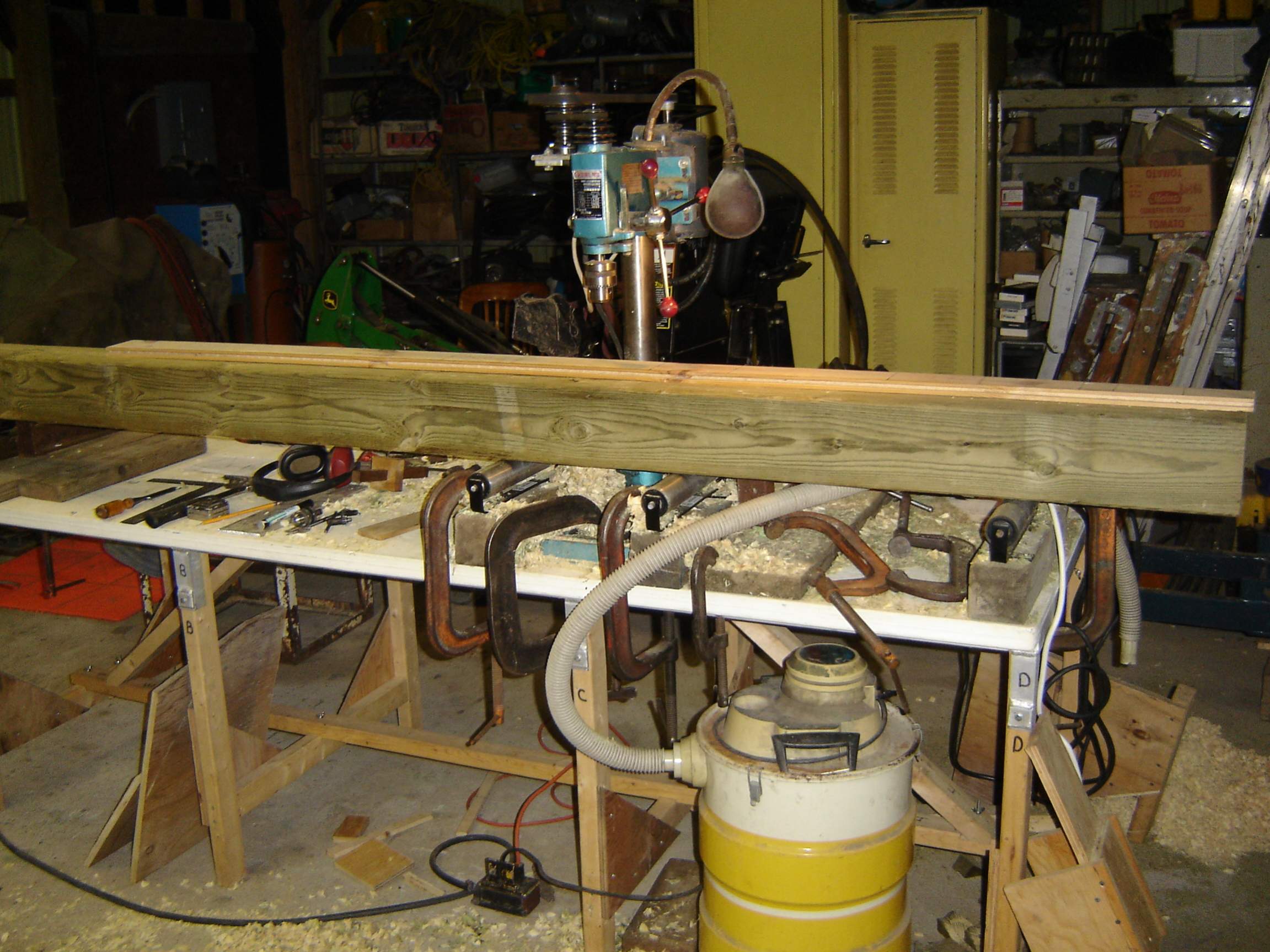

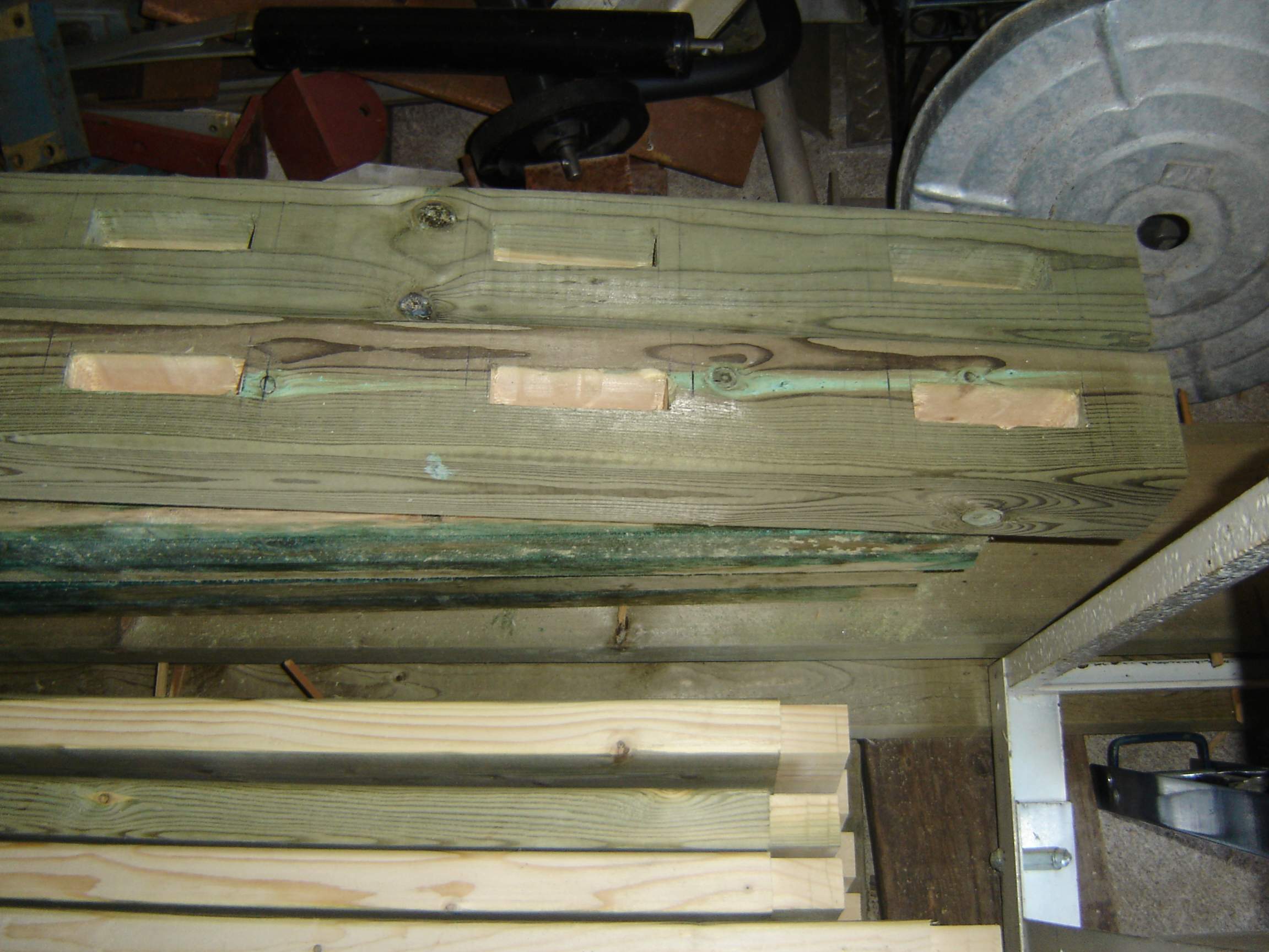

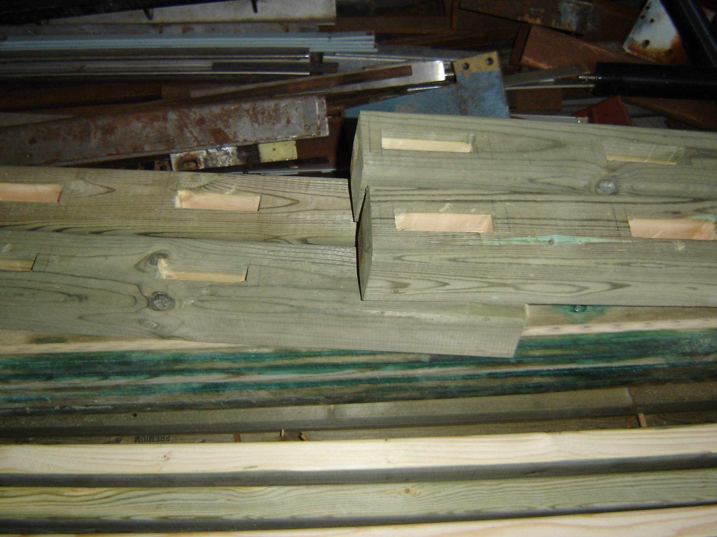

I am presently in the middle of building a 3 rail entrance at the front of the property. I have completed drilling out all 14 6"x6" PT timbers x 10' .Yes they are long but only 4' 8" are going in the ground and the rest has a fancy top. I have pics of the posts but they still in the camera. So I borrowed a pic of what the gate is going to look like. The first side rails are rough drilled out and laying on the bench. i fabed up rollers and used a 1 1/2 " spade bit to drill through using a bench top drill press. As the slots are on angles it was not a 90 degree job. The job went slow but the results are great. Before the ground froze up I cut and chipper ( 4 ) 30 ' trees and used the BH to remove 2 of the stumps.

The pic is of an English Estate Hook style wooden gate.
