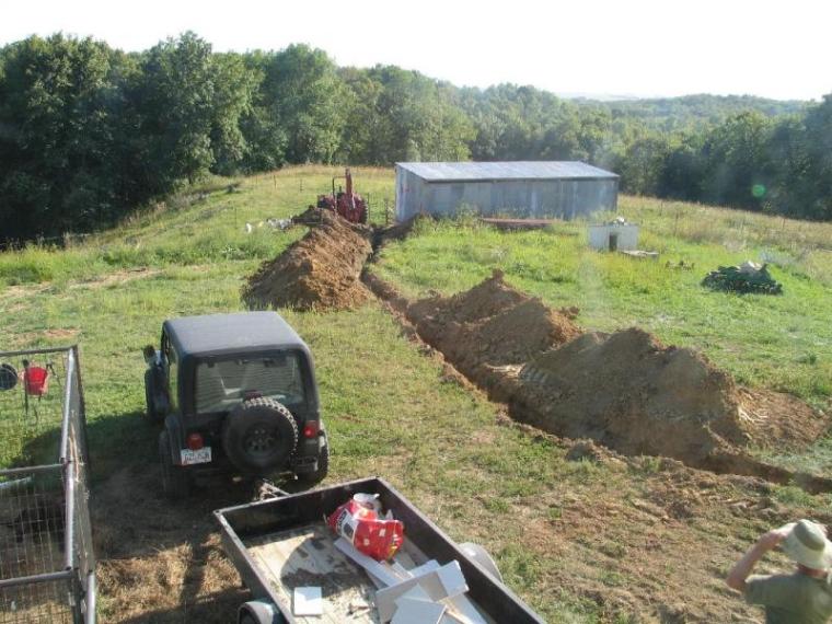

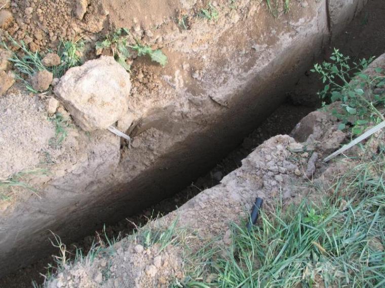

Okay, so back to the hydrants. I had to fix a cave in and correct some high points in the trench. Here is some of the remaining trench digging.

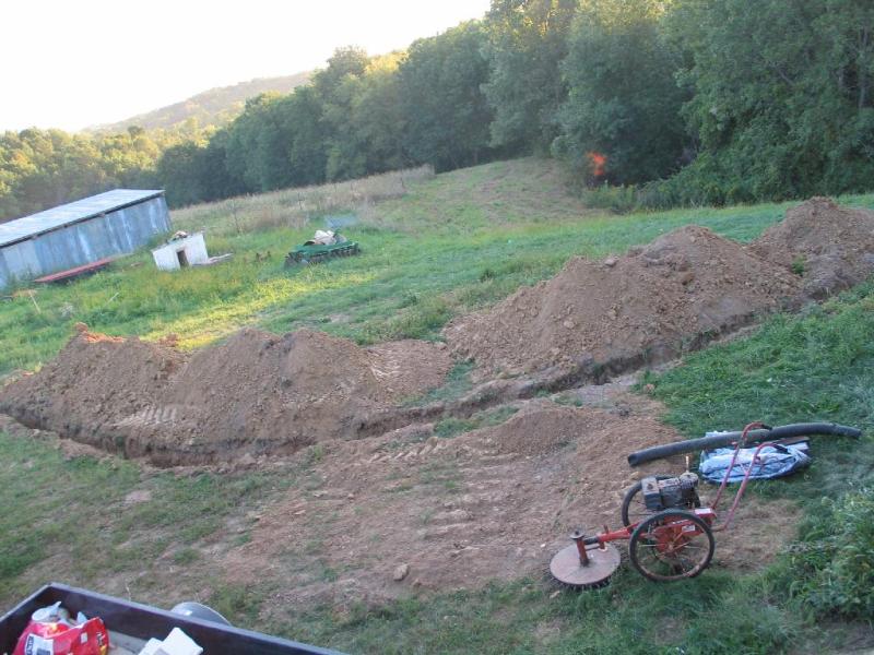

And here is the final stretch. I had to make all the corners so I would miss the septic and other obstacles.

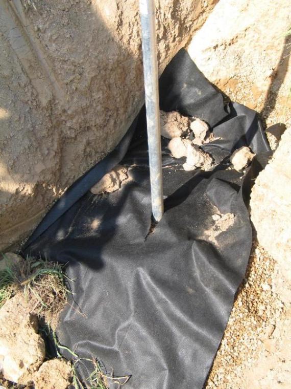

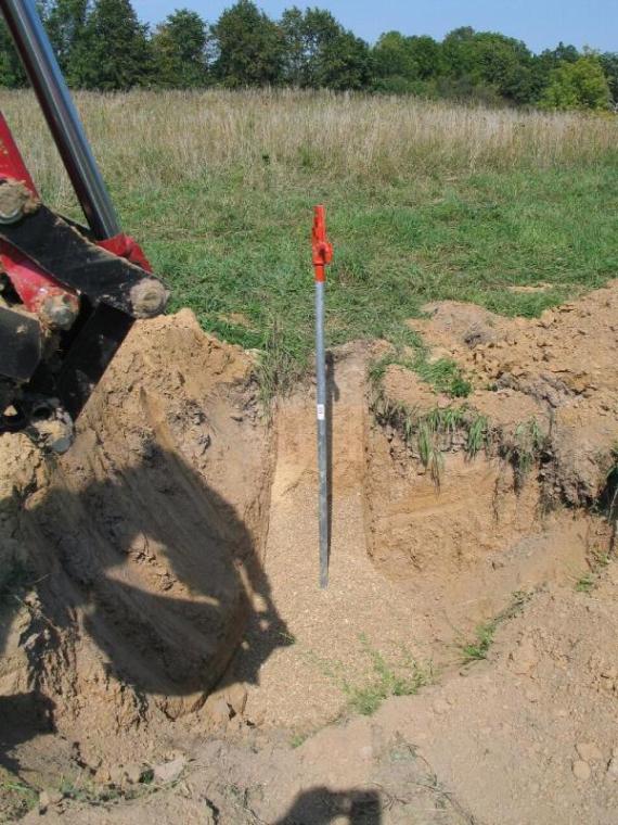

After I finished the digging I began the install for the hydrants. Here is the north hydrant shortly after it was set.
You can see the pea gravel at the bottom if you look closely.
   / Putting Water Hydrants In
#40
Here it is with the garden mesh to keep the silt out.
