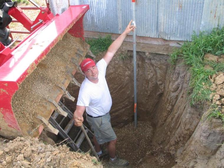

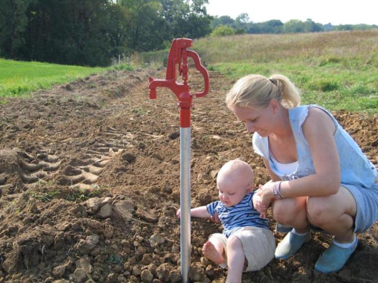

#42
And Sully and I standing by the finished northern hydrant.

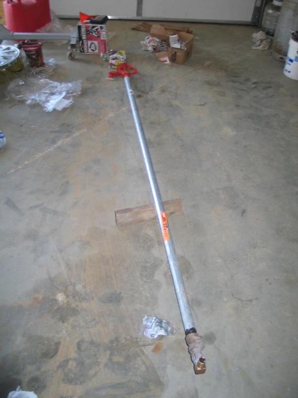

#43
Just to give you an idea of how long these puppies are. Here is the South hydrant before installation.

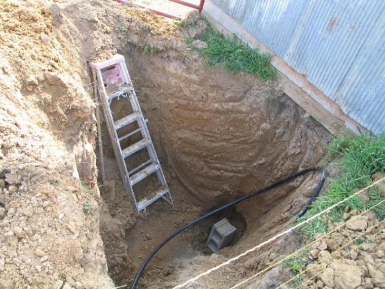

#44
Here is a shot of the pit for the South hydrant. You can see a concrete block in the bottom. This serves as a seat for the hydrant to alleviate stress from down pressures caused when the water is releasted from the valve.
That's a 6 ft ladder for reference.

   / Putting Water Hydrants In
#45
here I am making final adjustments and backfilling with pea gravel.

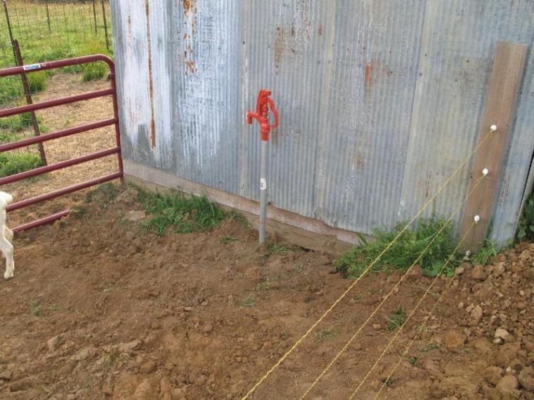

#46
And finally the finished South hydrant. I still have to do some work to connect the lines to the main water source later. I am having some other excavation done near the water entrance to the house to repair my geothermal leak, and I will connect them at that time. That'll be in 2-3 weeks so I'll post the updates then. Thanks for watching!
