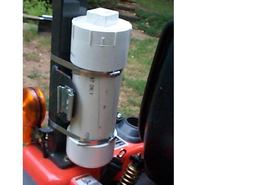

Here is my attempt at a toolbox for the BX. It is not ideal but is cheap and simple. I am cutting it a bit smaller and gonna paint it Kubota Orange. It is a 4" piece of PVC with a cap and a screw off clean out. 2 band clamps and presto.

Not bad for a small little item carrier. Waterproof too!

Another view

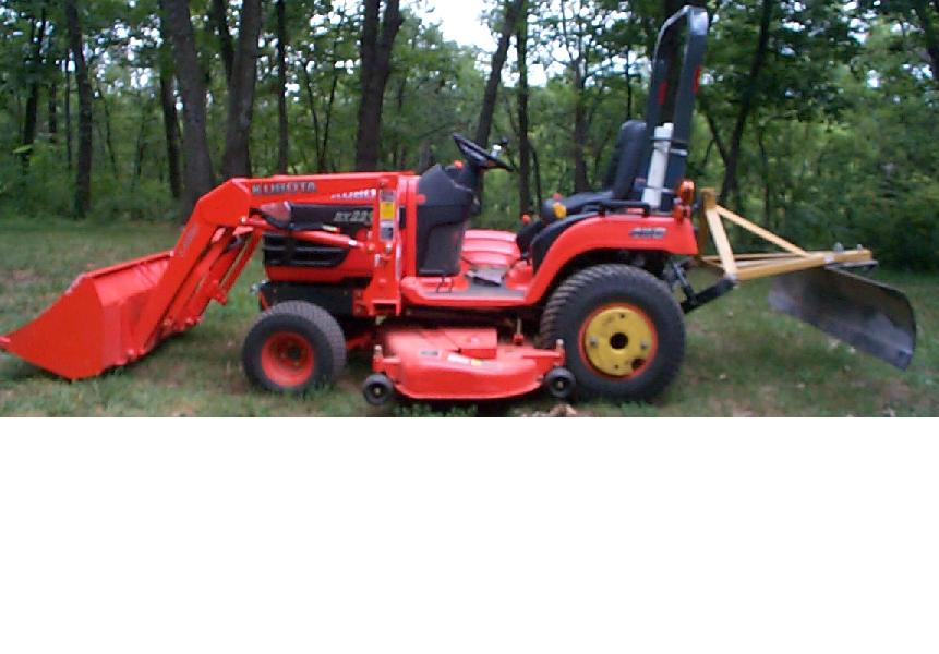

View of the tractor with the Toolbox.

Interesting idea. It would double as a very large drink holder too.

I like those, I put a couple on My Bx a couple of years ago. I ended up drilling a hole in the bottom of mine, Dont know how but i kept getting water in them. I keep a chain in one and a few tools in the other one. Made the one for the chain a little shorter. Got some kubota orange paint to paint mine but havent gotten around to it yet. /forums/images/graemlins/blush.gif Only had the paint a year /forums/images/graemlins/grin.gif
