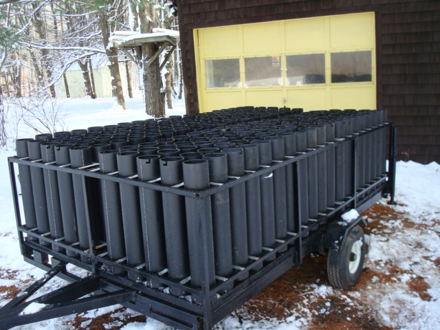

PVC is the wrong pipe to use if you are looking for shatter resistance. My other hobby is big fireworks displays. We use HDPE (High density polyethylene) pipe for our motars because they will never shatter if a shell blows up in a mortar. PVC shrapnel will kill you if you use it for fireworks mortars. HDPE pipe is the stuff that municipal gas and water lines are made of. You can get it at industrial plumbing supply houses in almost any diameter. You can slot it very easy on a table saw. It would be great on a plow because it is incredibly wear resistant. The attached pic is a trailer I just finsihed with 190 4" HDPE mortars.
