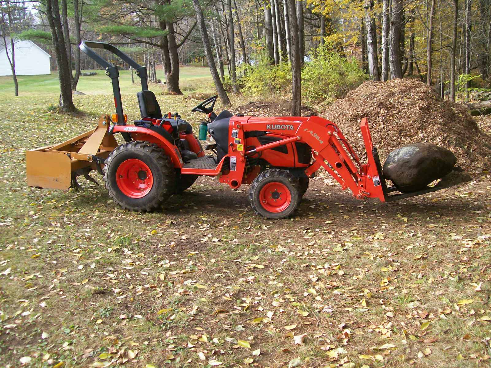

I went from a b2620 to the b3200 and I did notice a little reduction in roll back force but the the advantage of the qa made it worth it. There is plenty of force to bend the flimsy bucket. It puts it out ahead at least 4". It also raises the bucket about another 2-3" so you have more reach ahead and up.

Here are a couple of pictures of the QA installed. With the forks you can get odd shaped, and longer loads closer to the pivot points than you can with a bucket, so in that case you can actually lift more.

I dug out some printouts of specs from when I was researching tractors because I was curious about this myself.
On that 504 loader the breakout force is 2474 at the pivot pin and 1737 about 20 inches forward of that. That is a 737 pound loss at probably the front of the bucket. So at 737 divided by 20 you lose about 37 pounds of force per inch moving forward. The QA moves the pivot point out about 4 inches so 4 X 37 is 148. So theoretically (at least according to my crude calculations) you would lose about 148 pounds of breakout force. Sound about right? I'm not an engineer so there may be other considerations.
