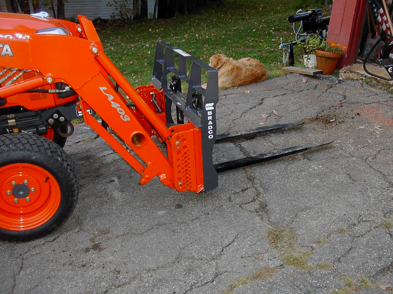

Yep.... i do believe the list price is likely closer to seven hundred, but the tractor dealers at the county fairs usually have special prices on stuff they bring to put on display. I wouldn't think they lost any money on them when they sold them to me since i could have bought the same forks from two different dealers at the fair.
Or watch CraigsList or FleaBay...... i've seen some used forks sell for short money.

Ductape,
Can you tell me if these are the forks you have from Bradco? Unfortuantely their web site does not list capacity any more. I recall that they had 1200lb capacity which I would consider too light for future needs.

Ductape,
They sure look similar, but i don't think they are the same? My spill guard goes straight across the top, and is square at the corners, where the corners are angled on those forks. Mine have 42" tines, and it looks like the model number for my forks is 108308. I know i said earlier they were rated @ 2200, but my manual says 2300#......so i now stand corrected. I recall the salesman mentioning list price on them was a tad over 7 beans.
