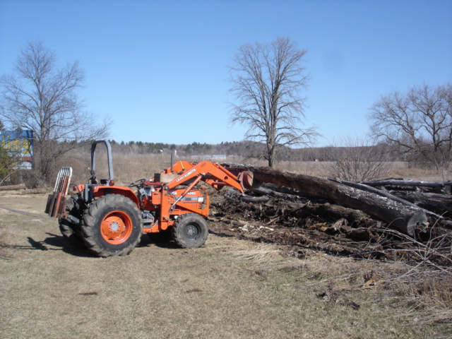

I'm with you on this. I have a couple of loader attachments and no SSQA for the loader. What I do have is Loader Buddy on my loader and find I can accomplish almost all of my work with it. I do have a grapple but seldom use it. I built a set of three point forks for my tractor which pretty much stays on all the time and has a clip on back blade that fits when the forks are off. The design shortens up the footprint of the tractor, handy in the woods, while still giving back blade versatility. I also put down pressure on it which allows establishing grade. You can see the forks in the pic and also see the original prototype of Loader Buddy lifting a log. more loader buddy pics
Can you explain the "clip on" blade, or do you have a picture?
   / QA or bucket attached - that is the question? #28
I do not have a pic as the blade is snowed in and I have the winter set-up on the tractor. I will try to explain. When you take the forks off you are left with the 1/2" plate and rails, (back plate). I took an old back blade, welded some angle iron on for stiffening and created a cradle for the back plate and welded side keepers on. I welded a piece of angle iron on the back side of the blade, up high so when I extend my top cylinder out the back plate contacts it. Now I am contacting the back blade up high and down low. I configured a set of brackets on either side of the back plate, tractor side so not to interfere with the forks when they were on. A corresponding set of brackets on the blade and now the blade clips on with two pins, I used 3/4" ones. I welded a couple of pipes to act as holders for the pins on the back of the back plate when the blade was not in use. It is amazingly solid and very easy to put on, the shorter footprint of the tractor is VERY desireable and you still have the extra weight in back. I will get some pics when I can.
Oh, OK. So it is something you created, yourself. I though it was something you had bought.
