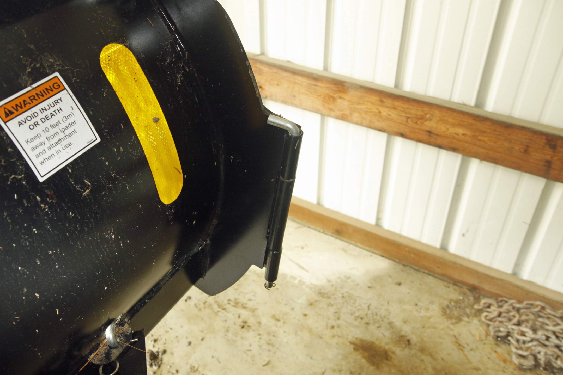

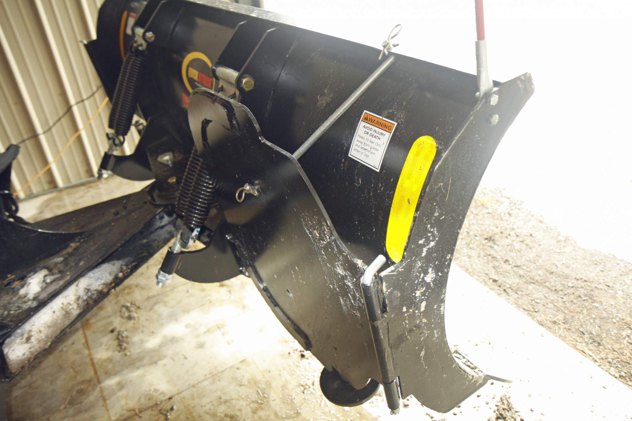

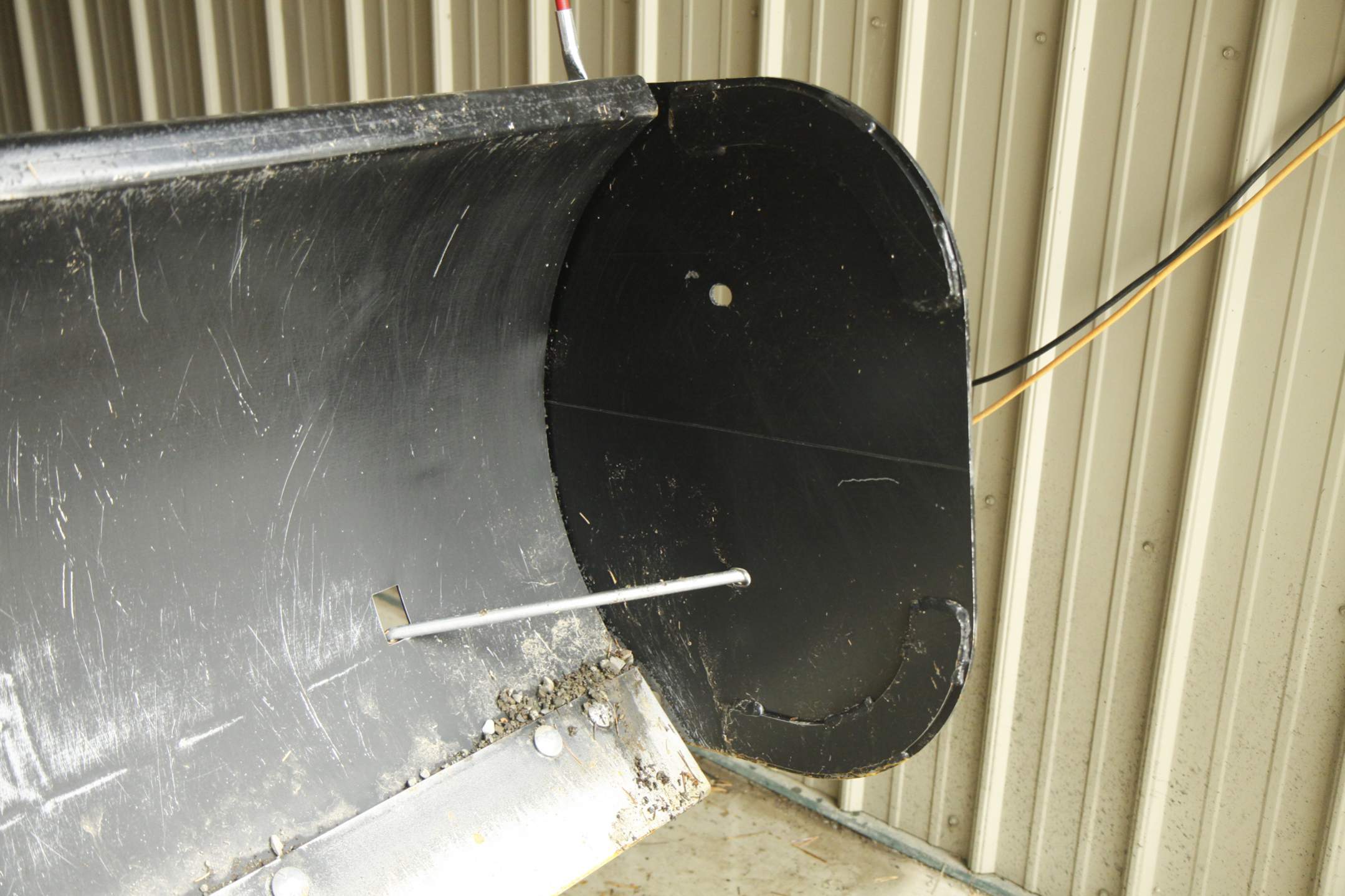

i purchased a Quickattach brand 84" blade last year, and used it last winter. worked GREAT. It ran about $3,000 with right and left side wing kits. This side wing swings into place to make the blade a snow push, or to prevent snow from sneaking around the upper edge while pushing while the blade was angled.

i plow whenever there is at least 8" of snow on the ground. I noticed the side pushing whenever i set the plow to full side angle...which i need to move snow.
After i installef front and rear chains...no more side movement
The side gates simply swing and lock in place..about 10 seconds.
