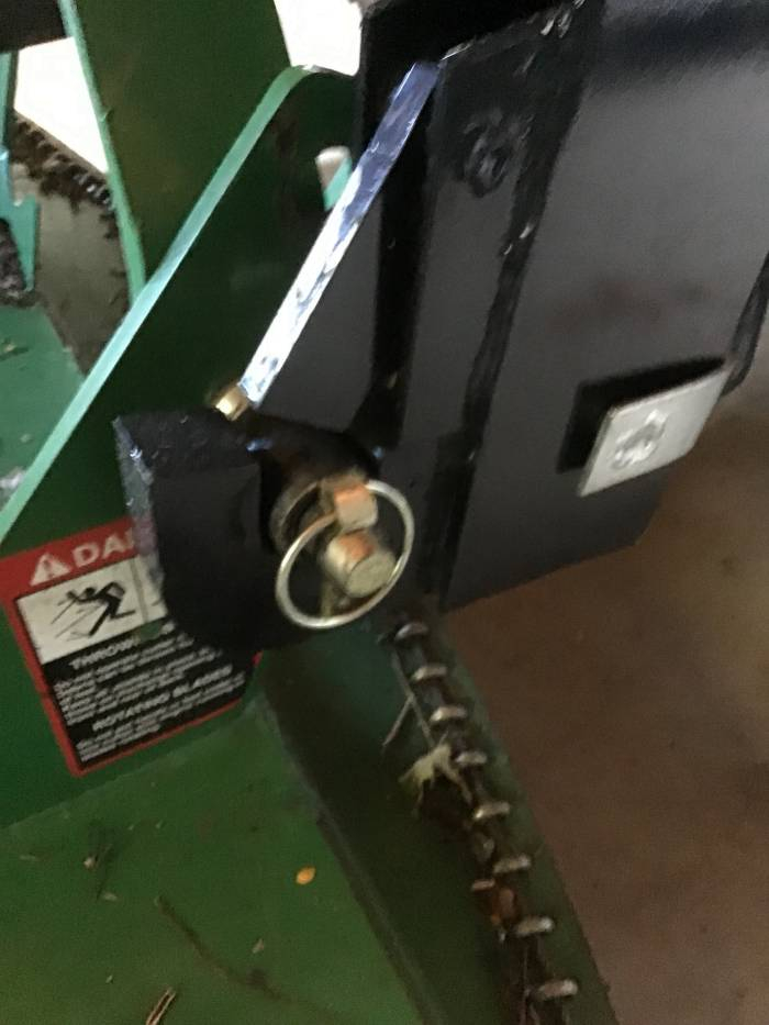

The hook on the HF QH has been problematic. In putting my bush hog back on after getting the tractor back from the shop, I could not get the 2nd pin in to secure the top hook.

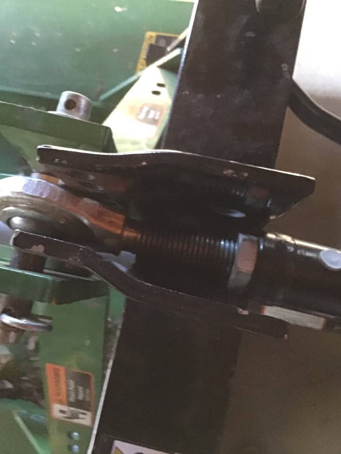

Looked at it and came up with this solution today: Removed the hook and then removed top pin from QH and extended top link through the QH "hook" area and attached it directly to the bush hog's top pin.
Here's the top link shown in the first attachment.
The nut to keep the top link from rotating cannot be secured with a wrench. I should have moved it to the other end (might not work, as thread is reverse). The second picture shows the nut.

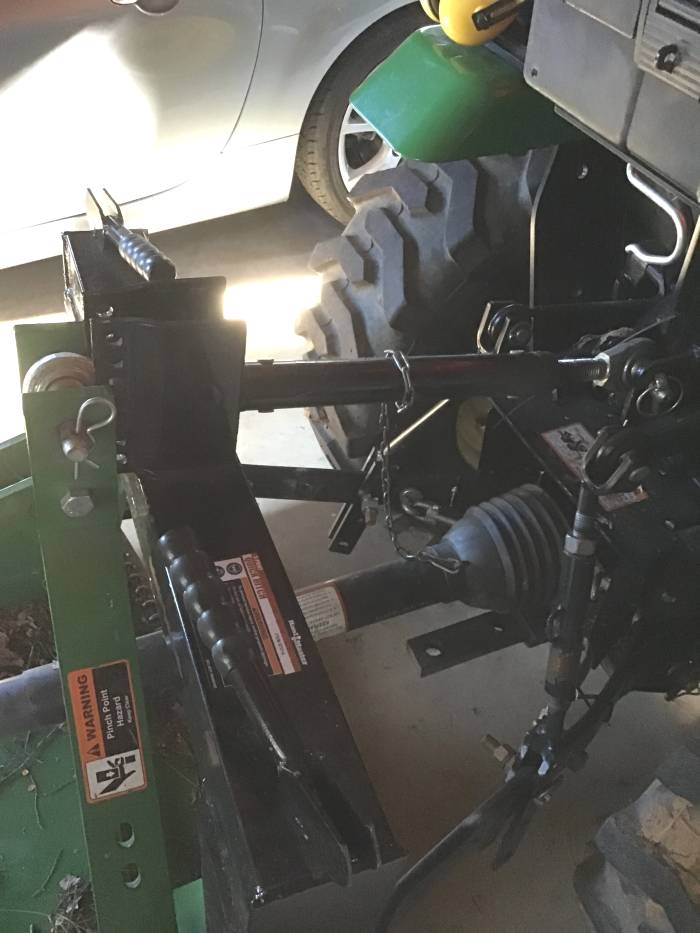

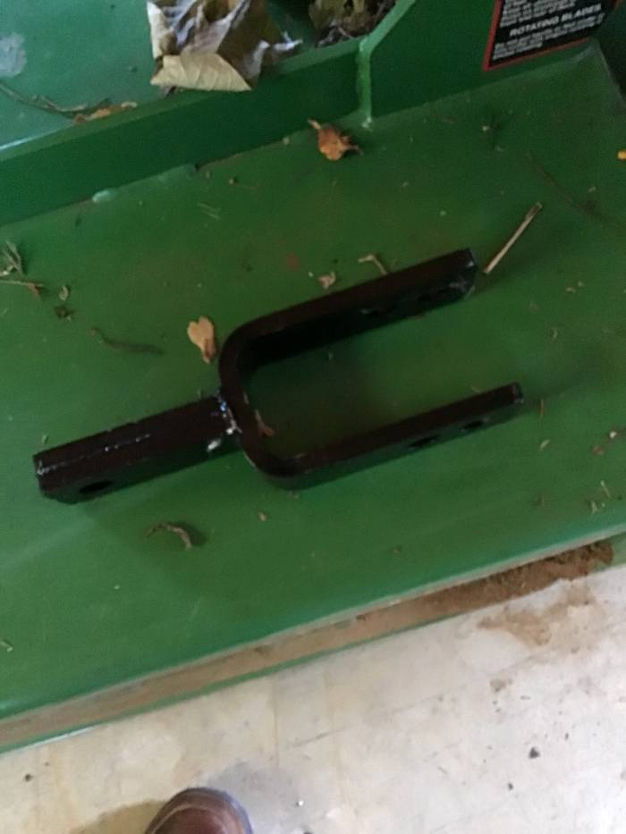

I could have gotten a shorter one of the adaptors that MIGHT work on the bush hog. A shorter one is available at Agri Supply. The 4th attachment shows my fairly long adaptor. This adaptor I have is too long because the top link I have will not shorten any more, and I could not find a shorter one without going to cat 0.
What you COULD do is to buy a piece of chain and a couple clevises to attach the ends to the implement top pin and the top pin attachment at the tractor. Just use a chain about 1 inch longer than needed. It will lift the implement but allow it (like the bush hog) to move a bit more over terrain. One would use the adaptor then between the QH and the implement.

So you can't use the hook from your HF quick-hitch after your tractor was at the shop? What did they fix (the hook or the tractor) and what is the issue now? I can't see how the hook would have changed pre or post taking the tractor to the shop. I've had my lower arms not centered before so the hook didn't make contact in the correct area, but it was fixed by adjusting the lower arms. I've had issues with the hook not working if the top link made the QH at some extreme angle as well.

Had to remove the bush hog because they had another tractor on the trailer at pickup time.
Could not get both hook pins back in. Too little clearance between bush hog and top part of QH.
Could not get bush hog to go back on with hook in place. Had to remove and then put hook back.
The new way is better. No hook. Couldn't use it on my back blade either. Used the adaptor.

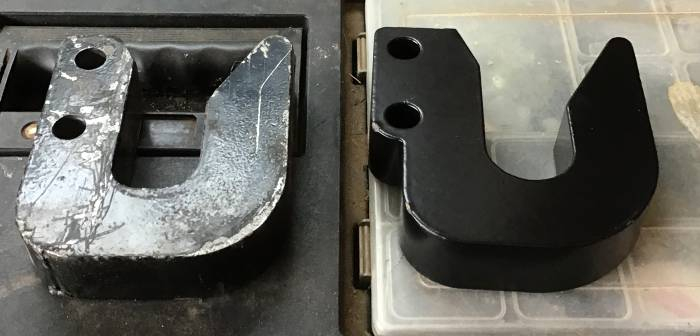

I found a Youtube video about HF QH fixes. A guy said he found another top hook that fixes the problem with bush hogs. Didn't say where he found it. Found it on Amazon for about $46. Ordered it.
Will do a pic when I get it and swapped out.

At least 2 youtube videos have highlighted this problem. Only on bush hogs. The HF QH hook just has the "hook" too close to the securement pins/bolts. The implement (bush hog) just bumps the pins/bolts and will not engaged. I don't know why HF does not change their hook to what you can get on Amazon.
Others have but out a 1/2 inch on the inside of the hook on the implement side and welded it back onto the tractor side of the hook. Machine work to have this done for me is probably close to the $50 for the other hook.

Got the new top hook from Amazon. It is the one on the right in the picture. Have put it on.
Don't know why HF keeps making them with the top hook on the left. The bolts or pins holding it to the QH interfere with bush hog vertical piece such that they keep the top hook from engaging.
Here's a video showing the problem:
