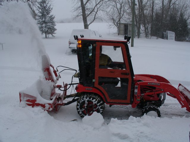

Here is my set-up, a BX2350 FEL and 54" Couture snow blower.
Every things works just fine especially with a warm cab.
