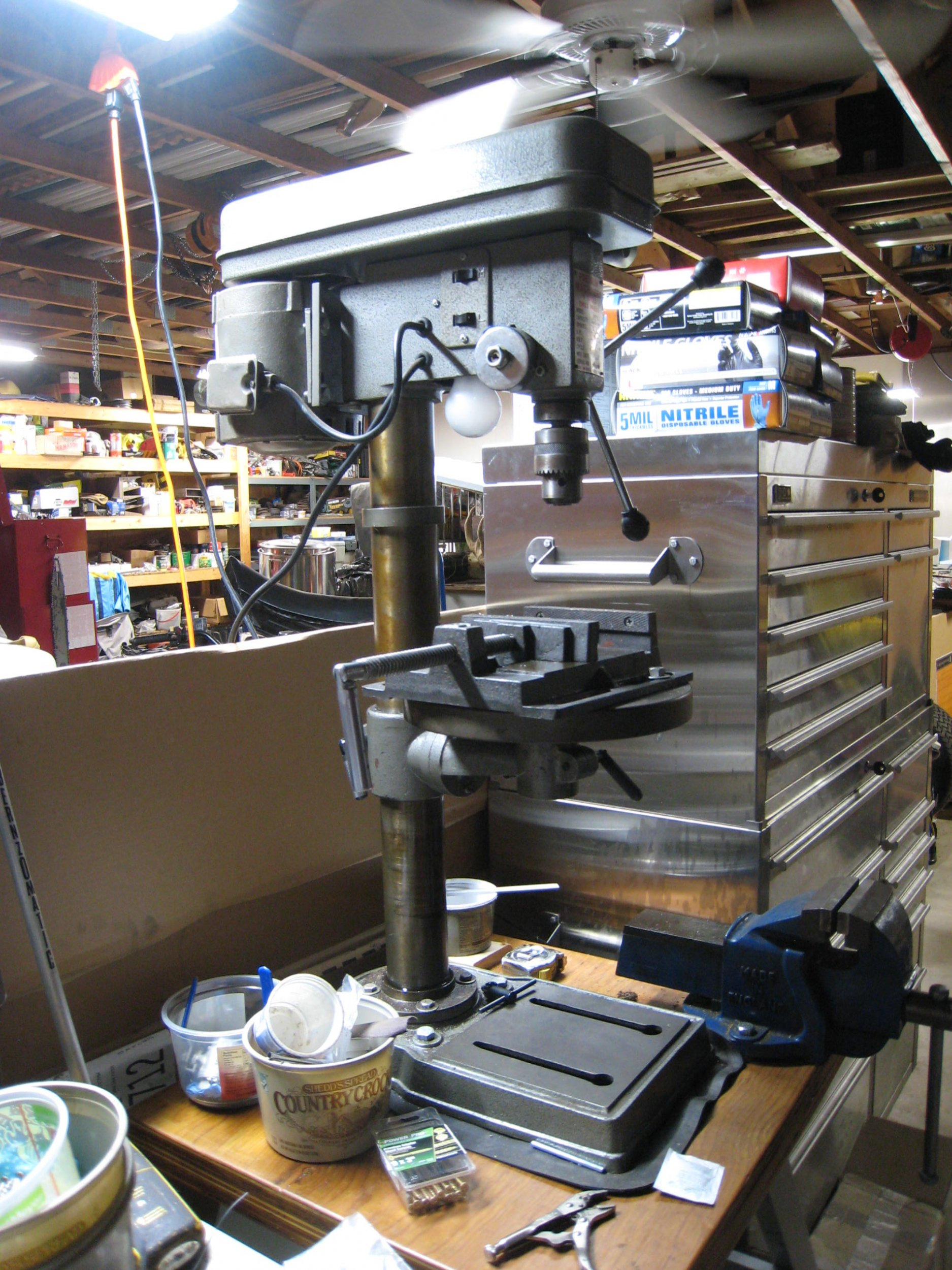

I bought this $150 Taiwanese drill press over 30 years ago and it has worked alright, I just wish it had a variable speed drive.
