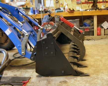

We also made sure that the grapple closed with sufficient force that it will be able to hold anything that we use it to pick up.
We still have additional gussets to add, finish welding, hydraulic hoses to add, and finish painting.
While testing the grapple I'm thinking that it may be necessary to add restrictors as the cylinder moves pretty quickly on the TC-40D. I think we'll actually put it to use and test it in the field before we decide one way or the other for sure.
The cylinder is removed easily by pulling two pins. The main part of the grapple is then easily removed by pulling 3 additional pins and can easily be set aside to use the bucket without the grapple in place. I'm guessing the main part of the grapple to weigh about 80 to 90 pounds.

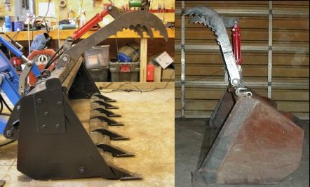

In all fairness I would also like to add that had I purchased Andy Tatro's grapple as it is sold at eBay it would have opened much wider than mine. He has been a great source of information on this project as well as a big help in using his CNC plasma to cut out the majority of our parts. As a matter of personal choice I wanted a grapple that was at least 36" wide and even originally shot for 48".I had a lot of input from Andy and he suggested to keep the grapple strong that I limit the width to 36" which we did.
The fact that we decided to use 2 X 3 tube positioned down on the top of the bucket and tilted backward to mate the bucket top for strength was a bit of a trade off on the wide open position. Frankly if I grabbed a downed tree with a diameter of the capacity of my jaw width I couldn't get it off the ground anyway so I'm happy with the end results.
I have posted a picture of Andy's 18" grapple next to our 36". Both in the full open position. Please judge for yourself on the differences.
BTW: If anyone needs any assistance with their own grapple project I suggest sending Andy a PM, TBN member htatro. /forums/images/graemlins/grin.gif He's has all the answers!

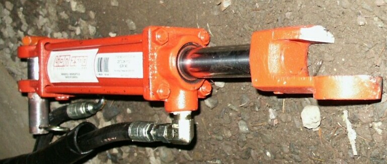

Been following this and other threads relating to Andy's grapple with interest...I had Andy send one of his standard eBay grapples to my dealer for installation on my new 3130.
However...the cylinder supplied doesn't meet my definition of "stout". The clevis ends are very cheap pot metal - I used mine for about 30 minutes, before one end snapped. I wasn't abusing the thing - just picking up a log, and had grabbed it with only one of the grapple arms. When I increased pressure on the ram, the clevis snapped - see attached picture.
In Andy's defense, he's handling this like one would expect from a first-rate dealer. He said he'd sold about 150 of these in the last year, and mine was the first to experience this breakage. Also, the cylinder is supplied elsewhere - the components made by Andy appear to be of top-notch quality. I just question the wisdom of including a relatively cheap cylinder, but perhaps mine is an isolated incident.
My local dealer could get me a beefier cylinder, with forged clevis ends, however it would be quite a bit more than the cylinders from Northern Tool supplied by Andy. For now, I'm swapping out the broken one for a like-kind replacement, and hoping I just got a lemon...
Attached is a photo of the piece that broke off...

...and a photo of the cylinder showing where it broke.
