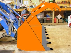

PR, Great job on the grapple attachment. Here's a little something that I think will make it work alot better.
Bill
   / Question about a grapple
#158
Wow Kubota orange on the front of a New Holland. Naw that won't work... /forums/images/graemlins/wink.gif
   / Question about a grapple #159
I believe that yellow and green would be a better combination with the blue..... /forums/images/graemlins/grin.gif /forums/images/graemlins/grin.gif He will probably paint it boring black.....
   / Question about a grapple #160
Junkman,
Not only will he paint it black, It'll have to be satin black /forums/images/graemlins/grin.gif. I thought satin was the sheen you put on your living room walls, not your tractor /forums/images/graemlins/wink.gif. Is black really a color /forums/images/graemlins/confused.gif. I think orange, yellow and green would be great!!!!!!!!!!!
Bill
