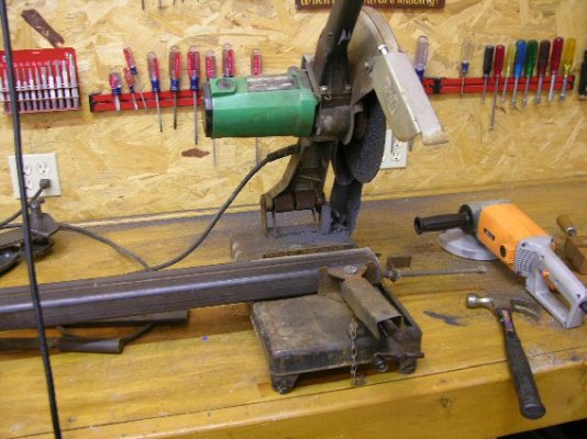

I think after looking at the cylinder mount from a new perspective that we are going to take the chop saw to it and do a slight modification. I'm headed over to Summit Equipment to pick up a couple of pieces of 3/8 inch stock.

Top mounts after taking a sawzall to them.
