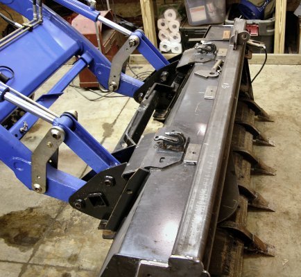

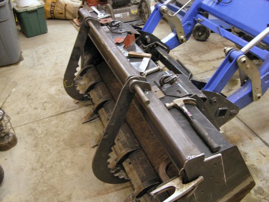

We also made sure that the grapple closed with sufficient force that it will be able to hold anything that we use it to pick up.
We still have additional gussets to add, finish welding, hydraulic hoses to add, and finish painting.
While testing the grapple I'm thinking that it may be necessary to add restrictors as the cylinder moves pretty quickly on the TC-40D. I think we'll actually put it to use and test it in the field before we decide one way or the other for sure.
The cylinder is removed easily by pulling two pins. The main part of the grapple is then easily removed by pulling 3 additional pins and can easily be set aside to use the bucket without the grapple in place. I'm guessing the main part of the grapple to weigh about 80 to 90 pounds.

<font color="blue"> Is that elbow in the hydraulic line shown in the closeup rated for several thousand PSI? (It looks like the garden variety cast elbows that often have porosity.)
</font>
John I'm sorry that I didn't respond to your question sooner. The extra long hydraulic hoses were borrowed from my neighbor so that I might test the grapple. I picked the 3/8 inch black pipe fittings up at the local hardware. You are correct they are not rated for hydraulic use.
I'll be ordering the correct hoses and fittings from Discount Hydraulic Hose now that we are satisfied with the performance.

Been following this and other threads relating to Andy's grapple with interest...I had Andy send one of his standard eBay grapples to my dealer for installation on my new 3130.
However...the cylinder supplied doesn't meet my definition of "stout". The clevis ends are very cheap pot metal - I used mine for about 30 minutes, before one end snapped. I wasn't abusing the thing - just picking up a log, and had grabbed it with only one of the grapple arms. When I increased pressure on the ram, the clevis snapped - see attached picture.
In Andy's defense, he's handling this like one would expect from a first-rate dealer. He said he'd sold about 150 of these in the last year, and mine was the first to experience this breakage. Also, the cylinder is supplied elsewhere - the components made by Andy appear to be of top-notch quality. I just question the wisdom of including a relatively cheap cylinder, but perhaps mine is an isolated incident.
My local dealer could get me a beefier cylinder, with forged clevis ends, however it would be quite a bit more than the cylinders from Northern Tool supplied by Andy. For now, I'm swapping out the broken one for a like-kind replacement, and hoping I just got a lemon...
Attached is a photo of the piece that broke off...
/ Question about a grapple #150
...and a photo of the cylinder showing where it broke.
/ Question about a grapple #151
I would have expected both ears to brake off, rather than one. Could it be that the pin started to come out and that the cylinder clevis was loaded on only one side? That is a strange type of break and I don't believe that the cylinder is an inferior product. Glad to hear that a replacement is on the way. Did you send him a picture of the broken piece? Junk....
/ Question about a grapple #152
Nope, pin and clip was still intact and in place through the grapple mount when it broke.
And yup...sent Andy pics, and as mentioned before, he's treating me right. He's standing behind his product, and is replacing the cylinder without hesitation.

Never heard anything bad said about Lion cylinders before. Quite possibly a fluke of sorts.
Here is the info that Northern supplies on the Lion cylinder:
Lion 2500 PSI Heavy-Duty Tie Rod Hydraulic Cylinder — 2in. Bore, 6in. Stroke
Built tough for agricultural and industrial applications. 2500 PSI model is designed to withstand shock loads of up to 5000 PSI. Durable ductile iron cast components. 90 durometer O-ring seals with antiextrusion rings for positive sealing throughout the cylinder. High tensile steel shaft is precision ground, polished and hard chrome-plated. 30-month limited warranty.
I'm thinking even if you didn't have a 30-month limited warranty on the cylinder that Andy would still help you out of a bad spot. He has worked diligently with me on my grapple project and I thank him for the assistance.

</font><font color="blue" class="small">( ...and a photo of the cylinder showing where it broke. )</font>
I'd bet on a manufacturing defect rather than a material issue. If it were simply weak material, I'd have expected to see both sides broken off. Only way I've ever seen a break like that is after the pin came loose. (I take it that didn't happen here...)
I'd be after the manufacturer for a free replacement.
/ Question about a grapple #155
</font><font color="blue" class="small">( Nope, pin and clip was still intact and in place through the grapple mount when it broke.
)</font>
Okay, everyone else has given their best guess, so here is mine. If you are putting the pin through the clevis and there is a little tension, sometimes the pin will go through one side and then hit the other side. You can either wiggle the joint to get the pin to slip through freely, or you can pick up a hammer and smack the pin to drive it through. I'd bet that somewhere in the life of that clevis, someone did exactly that. That could have caused a crack, and by the time it was in use, it was only a matter of time until the weakened half of the clevis broke off.
...not saying this is what happened, just thinking of how it could have occurred.
/ Question about a grapple #156
</font><font color="blue" class="small">( ...or you can pick up a hammer and smack the pin to drive it through. I'd bet that somewhere in the life of that clevis, someone did exactly that.)</font>
That's certainly a possibility - I didn't install the ram so can't say. I know the shop that did the install had it on/off a number of times for fitting.
In thinking about this some more, perhaps it's a good thing the clevis is the weak link. If the pin does fall out down the road, I guess it's better that the clevis breaks rather than the support frame or grapple arm getting bent - the clyinder with tie-rod ends is pretty cheap and readily available.
