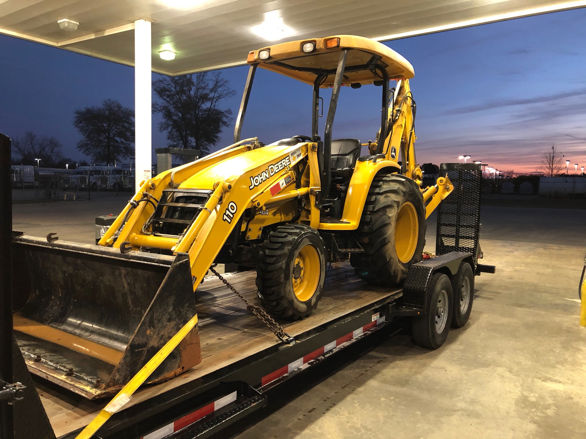

Everyone here is so great about sharing information that I figured I would ask my question here - I am looking at purchasing a John Deere 110 TLB but I know that first I need to have a trailer that will fit it. That's where I get confused. The John Deere specs says that it is 86" wide, but I see photos of owners with their 110 on various trailers like the regular skid steer trailers, and those are only 82-82" wide. Is the John Deere data wrong? How wide is the actual outside of rear tire to outside of rear tire width on the TLB? I don't have one close by or I would measure it myself. I am wanting to make sure that it will fit on a standard 83" skid steer trailer or not? Thanks VERY much in advance.

I looked for awhile and found pictures of the tractor in dump trailers and on reg equipment trailers so I think it will fit on a 82''/83'' inside width trailer.....
   / Question about actual width of John Deere 110 TLB #6
I have had my 110 on standard issue equipments trailers many time...no problem.
I think the "86 inch machine width" comes from the width if the machine has the 7 foot box blade that was an option when buying the 110 new.

Im pretty sure it will fit. This is a good trailer for the 110 TLB, I believe. Diamond C 19LPX GN trailer 22'.

Awesome! And thanks for the picture as well. That really helps!
You’re welcome. One other thing, the fenders on my trailer are removable. So if I needed a couple inches extra clearance to get something loaded I could. But I don’t need to remove them with the 110. It fits and tows fine.

90% sure the outside rear tires are close to the 72" range. The 110 is a clone of the JCB MIDICX
   / Question about actual width of John Deere 110 TLB #15
They’re probably measuring the stabilizers which are wider than the tires. My M59 drives between my 84” wide trailer fenders with room to spare. IMG_9144.JPG
