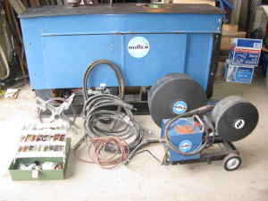

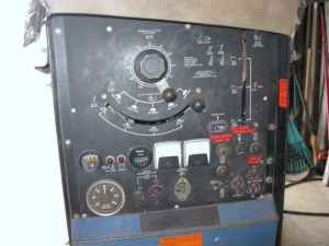

I do too now a days. But back when I had to make a living at it, it was how fast can you go.
Here is the machine I did most of that kind of welding with. I sold it in 1995, if I wasn't careful she'd blow a hole in 3/4 inch thick plate.:thumbsup:
