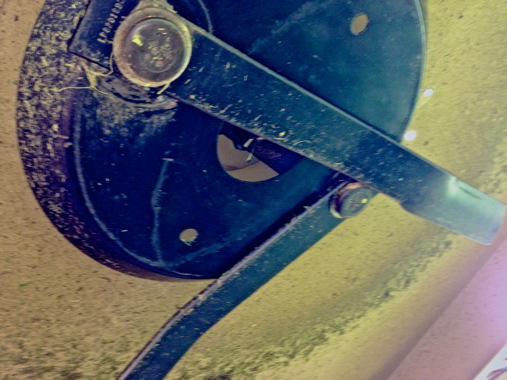

I don't think a blade can contact the opposite pivot bolt.
Mine does, maybe there is a washer missing or something, I don't think the blades are upside down and the mower cuts great.
   / Question About engaging PTO
#22
They won't hit the pivot bolt.
NotForhire & whistlepig mine is hitting the Pivot blot. It sounds like someone is hitting the cutter with a 8 lb hammer every time I enguage the PTO. I have no ideal what would happen if I engaged at high RPMs.

Thank to everyone that replied. Below is the email I sent the dealer. let me know if I am missing something.
I am hoping there is an assembly problem with my LandPride. The blades do not appear to be on upside-down but ever time I engage the PTO at the lowest possible RPMs, the blades slam into the pivot bolts. The seat kill switch only works when the PTO is engaged and must have a safety feature that locks the PTO because it jammed one blade on the pivot bolt andI had to beat it off with a large hammer.
If I disengage the PTO the blades spin down in cutting position. When I engage the electric PTO, I think the inertia of the blades cause them to slam into the pivot bolts sounding like I am hitting the cutter with a large hammer. I am think the blades should rotate 360 degrees.
Thanks

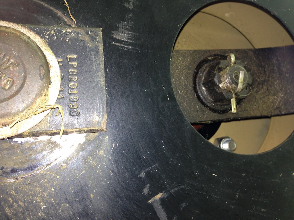

Idle speed is 800 RPM now. I might get it lower but I think the electric PTO will slam it at any speed. The blades have a bend but not enough to clear the pivot bolts. I see what you are saying about the first blade hitting the second but it appears to me with both blades rotating 360 degrees it would not be a solid stop as the pivot bolts and if both were rotating they could avoid the hard slam. Should the blades be hitting the pivot bolts?

View attachment 326220View attachment 326221

I don't think the blades on the LandPride should be slamming the pivot bolts making a noise as loud as a high power rifle. I think the problem is both the electric PTO and the blades not having enough bend to clear the Pivot bolts. Thanks for checking when you get your seat.
