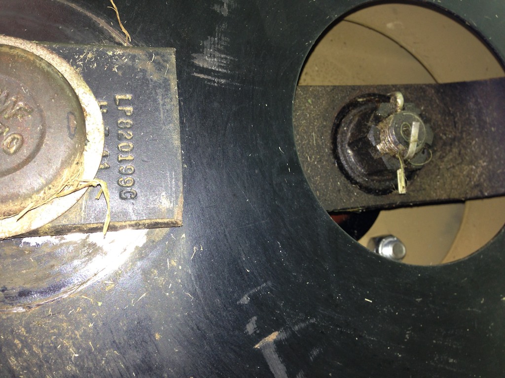

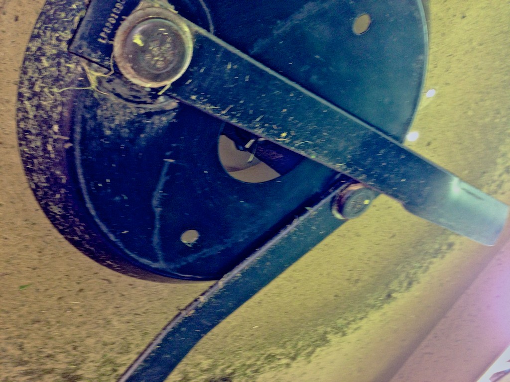

I don't think a blade can contact the opposite pivot bolt.
Mine does, maybe there is a washer missing or something, I don't think the blades are upside down and the mower cuts great.
/ Question About engaging PTO
#22
They won't hit the pivot bolt.
NotForhire & whistlepig mine is hitting the Pivot blot. It sounds like someone is hitting the cutter with a 8 lb hammer every time I enguage the PTO. I have no ideal what would happen if I engaged at high RPMs.

Thank to everyone that replied. Below is the email I sent the dealer. let me know if I am missing something.
I am hoping there is an assembly problem with my LandPride. The blades do not appear to be on upside-down but ever time I engage the PTO at the lowest possible RPMs, the blades slam into the pivot bolts. The seat kill switch only works when the PTO is engaged and must have a safety feature that locks the PTO because it jammed one blade on the pivot bolt andI had to beat it off with a large hammer.
If I disengage the PTO the blades spin down in cutting position. When I engage the electric PTO, I think the inertia of the blades cause them to slam into the pivot bolts sounding like I am hitting the cutter with a large hammer. I am think the blades should rotate 360 degrees.

#26
The blades will backspin and hit each other when the PTO is engaged abruptly even if they are free to spin 360 deg. If the blades on yours are straight with little or no dogleg maybe they can hit the bolts.
Is it possible for you to adjust your idle lower? Maybe it is set at the high end of the spec.
My neighbor had a blade break at the eye and fly off. The direction of the break looked like it was due to the blades clacking together at startup, and both blades had a significant dent at the point where they met each other on the backspin. His tractor is a Ford 4000 and it has a separate PTO clutch that is pretty abrupt.
Idle speed is 800 RPM now. I might get it lower but I think the electric PTO will slam it at any speed. The blades have a bend but not enough to clear the pivot bolts. I see what you are saying about the first blade hitting the second but it appears to me with both blades rotating 360 degrees it would not be a solid stop as the pivot bolts and if both were rotating they could avoid the hard slam. Should the blades be hitting the pivot bolts?

View attachment 326220View attachment 326221

I don't think the blades on the LandPride should be slamming the pivot bolts making a noise as loud as a high power rifle. I think the problem is both the electric PTO and the blades not having enough bend to clear the Pivot bolts. Thanks for checking when you get your seat.

If the PTO stops suddenly, the blades continue and the bend in the blades allows the blades to ride over the Pivot bolts and stick. If the PTO is engaged the blades swing backwards and hit the pivot bolts. The bend in the blades do not allow the blades to slide over the pivot bolts when going backwards for cutting direction. I manually pushed both blades back over the stump jumper and I was able to engage the PTO with the bang. It was a very acceptable start. I assume the blades swung out and the centrifugal force keep the blades from banging into the pivot bolts.

Check your manual on blade deflection adjustment to see if that might help. It is on page 21-22 on mine.
#36
Mine is a RCR 1272 and I have have read everything I can find on blades. I can't find a blade deflection mention. The manual did say instant on PTO could lock blades. It also said to use the optional soft start PTO if I had the option. I don't think the L3254DT has that option but I will check the manual. Still don't know if the blades are suppose to clear the pivot bolts. The blades are tight against the stump guard and the bolts have lock nuts. Just a little play would allow the blades to clear the bolts. Thanks for the suggestion I found a lot of useful information in the manual.
/ Question About engaging PTO #37
In the section on assembly: Start by assembling blades without shim (#2). Insert blade bolt (#1) through blade (#3), dish pan (#4) and
flat washer (#5). Temporary secure blade with a used 1 1/8"-12 nut. Draw nut up snug. Do not tighten.
Check blade deflection. If deflection is greater than3/4", remove blade bolt and reassemble as before except include shim (#2) in the assembly. Select shim thickness based on deflection. The greater the deflection, the thicker the shim.
Once blade deflection is correct, replace used nut with new locknut (#6) and torque to 450 ft-lbs.
I cant post pictures,but it seems "possible" this was not assembled djusted properly, just a thought.

Thanks for the reply. I don't think it is normal to hear metal slamming against metal as loud as a high power rifle. With the help of the forum, I think I may have a solution. The blades are tight and disengaging the PTO leaves the blades extended. When I engage the PTO the inertia of the blades cause them to slam back into the pivot bolts. If the blades were not so tight, I think they would swing forward when I disengage the PTO. I have moved the blades forward and I don't have the loud bang when enguaging the PTO. The blades swing out and not back into the bolts.
