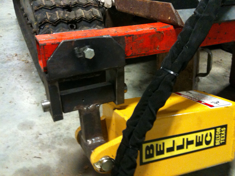

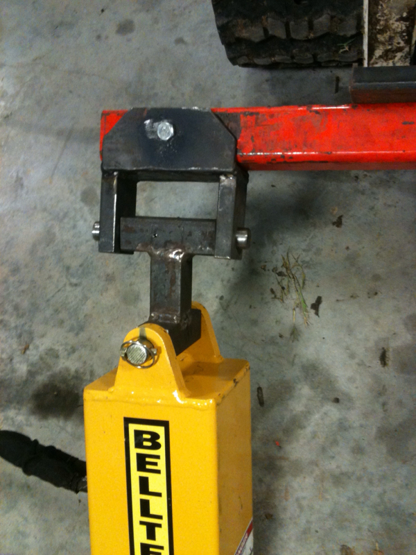

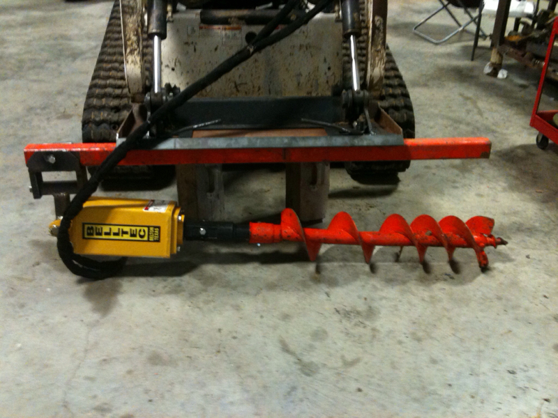

Auger mount allows auger to fold close to mount, easily fits on trailer. Chain hold auger folded to mount is not shown

As for the swing cylinder. The loader hydro's will be able to control the tilt of the auger bit from front to back. I want to have another cylinder built into all of this to control the swing from side to side. I don't want to have to rely on a second person showing up to help dig holes. This way it can all be done from the drivers seat. Rather than the unit dangling from the pin. And it will be reversible and selectable to the different pin slots depending on which side of the tractor i need it to be on.

You might consider that perhaps 95-99% of post hole diggers use gravity to keep the auger point down. If you make a slight adjustment in augerCG possible you should have a plumb auger bit. This will greatly reduce cost. My photo shows two swivel pins 90 degrees apart. K.I.S.S.
The arc movement of the bucket travel is such that for a straight plumb hole you need to back up and go forward as you drill. Most of us ignore this without issue. Some bobcats have a vertical travel lift arm geometry.

I understand what you mean. I'm planning to just leave my tractor in neutral to allow for the arc of my FEL downward travel and leave the rest of the slop alone. As far as the additional cost, it will only be one additional hydro circuit,valve, and cylinder. I plan to eventually add this for other implements anyway. Thats what I was referring to earlier in the thread as the reason for this project taking longer than any others is because of this initial startup cost. I will eliminate one of the pin mounts that you have, using the bucket tilt instead. And the other pin mount will not swivel by gravity, but rather by my control of the cylinder attached to the auger assembly. I know its probably overkill and there will probably only be very few instances where I will actually hook it up this way. But at least the functionality will be there. There have been several times when using a 3 point mounted post hole digger that I have wished I could better control the side to side sway of the bit. Whether it was due to some slop in the hitch/PHD/auger attachment, or because the tractor wasn't able to park perfectly level with where the hole was going, etc.

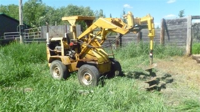

I build this one from scratch about 6 years ago, the 12" auger part is the only thing i bought.
I dug at least a hundred 4-5' deep holes with it without an isue
I can mount it on any of the 3 front end loaders i have.

I have no clue as the identification plate is to damaged to read. I got this motor at a scrap yard for free.
It is a roller motor and has a 1/14" keyed shaft and it makes max 85 rpm being fed by a 25 gal/min pump at 2250 psi.
It works fine with the 12" auger bit as long as i take it easy as the bit will stop turning when i put to much down pressure on it.
It could be that the motor is somewhat worn which might be the reason it was in the scrap yard to start with but so far so good.
I drilled another 30+ holes this summer without an issue.
