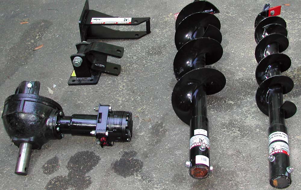

That's a big motor and you will need something that big to go direct-drive. Then you will have
the axial load problem mentioned above.
The approach I used is to go with a much smaller conventional motor of about 7 ci, and a 3.18:1
gear reduction box. Mounted at right angle, this also gives me more clearance in terms of loader
or backhoe or 3-pt height. And no axial loads to the motor. And no fancy taper-shaft adapter.

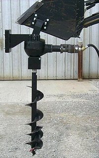

I modeled my DIY unit after the Worksaver 714H unit, the least expensive hyd PHD I am aware of.
The gearbox is from Agrisupply, and the motor I used is a White 500-series.
I bought and mounted 2 of the 714Hs to my backhoes, before I made this one. The Worksaver
unit costs about $1700, and the 48" HD augers start at about $250-300 each. My DIY unit
is not going to be used, so it is for sale locally for $1200 including 2 Worksaver augers.
