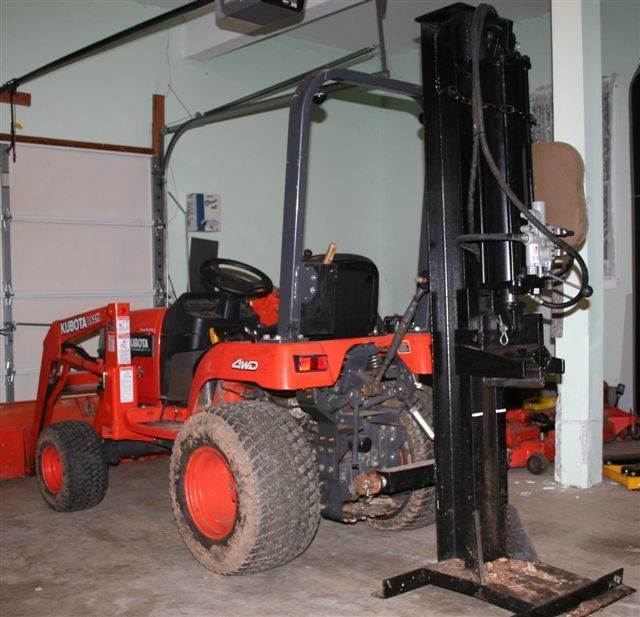

I used a 5" cylinder with a 24 inch travel. It has enough power to split anything but it's a little on the slow side. It's fast enough for me because I do most of my splitting by myself but if you are lucky enough to have a helper you'll have to wait on the splitter. If I build another one I would probably go with the 4" cylinder and give up some power for a little more speed. Splitter.jpg

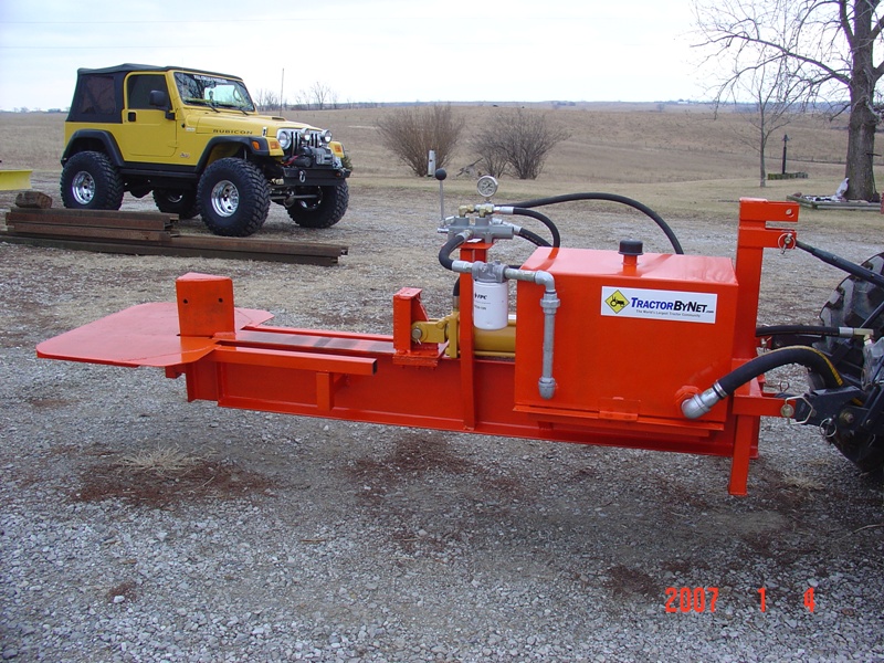

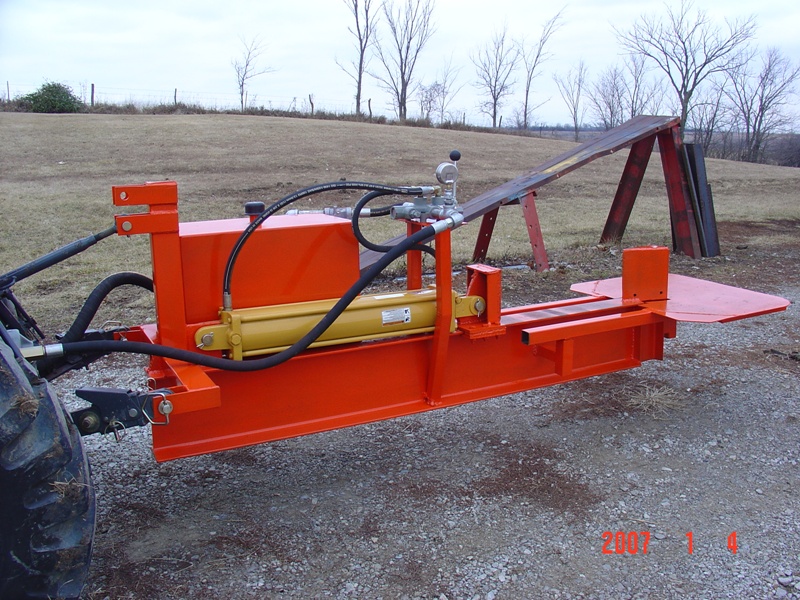

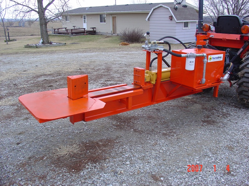

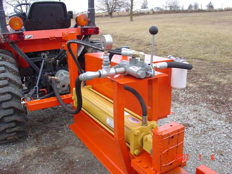

I built mine with a PTO 21 gpm pump, 4.5"cyl barrel with 2" ram, 24" stroke. I used a PTO pump to get speed. The pump cost me $429. I put a high value on speed so it was worth it to me. Cycle time of 4-5 seconds. I also built a catch platform for the split pieces. I love my splitter. For those logs you can't lift I simply lower it to the ground and roll it on. For normal sized logs I have the splitter at a height that doesn't kill my back. I don't like vertical splitters for that reason. When you are done splitting the wood is laying on the ground. I've attached a couple pics. I really enjoyed building mine, hope you do too.
Question for everyone using remotes,,,, how do you reach the remote lever while holding the log on the splitter??? Hmmmmm..... :confused:

Bross, I notice you have a valve on your splitter but are running it from the tractor's hydraulics. How do you do that??? Do you tarp strap the remote valve handle in an open position?? Thanks in advance for the clarification.

Ovrsxd, I am using the tractor's hydraulics. In the picture the hoses aren't hooked up, but when I'm using the splitter I disconnect the quick connects on the hydraulic lines to the loader and connect the splitter in there.
/ question about hydraulics. Log splitter #15
You are accessing the hydraulic flow prior to it going into the loader controllers?? If so that would make sense.

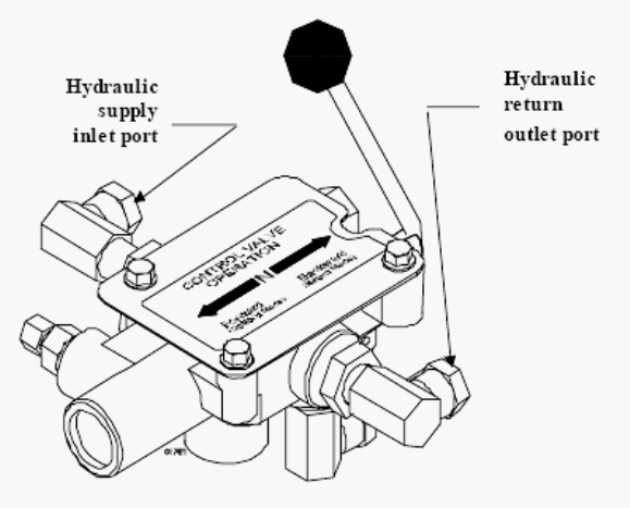

I have a Kubota L3400 with a FEL and would like to tap into the hydraulics for a Northern equipment 3pt log splitter. I am willing to deal with the slow performance. It seems the easiest and least expensive method would be to connect into one of the QD on the FEL.
I would disconnect one of the bucket (curl) connectors for the valve input (should be a Prince LS3000) on the splitter. I don't believe the valve has a power beyond and therefore I would connect the valve return to a port plug (75541-68150) which is available through Kubota for about $20. Finally I would use a bungee cord to hold the valve open on the FEL and use the valve on the splitter. The only additional expenses in this setup are the 2 hoses with QD and the port plug. If I am missing something in this design I would greatly appreciate any input . Thanks

You can accomplish what you want by connecting the log splitter valve to the A and B ports of the bucket spool with quick disconnects and then holding the bucket spool open with a bungee cord in the direction required to sent high pressure fluid from the pump to the inlet port on the splitter valve.
But there is a risk of at least damaging the seals on the splitter valve (and perhaps worse) if you use the three point hitch at the same time that the FEL spool is shifted, since the splitter valve has no power beyond. The pressure needed to operate the tph will also be present in the exhaust gallery of the splitter valve, and I doubt (but have not checked) if it is rated for more than 200-500 psig back pressure. You can probably get by if you return the FEL spool to neutral every time you raise the tph, but that seems like a trap for someone who is not familiar with the system.
If (and that's a big if) you are not going to use the three point hitch,
