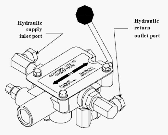

I have a Kubota L3400 with a FEL and would like to tap into the hydraulics for a Northern equipment 3pt log splitter. I am willing to deal with the slow performance. It seems the easiest and least expensive method would be to connect into one of the QD on the FEL.
I would disconnect one of the bucket (curl) connectors for the valve input (should be a Prince LS3000) on the splitter. I don't believe the valve has a power beyond and therefore I would connect the valve return to a port plug (75541-68150) which is available through Kubota for about $20. Finally I would use a bungee cord to hold the valve open on the FEL and use the valve on the splitter. The only additional expenses in this setup are the 2 hoses with QD and the port plug. If I am missing something in this design I would greatly appreciate any input . Thanks
greg

Greg:
You can accomplish what you want by connecting the log splitter valve to the A and B ports of the bucket spool with quick disconnects and then holding the bucket spool open with a bungee cord in the direction required to sent high pressure fluid from the pump to the inlet port on the splitter valve.
But there is a risk of at least damaging the seals on the splitter valve (and perhaps worse) if you use the three point hitch at the same time that the FEL spool is shifted, since the splitter valve has no power beyond. The pressure needed to operate the tph will also be present in the exhaust gallery of the splitter valve, and I doubt (but have not checked) if it is rated for more than 200-500 psig back pressure. You can probably get by if you return the FEL spool to neutral every time you raise the tph, but that seems like a trap for someone who is not familiar with the system.
If (and that's a big if) you are not going to use the three point hitch,
