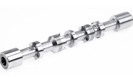

A motor spool, other than allowing the motor to freewheel when returned to neutral sometimes has either a tapered land rather than an abrupt square edge or else cuts around the circumference of the land to allow easier feathering of the flow.
I've ground tapers on a spool before when I've been in a pinch and it's worked but it was more luck than skill as there's a good chance of warping the spool
Not good examples but all I could find:

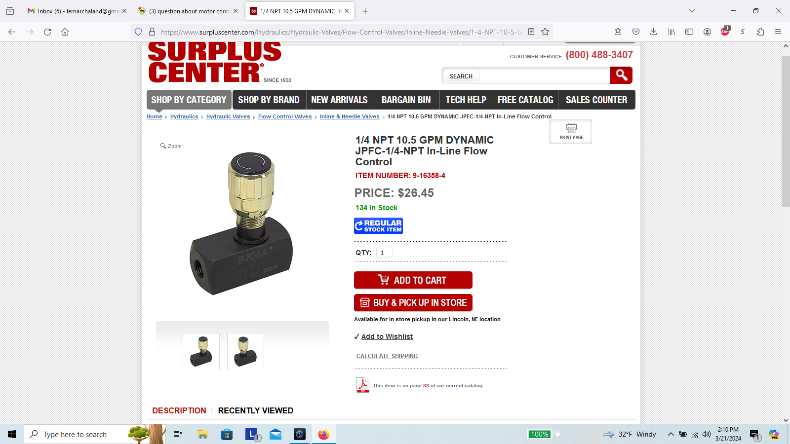

So it sounds like all you need to do is adjust the rate of the cylinder that is moving your cutterbar.
Something like this would allow you to regulate the cylinder slower in one direction while retaining full speed in the other. This valve allows flow to be restricted one way but allows full flow back the other way.
   / question about motor control valve
#19
I think that you are right. it will labor the hydraulic pump but I can adjust the pressure relief valve. Thanks
