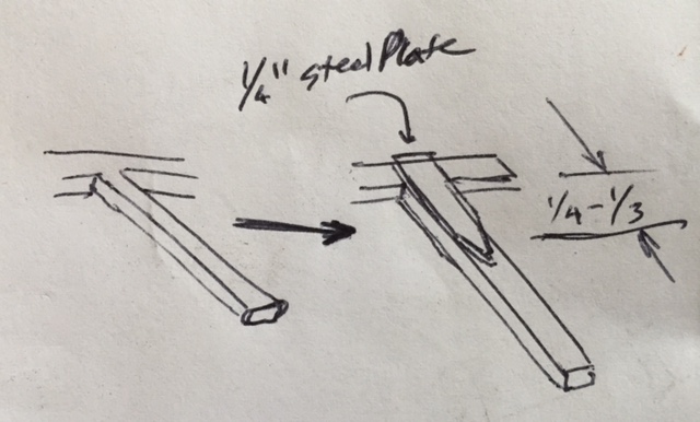

Working on plans to build a set of 3PH forks.
For the tines, the plans call for 2 x 2x 1/4" tubular steel- 43" long.
They have been load tested to over 2000lb lift capacity in this design.
I was considering using 3" x 1.5" x 3/16" inplace of the 2x2 called for in the plans.
This seems to be a better dimension for tines.
The steel guys did not know if the 3 x 1.5" was available in 1/4" thickness?
My question is how strong is the 3 x 1.5" tubular steel compared to the 2 x 2 x 14" sotck?

Structurally, the extra 1" width is basically just extra weight.
The 25% loss in height, however, coupled with a 1/16" loss in wall thickness, will be a pretty big structural loss.
If you can, I would go with 3x2x.25" or the original 2x2. Otherwise your plan will be okay, you'll just have weaker forks.

You'd be losing both height and thickness with the 3 x 1.5 x 0.1875, so they won't be as stiff as the 2 x 2 x 0.25". Offhand, you lose about 25% due to thickness (all else equal) and 44% due to height (all else equal). Combined, you'd have to compute the area moment of each cross section, but it will probably be in the 50% range. So yes, quite a bit less strong by the back of my envelope.
/ Question about steel strength?? #5
IF you want to know specifics, use a moment of inertia calculator for rectangle tubing. Plug in the numbers and see what you get. What you get is directly related to strength.
2x2x1/4 tubing is ~.91
3x1.5x3/16 is ~.53
the 2x4x1/4 I mentioned is ~1.68
So, 2x2x1/4 is "almost" twice as strong as the 3x1.5. And 2x4x1/4 is almost twice as strong again

Wood will add very very little because it will do all its initial deflection barely even adding to the strength. Plus it can have no fixation at its ends. For the same weight it would be much stronger to add steel. Add flat bar at the root of the tine (top and bottom). Maybe weld the top one entirely before welding the bottom to pre-tension it in the upward direction (speaking of wood,,,, its like a woodie :D ).
If you are intent on minimum weight (and enjoy craftsmanship or making your projects take longer) step the thicknesses of your fork tine material. The root being 1/4" thick then 25% out, switch to 3/16", then 1/8" for the final half. I'd do cuts/welds on 45deg. But you will need full confidence in your welds (not to mention thick forum-skin)! Heh heh,,,,,,, Sorry guys dunno why this came to me. :D
If you like 3x1.5 x 3/16" then adding another 3" x 3/16" plate top and bottom at the root of the fork tine should be stronger than 2x2x1/4. I'd holesaw a few 3/4" holes in the plate center every 4-6 inches and weld up the spots.
Its my opinion that a B7800 will have very much diffuculty bending a 2 x 2 x 1/4". IMHO you can make the 3x1.5 work if you beef up the first 25% or 33%.
Adding a 3/16 plate top and bottom would certainly increase strength ALOT. And would give an overall fork thickness of 1-7/8" thick and 3" wide. So why not just buy a 2x4 or 2x3 tube and save alot of time and effort.

Based on the 2x2x1/4" being 1.7 times stronger than 1.5x3x3/16",,,, this is "sort of true". But there is not enough information here to "fail" the 1.5x3 for this application.
The output of the 7800's 3-pt hitch is 1650 lbs at the hitch. This 1650lbs lifting force diminishes rapidly as distance from the hitch increases. I'm going to make a guess that if the 3-pt lift arms are only 10 inches long, that you would have about 825 lbs capacity. Certainly just one tine of the 1.5x3 tines can hold that. At 20 inches long you have 550 lbs capacity at the end. At 40 inches you have 330 lbs capacity.
It's my gut feel that you could use the 1.5x3, and probably 1.5 x 3 x 1/8 if you doubled the first 10 inches. Point being that the forks don't have to be heavy for a SCUT. Solid, forged forklift forks from a 5,000 lb forklift ($200/pair used?) would be overkill but can be free if you know lotsa folks with 'stuff' ,,,,, While they could be 'free' they will require a lot of "fabrication" to "attach", and a lot of effort to move around the yard when NOT on the 3-pt.
Engineering can solve this, by example or theoretical or both. Jode you have options for weight carrying capacity, tare weight of the attachment (which reduces lift capacity as you said), ease of assembly, materials available, these are all considerations. Might be useful to know the thinnest material that can support the output of the 7800, then just double or triple the section.
