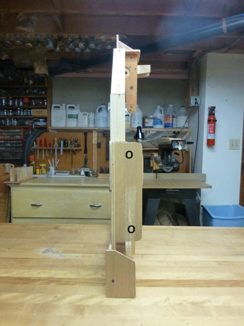

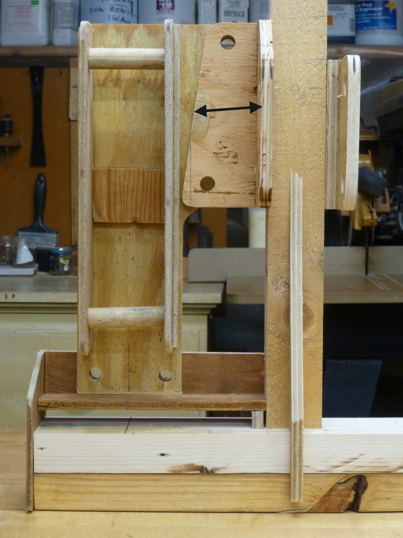

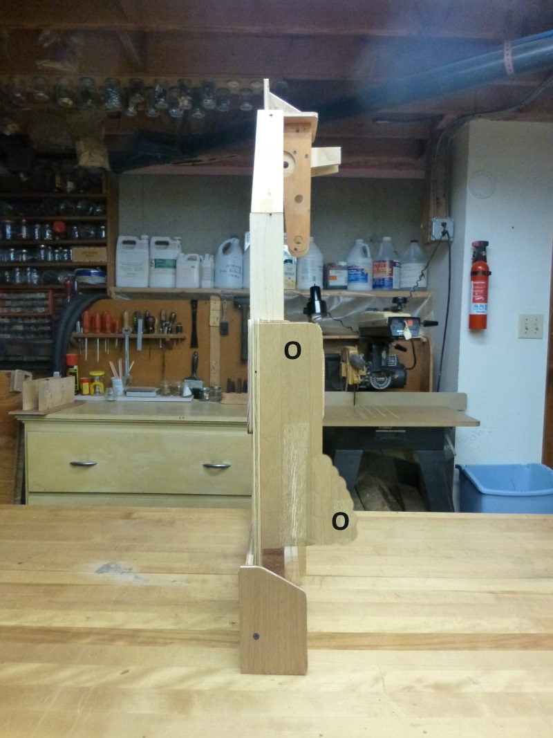

My B7800 has a pin on bucket. I am making a set of forks that will attach to both the
3ph and the FEL.
What I now need to do is mount the FEL brackets onto
the frame. I want to bolt the brackets on so I can remove them when
not in use.
The photos of the wooden model shows the frame mounts and the
FEL brackets that need to fit together.
My question is, will these brackets (see model) work?
Are they strong enough, or is there a better way to mount them?
Thanks again-

I know you are making forks, I edited my post. Seeing the pin on brackets confused me.
The brackets should work.
A gusset where I added the arrow would help make it stronger.

Lets add 2...thanks.

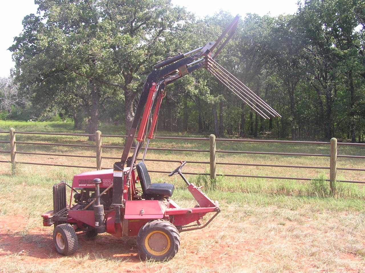

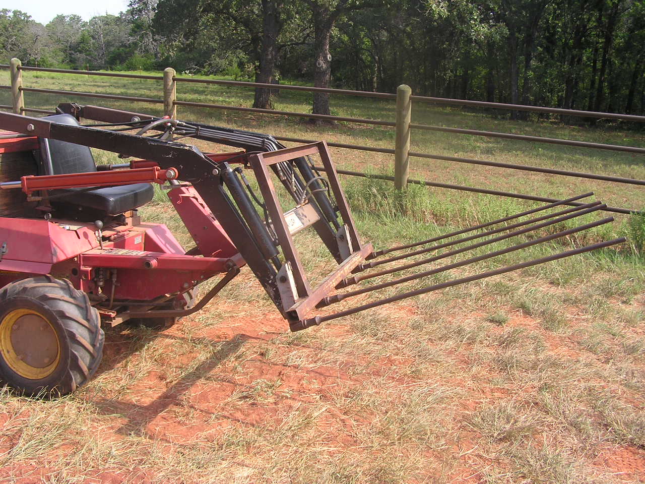

Have you checked the rollback angle? I noticed the pins are straight up and down.
When I made my pin on brush fork, I angled the angle iron mounts and offset the holes to get enough rollback on the ends. Also note the chain slots, very handy.

In the video, starting at 40 seconds you can see the offset holes on the grapple. Then look at the bucket, it doesn't have near as much rollback.
Without rollback, driving downhill stuff will fall off of the forks. :eek: :thumbdown:

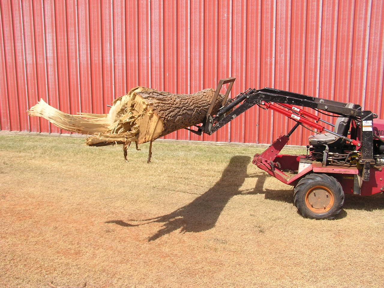

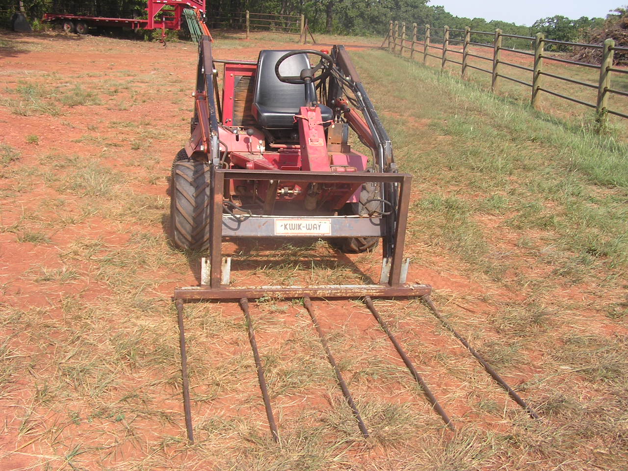

With that quick coupler, I recommend building the frame wide like my brush fork frame and add one permanent crossmember for the 3 point lift arms. It would be stronger and lighter than your removable brackets. You can use flat plate for the pin holes, like is shown in the video, not angle iron like I used.
Here it is back in 2009 with a cottonwood log that weighed 805 pounds.

Xfaxman - I get a kick out of seeing the old Toro lawnmower turned into a loader. I will bet it is handy though. It seems like you are a little close to the action though - maybe a little in the dirt? I like the brush fork concept. Very simple and I will bet useful.
