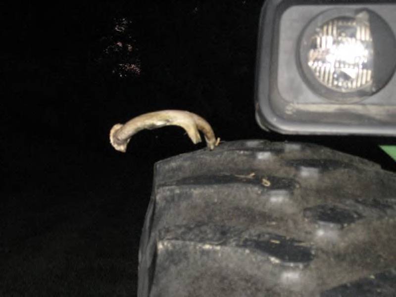

The green slime mentioned in a earlier post is from TRC or texas refinery company. This stuff does work! We had a issue with a trailer buidling plant where the workers would nail the tires when they didn't want to go out in the cold.
It was nearly two years before we saw the tractor again!
166 nails later we sent it backout!

Given the choice I'd rather not use the green slime. It seems to be quit corrosive to the rims. Is fixing the roofs an option seeing as that's where the nails are coming from?

I tried that but it works until the next hole, I have replaced the tires all around 4 times in a year.
I would say it would be much cheaper to foam the first set of tires than buy 16 new ones!!!!! It only costed me $1100 to foam the much larger ag tires on my L3400. What did 16 new tires cost?

How is this going to work any better than the last set of tires that you filled with slime? I think you need to bite the bullet and get the foamed or else you will be buying tires and slime forever and be out more money and down time than if you foamed them in the first place.

What do you mean 16 new ones? I only need 4 tires and they will cost me $489.00 all together. There is no where to shop around for the cheapest place to foam cause the closest place is more than 100kms away and they are the only place that does it.

True. What I'm probably going to do is buy a set of ag tires to keep the tractor going and send in the industrials for foaming, then after a while when I get the industrial tires foamed I will send the ag tires in for a foam fill. It's more I know but it will keep me going.

I'm in the "business" tire wise and the only solution to your problem is to have them foam filled.If it were me though,I'd buy new R4's to have filled and keep the old one's as spares if I could find extra rims.The deeper tread overal on the R4's plus the fact they don't have such huge voids (which have way less rubber than the lugs) that would allow them to be cut or punctured as easily.
The reason for buying new is so that they won't have possible separations in them that could cause a failure.The foam only replaces the air and the tire is
still susceptible to coming apart,and they won't last forever.So if you're going to spend the big bucks,make sure you spend it wisely.
It will add to the weight about as much as they would if filled with calcium chloride or rim guard.
