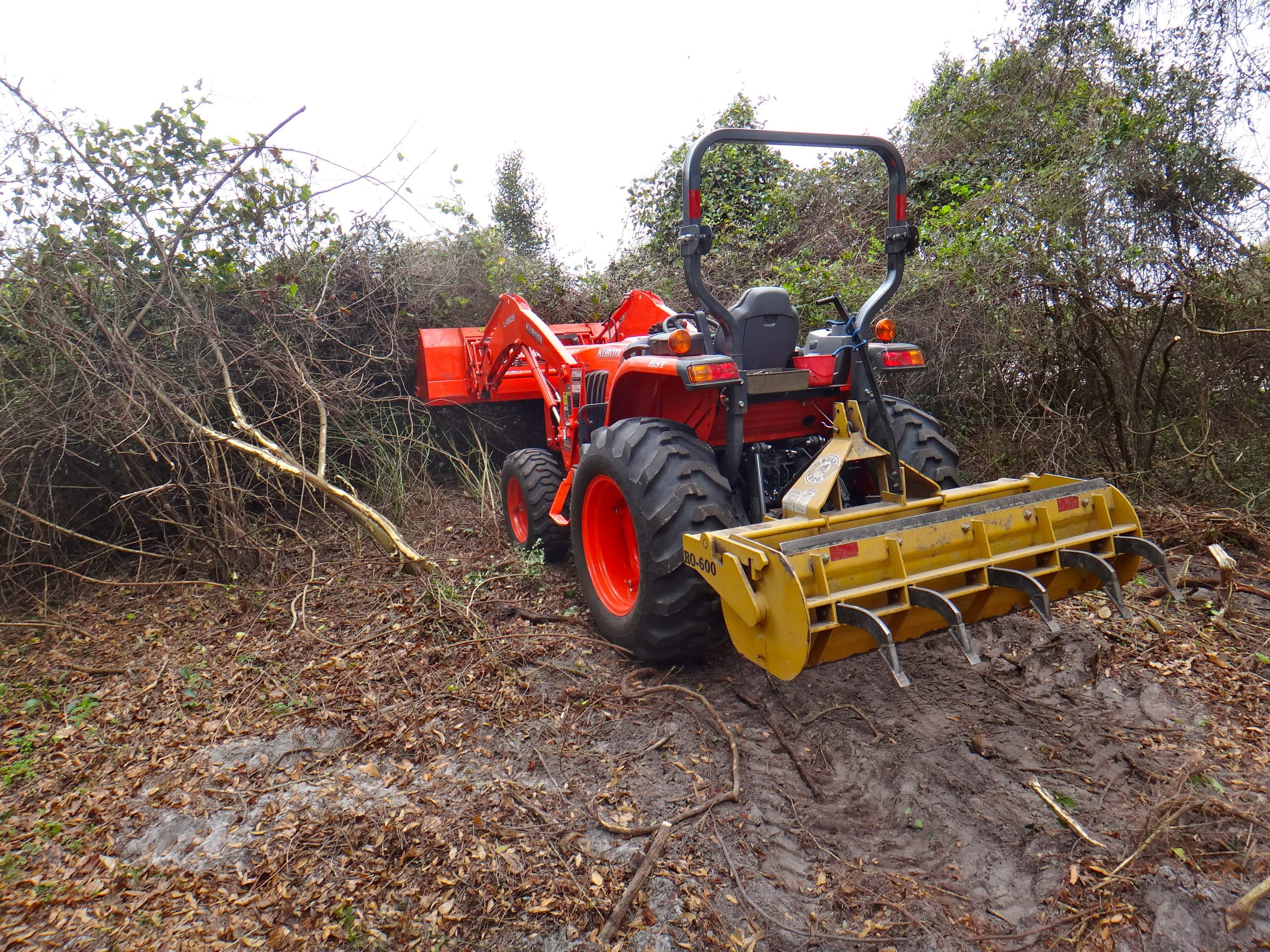

I mow with a Land Pride medium duty, 60" RCF2060 Rotary Cutter. Occasionally I drop off the bucket from the FEL when mowing. I never feel the need for additional front end weight when mowing.
My ground is flat. My small tractor is fairly heavy. My small tractor has 4-WD. My tires are filled only with air. For FEL work I use three point ballast only. This works for ME.
If you will be mowing COMMERCIALLY, punctured tires are part of the game. You do not want loaded rear tires and a puncture together.
Soggy Water Oak in the photos was around 1,600 pounds. Rollover Box Blade is 630 pounds but CANTILEVERED FAR BACK making greater EFFECTIVE counterbalance. (Maybe 1,000 pounds EFFECTIVE counterbalance?)
Buy enough tractor.
