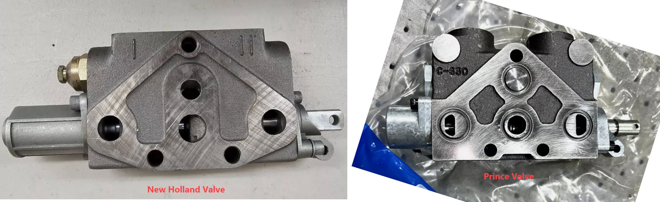

New Holland TN75DA
Does anyone know if the stack valves that Case/New Holland uses for their mid-mount & rear remotes on the Farmall/JX/TN/Other series are the same flange pattern as the Prince Series 20 valves? They *look* to be the same; I'm not near the tractor at the moment to compare dimensions.

Thanks for your response, TT. Found a couple of pics online; going off of them and known/assumed dimensions it looks like an adapter plate may be pretty simple to model up and machine out.
Pic attached for reference

   / Question - CNH / Prince Hydraulic Valves #4
It may work, but I agree with you that adapting may be simple. Keep us posted.
   / Question - CNH / Prince Hydraulic Valves #5
Is the series 20 rated to handle the flow from your tractor? Not sure if your tractor is open center or closed center but if open center need to size valves appropriately since will be passing flow all the time.
Open center and yes, they are.
