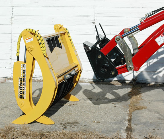

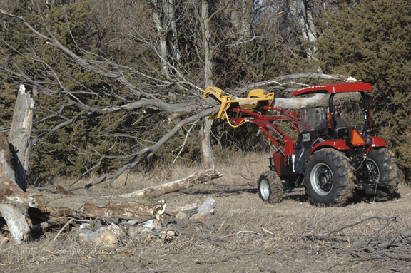

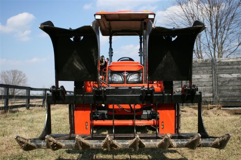

I'm not sure the OP wants this to evolve into a grapple thread. We all know there's plenty of those!:D As soon as "He Who Reigns Supreme Over Grapples" (aka IslandTractor) finds this thread that may change!;)
http://i217.photobucket.com/albums/cc191/ChucklesKY/GrappleMedium.jpg
http://i217.photobucket.com/albums/cc191/ChucklesKY/Botazilla4Small.jpg
http://i217.photobucket.com/albums/cc191/ChucklesKY/IntimidatorMedium.jpg
A grapple is not really required for moving some logs. But they are so fun! There's nothing like being able to grab something securely without leaving the tractor seat, move it somewhere, and then release it! I HAD to go even deeper into debt when I bought my tractor to go ahead and get a grapple.

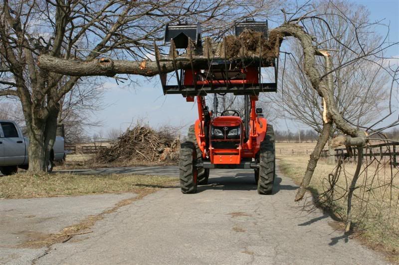

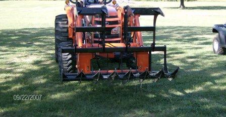

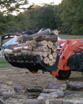

If you have a skidsteer quick attach bucket, I think you would really be pleased with a fork bucket as a start and an add-on grapple to really optimize it. The advantage of a fork bucket over addon forks is that you can get the weight back closer to the bucket pins. This allows you to better use your loaders available lift capacity. A log across an open bucket puts the weight out a ways from the lift pins and reduces your overall lift capacity as well as increases the moment arm that the weight is being applied back thru the tractor structure.
Another nice thing about a fork bucket is since you are moving around downed trees, I am assuming you are also dealing with the limbs that were once on these trees. Fork bucket is a wonderfull tool for this. You back rake them into a pile then scoop them up(you can see me dumping limbs and debris onto a pile with my fork bucket in my Avitar:)). Here is where a graple is really handy as it will clamp down on the pile and hold it while you drive to wherever you are dumping them. I ran my fork bucket for over a year without grapple arms, now I wonder how I ever picked up anything, or kept it on the bucket, without them. A grapple makes moving a log a real easy affair, drive in, scoop, clamp and drive out. With a little paractice, you will be able to do this so fast, the tractor will hardly stop, and then only to shift into reverse:)
If you look into a fork bucket, look closely at the weights. Some are built really heavy and too heavy a bucket will take away a lot from your available lift. I built my own and this was one of my biggest concerns when designing its structure.
Good Luck, and as mentioned, Practice, Practice, Practice...
