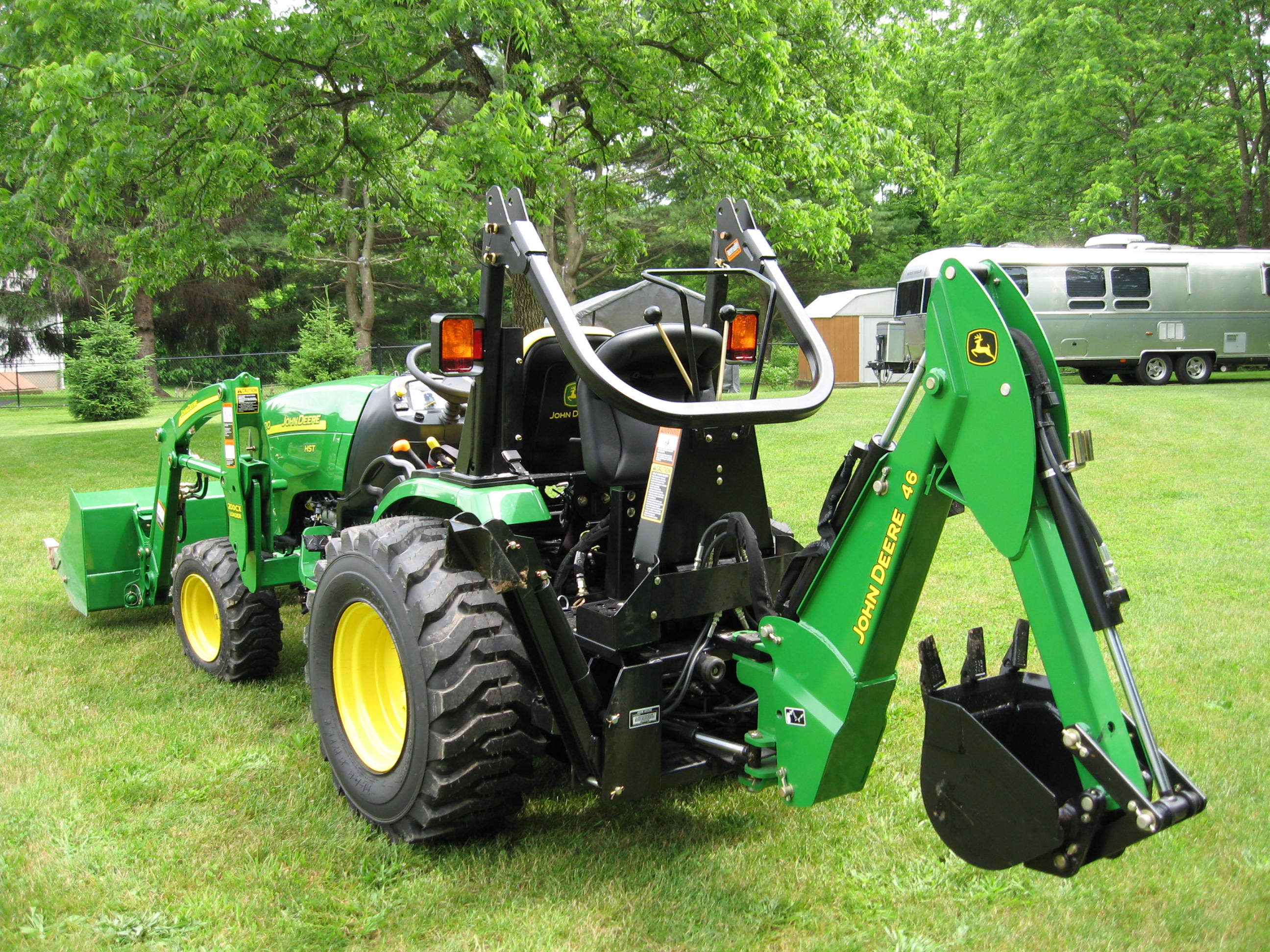

If I may beat my own thread to death a little more:
I'm reading that the 46 backhoe can have tire clearance problems on the
2520. When you "build it yourself" on the JD website, there is a warning that the front tires can rub the front subframe mounts under certain conditions.
Also, there has been some mention from those on the board that the footplates on the backhoe are very close to the rear tires.
Can those who have the 46 backhoe on the 2520 please advise whether they have actually experienced any tire clearance problems?
Chris2520, I read that you "clearanced" your foot plates. Was that because they were actually rubbing the tires, or just because you wanted more space?
Before I cough up the cash for this thing, I'd really like to know if I'm going to be up against any kind of fit issues.
Thanks.
   / Question for 2520/Backhoe Owners #16
I have the R-4 Industrial tires front and rear on my 2520, and have no clearance problems. The front tires clear both the subframe and fel mounts. The 46bh footplates have approx a 1/2" plus clearance from the tires. I have not noticed that the closeness of the footplate has added to any additional dirt or material pickup.
I believe that the R-3 Turfs do have a more significant clearance issue, and some have found them to rub.
I love the performance of the 46 backhoe. Craig

I do believe that many have found that the R-3's rub, but hopefully others will share.
I don't believe any other backhoe, other than a 3pt mount would work, I think that the frame of the 46bh is the only one that will fit the 2520. Other manufacturers (Woods) have 3pt options that could be used. I think Woods even has a curved boom design that has a 3pt mount.
I think the 46 came out with the 2520, but do not have personal knowledge that this is so.
Bucket size depends on your soil/use, I have heavy soil with clay and alot of rock and stone, I have found that the 13" bucket works well for me. I sometimes wish I had the 16" bucket, but I think 13" is the best all-around size for my application.
