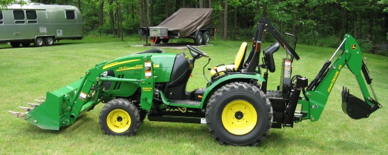

Another view with the 46bh.

Runner,
I hate to take credit but I started the problems with the tire clearance with JD. I actually punctured a front tire. Yes I have turf tires installed, so they used to hit the front bh subframe brackets. JD made a set of brackets to replace the original BH brackets, and the tires do not rub anymore. From what I was told by my JD dealer, I have the only set of brackets so far. I don't know when JD will make these brackets available to everyone. I'll get some pictures of the new brackets posted soon.

I'd like to see some photos of these brackets. I have turfs and would like to buy a 46 hoe, but I'm worried about this rubbing.

Wow first time I hear about this problem and the 46BH... I have had my 46 for more than 3 years now on my 4110 with turf tires and had no tires rubbing what so ever. I would like to see those brakcets though so I can compare to what I have on my 4110 now.

I did some more research and found this thread with photos: http://www.tractorbynet.com/forums/jd-owning-operating/85506-46-bh-subframe-front-tire.html
I'll have to check my FEL frame/tire clearance with one front wheel higher than the other, but I seem to have more clearance than what is shown in the photos. I ran tire chains on all 4 wheels this winter (lots of ice here) and the chains just barely rub at full steering lock while on level ground.
From the photos in the thread I linked to, it looks as though it might be possible to relocate the U-bolt inwards an inch or more and then cut off the resulting "extra" material from the BH bracket in order to gain some clearance. I haven't seen a 46BH installed on a 2520 up close and personal, so I may be wrong. You can bet I'll I'll be discussing this issue with my dealer before I purchase my BH!
