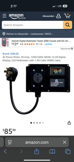

Finally bought new generator Westinghouse 9 kw. Installed manual disconnect switch with 50 amp cable so the whole house will be supplied during power outage. Would be nice to monitor output wattage... Found this on Amazon
The problem is 10 awg cable. 10 awg supposed to support 30 Amp. Sent txt to the seller and his answer:
"The short distance (1.3 ft) means that the resistance is low and the cable is resistant to high temp., so it can pass 50 A current".
I find it hard to believe. Any opinions? Are there other similar gadgets? Don't want to overload the generator.

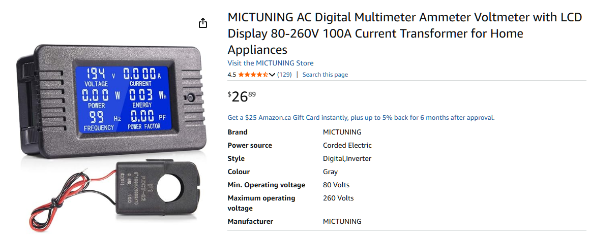

There's no separate wires anywhere in the circuit you can get the pickup around?

Electric water heaters and ranges are usually fed with 10/2 or 10/3 romex and a 30 amp fuse - however if you look at the wires inside the appliance they're usually 12AWG. Those wires are short runs so it works. The Amazon amp meter with its 10 AWG wiring is a short run and should be OK. If you're like me you'll monitor the amp meter and see which appliances you can run simultaneously and then once you know the meter will come off and sit in a drawer. The generator will sit outside, as will the meter. Worse case scenario, in the unlikely chance the meter wires or gauge overheats, it's outside anyway. The Amazon amp meter is really unique, I did a quick search and couldn't find anything else that would let you monitor 50 amps without tapping into or separating the two 120V legs. It's inexpensive too.

In theory, it would probably work…..but….. I would not purchase it unless it is “approved “ by UL or a similar standards agency.

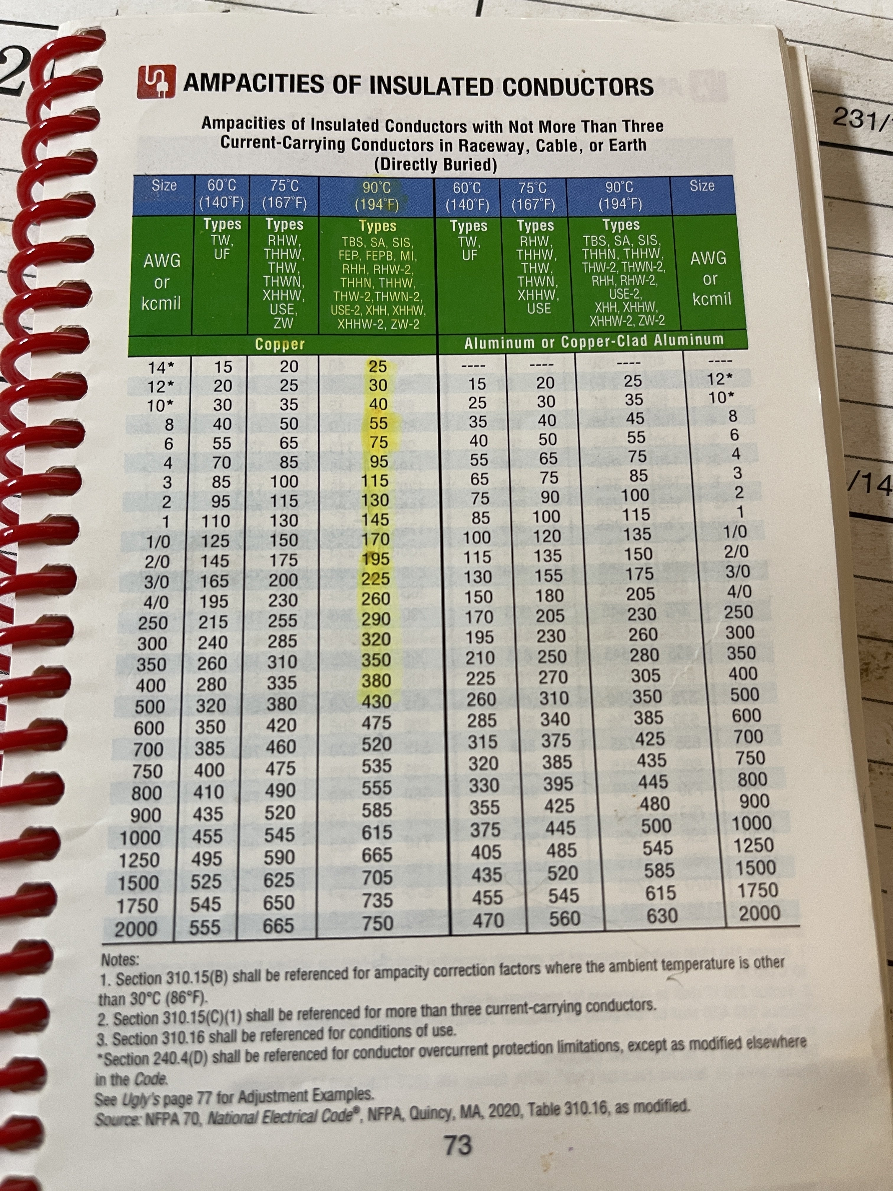

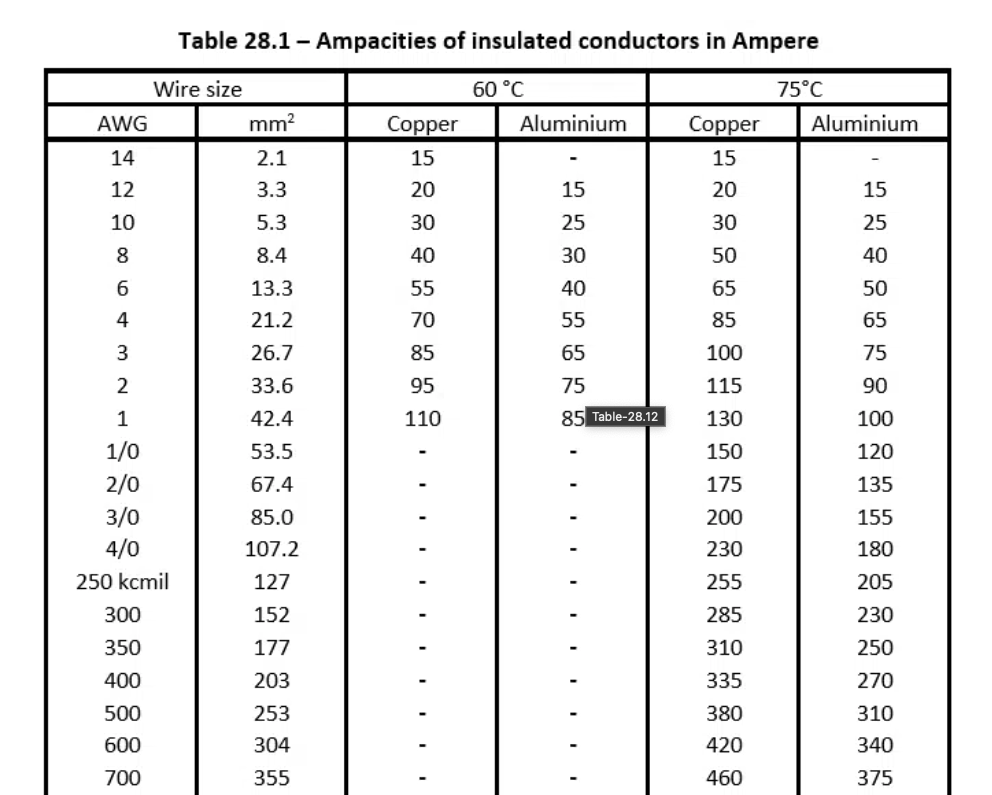

What type of cable is it (look on the cable jacket) and what Temp rating in C is it? That will determine your Max amperage rating. NEC states that a #10 is only good for 40A, if the wire insulation is rated for 90C and it is a copper conductor. The only other way a #10 would be rated higher is if it was a single wire conductor and it was in free air. Then it would be rated for 55A. (which in your application, wouldn't apply, as it has 2 current carrying conductors in a cable.) You don't get to increase amperage ratings because the cable is short. Also, there is no such thing as a #9 gauge wire. Even if it was in IEC standards, they would use a mm squared for wire size. I would steer away from that device. If it caught your house on fire because it doesn't meet NFPA 70 (NEC) or have a UL listed or recognized part label affixed to it, insurance might not pay out. UL is more stringent on wire ampacity, as the do not recognize any general wire insulation over 75C.
This is the wire ampacity charts from UL 508A, table 28.1. UL only recognizes 75 deg C max temp rating.
