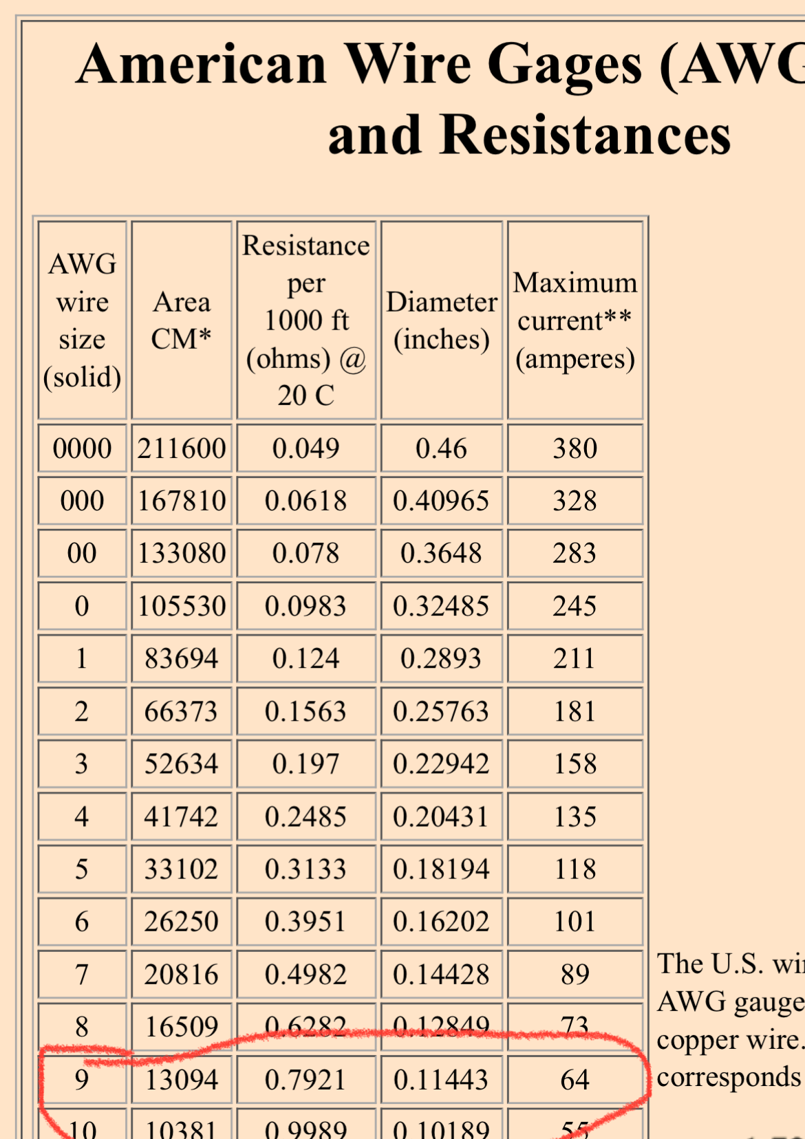

Generator is connected to 50 A breaker
Then I would not use that device with AWG 10 wiring.
In all likelihood, any localized heating within the AWG 10 will be dissippated through the connected devices, but you really don't have the ability to easily make that determination. The 50A breaker could allow the wiring to operate beyond either the rating of the wiring itself, or at least the terminations on the connected devices. Not Kosher.

They seem pretty proud of the 9AWG multi-strand cable, and claim pure copper. I don’t see any compelling reason to believe it’s not 9 AWG sized.
9 AWG is non existent in normal building wiring, but it certainly exists in multi-strand specialty cables, despite some saying to the contrary.
/ Question for electricians #27
AWG 9 does exist, or more commonly metric approximate equivalents thereof (e.g. 6 mm2). But OP stated it was labeled AWG 10:
The problem is 10 awg cable. 10 awg supposed to support 30 Amp.
/ Question for electricians #29
In that case, this all makes much more sense. 6 mm2 wire (approx. AWG-9) is indeed rated 50 A for up to 3 wires in a bundle with 90C insulation and terminations. That is probably why the manufacturer rated it as such.

Using a solid wire spec for 9 awg, and figuring simple dc resistance, both, close enough for this generalized calculation, that 1.3’ cord would need to dissipate 5 watts of heat at 50 amps on both legs. Imagine the heat of a 5 watt light bulb, dissipated on that cable….
Then, figure, is your generator even capable of supplying 50 amps, and for how long?

The devil is in the details. What are the two asterisks denoting? Judging by the numbers listed, that table appears to be only for a single conductor in air, and perhaps at 75C or 90C insulation rating, likely not applicable to more than one current-carrying conductor in a cable.

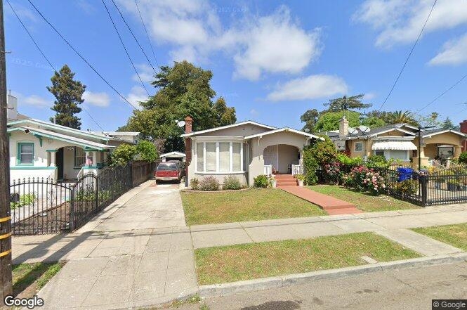

1920’s was a building boom in the SF East Bay with tree lined streets, sidewalks and variations on the classic Craftsman Bungalow style.
All these home built with a 30 amp main feeding a 2 fuse sub panel with a 20 amp plug circuit and a 15 amp light circuit.
The mild climate of SF Bay Area requires no A/C and many homes have the optional 20,000 BTU floor furnace.
I own several and never had a single electrical issue because everything producing heat is natural gas.
The 60 amp 240 volt panels didn’t start until the 1946-48 post war boom.
The upscale 2500 square feet homes of the late 1950’s have 125amp 240 panels of the infamous Federal Pacific Brand.
My 2500 square foot home averages 9 kWH use per day all year…
When A/C isn’t typical and natural gas is… the need for large electric service isn’t.
