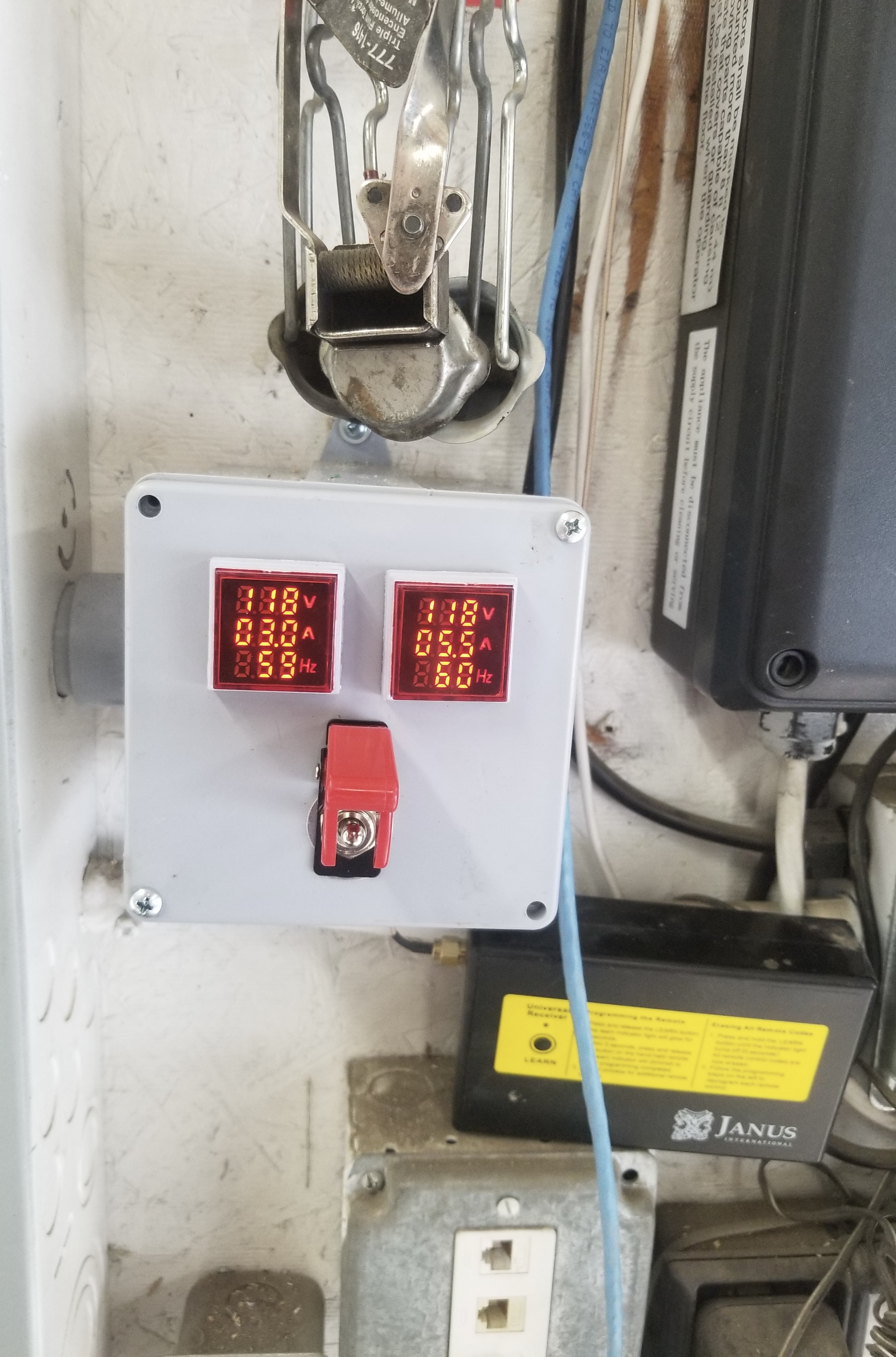

Tested the power meter this morning. Works fine showing W, A, F. Even catches the surges. Interesting to see how actual W are different from tables provided. One thing I can't explain... My generator is running with low load-about 60w. Turning on ceiling fan and see 2w. Tried a few times.
How can it be? Any thoughts?
Watts will be calculated off of measurement volts, and amps.
The question is …. How many current donuts does it use? Can you switch the amp display to show each leg individually?
You can have leg 1 to neutral current.
You can have leg 2 to neutral current.
You can have leg 1 to leg 2 current.
The advertised photo only shows 1 current donut🤔
I don’t know how they can give correct 120v amp readings for both legs, without a second donut to account for the neutral current.

Did it come with a manual that explains what current path the amp display is actually displaying?
Running 2 of the wrong wires through a single current donut can cause an increase in load to incorrectly read as a decrease because of cancellation. Hopefully you don’t have that going on

They can run the two legs in opposite directions through the inductive loop, in order that they add despite being out of phase. But I agree, one ammeter on a two-leg system with split voltage leaves enormous room for ambiguity. I'm surprised there aren't two ammeters, one for each leg. Neutral current would be difference in two leg readings.

Problem with that setup, is the amp reading will only be correct for L1 to L2 flow. It’s totally wrong for 120v circuits.
Example:
1 amp flows L1 to L2. Meter “sees” 2 amps because of double wires through the donut.
1 amp flows through L1 to N meter only “”sees” 1 amp.
So first, the amp measurement is unreliable because the meter doesn’t know if the current to display should be as measured, or divided by 2.
Second, the meter’s wattage logic doesn’t know if the amp # should be 1/2, or a portion of 100% number to use based on the neutral current flow imbalance caused by the 120v circuit’s flow, that it is unaware of.

Yep. Not a great setup, but really the only solution for a single meter on a split voltage system. It would at least show total current flow, with the overcurrent devices still being the only means of tripping an individual leg overcurrent.
Agreed. Although unless wattmeter is actually accounting for power factor, it's mostly a useless frill feature, anyway.
Best would be two ammeters, one for each leg.

Not sure what it all means. To clarify, the voltage reading on power meter is ~120 volts all the time. Does it mean wattage I see is half of actual? The generator screen shows 240 v. How can turning on a ceiling fan can reduce total watts? And this is the only one appliance that does it.

All speculation till you post the schematic, or description of the amp/ watt screen from your owners manual

Not sure how yours is setup. Mine has 2 separate meters and 2 separate CT’S set to read both phases. Mine reads Volts, Amps and frequency

It's mostly likely just an artifact of imbalance, sign of a floating neutral. It'd be interesting to see the neutral to ground voltage under both scenarios.
There's also a small chance it's the result of an auto-ranging meter with badly-differing resolution at two different amperage levels, such that one reading is just badly erroneous, but I really doubt that's the case.
