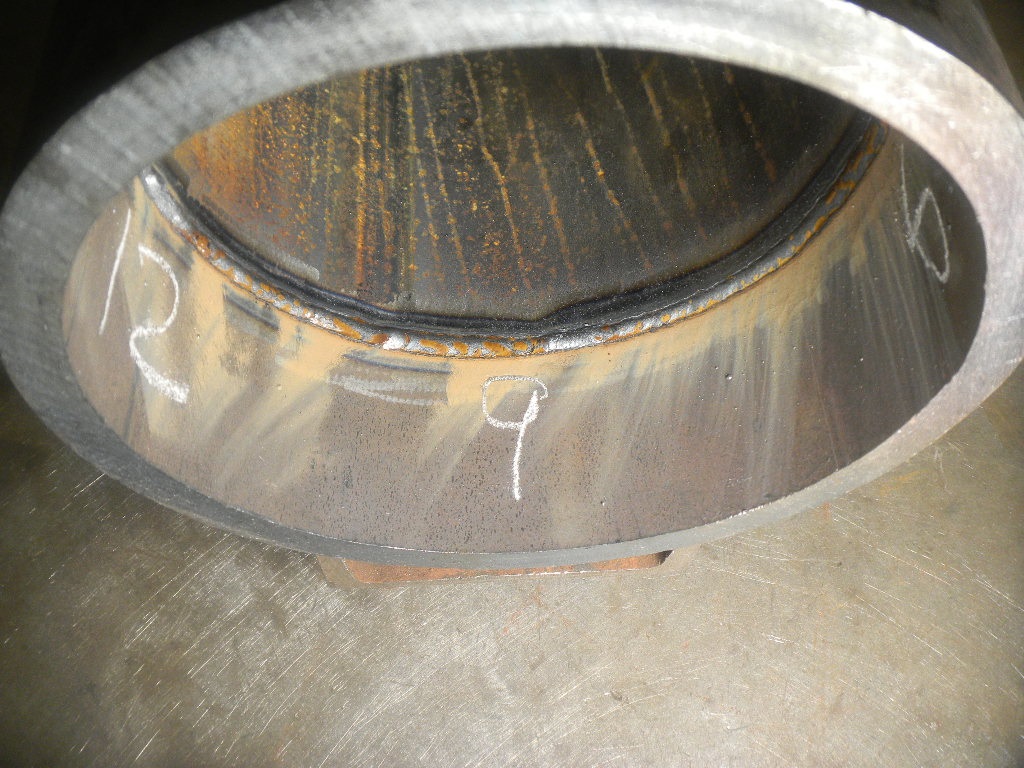

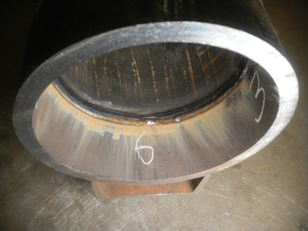

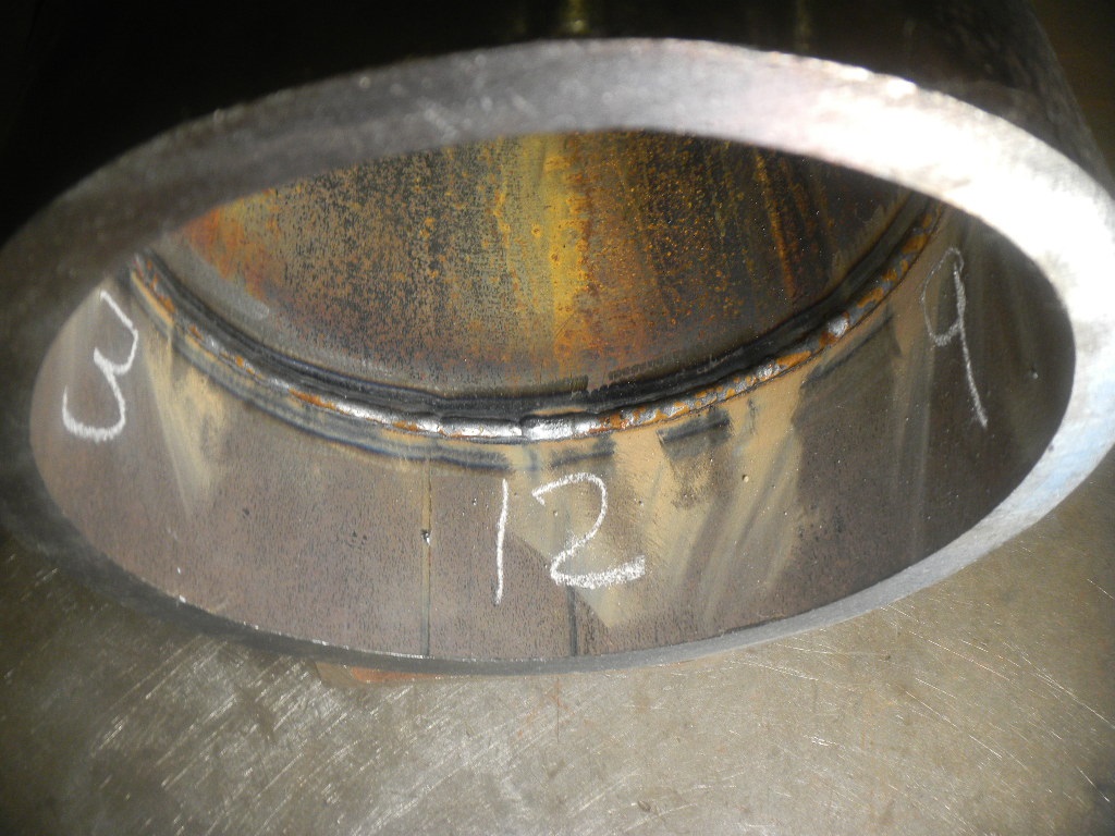

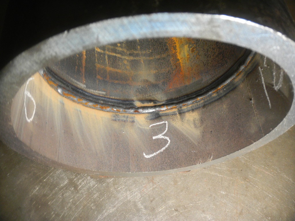

Getting a little better with my tie ins to the tack welds.

   / Question for pipe welders. #25
Carl, that looks almost perfect. Are you grinding out the tacks first? When we were doing certified work, especially x-ray tested, that was always a requirement. Of course that was SS, not mild steel.
#26
No Ron, I leave the tacks in place. But I take a die grinder with a 1/16-inch thick disc. I feather / ramp each end of the tack. What I found that is helping, is I move the Tig torch up and down when I run up on a tack. Same thing when I start on a tack.

Thanks Dave!;) Maybe one of these days, I'll learn how to take a good picture inside a pipe!:rolleyes:

I don't think it would pass common arc visual
