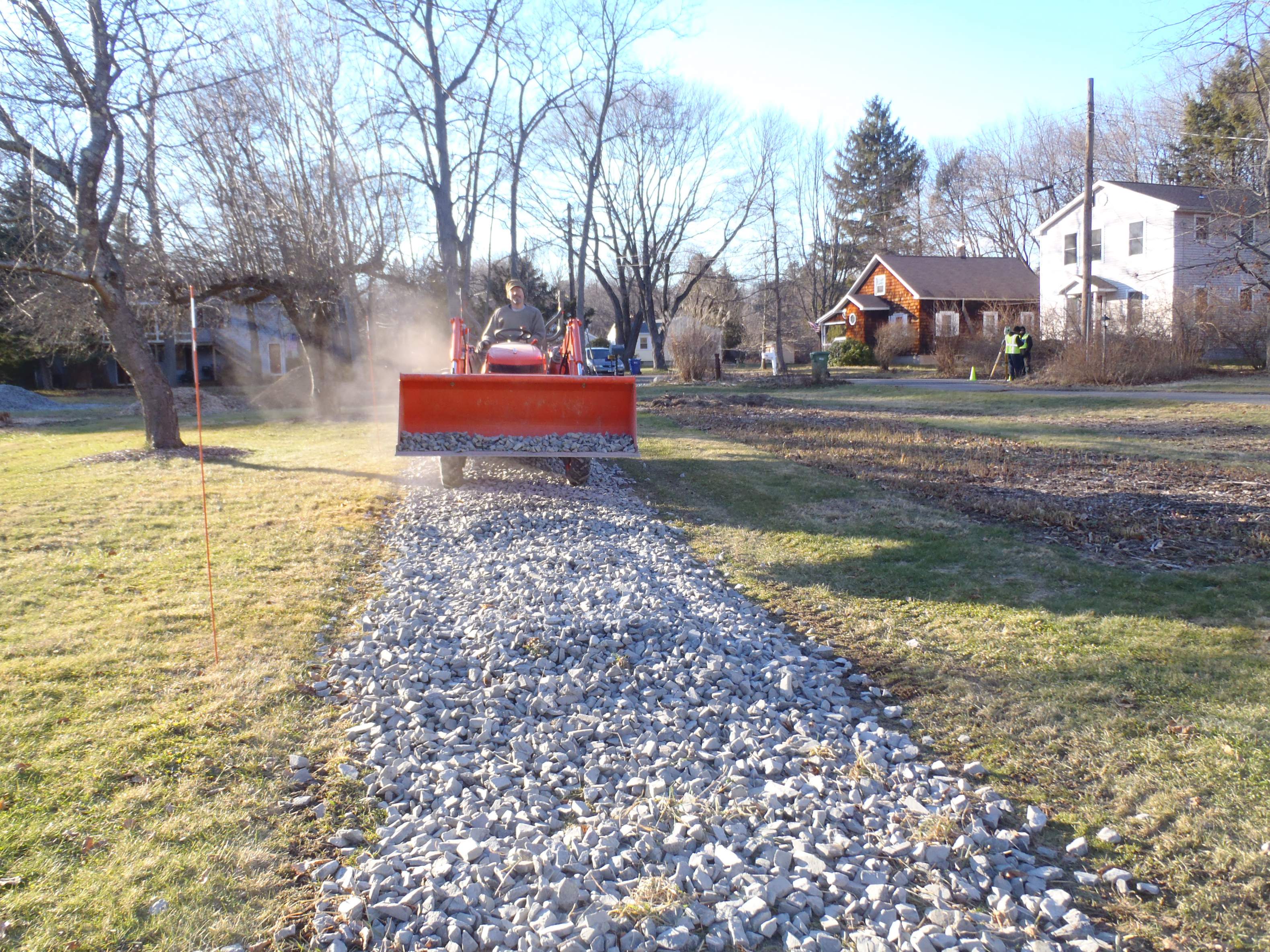

I just spread a tri-ax load (44,700 lbs) of ASTM #3 (2") down to stabilize a high clay area that gets soupy in wet weather.
Hoping the freeze/thaw of winter and frequent driving over it will help pack it in.
I'm pretty sure it's going to take additional filling and raking each time we get a thaw and the gravel sinks in.
About 1/4 of the stone remains in the pile to be used as filler for any low spots that form.
That looks like limestone. IF in fact it is, you should wet it down and then roll the he!! out of it. It will harden right up.

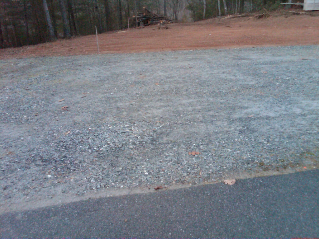

I have a asphalt driveway and large asphalt pad but added a large gravel pad beside the asphalt. If your ground is as hard as mine the crusher run by its self would work fine. Save a few $$ also. But if he ground is soft you may need the larger washed stone first.
My crusher run pad is several inches thick and I packed it with the F250:D. I had it put down 2010 and had no issues. I have had several tandem trucks on it with no movement. It has held up great, smooth and hard.
I did box blade it and re-packed it over the summer just because of the dead weeds and grass from the round-up. You know crusher run has fertilizer and weed/grass seed in it:D :laughing: I am thinking about spreading some on my yard where the grass won't grow!!
If I can get home before dark I will snap a picture of the pad.
Bingo! Here's a man in at least the same state! These things are regional, to say the least, and actually very local. I'm sure that there are big differences between the western Mtns. and the piedmont. The only thing I can add from afar is bigger stone first then top it with smaller stone with fines to "lock" the surface together.
edit; get your drainage right before anything. It's the most important part of it all:thumbsup:

I know you have already decided...but I did take pictures last night so I will post them just for the heck of it.:D
The pad is in a "L" shape so the picture only shows part of the pad.
In the back ground you can see the grading being done for my pole barn/workshop. I have taken 28 trees down since Thanksgiving, still needs a little more grading and a few stumps removed.

That looks great. My only concern with just crush and run is unless I lay it on crazy thick, I'll lose some of it mud. I've got a good bit of red clay where I'm putting it down and I'm thinking I might need the #3 for stability on the base.
