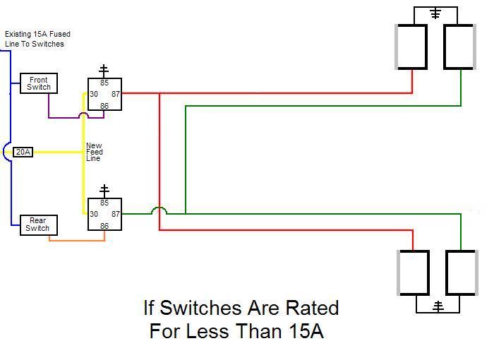

RFB said:
If I have to use relays, do you have a suggested type/model and vendor?
Any basic Bosch-type relay will work. You can get them at any automotive stores. Some carry the molded male multiplug/pigtail, but that can be hard to find. Shielded spade connectors would work fine, too. If you go the relay route, I made a wiring diagram for you below. The new feed line would be wired directly to the battery.
I don't blame you for changing them. Crappy lighting is worse than no lighting...

bjcsc,
Thank you very much for the drawing. Not trying to be intentionally obtuse, but I am trying to understand the legend.
I see the power coming to switches and relays. I see the existing common chassis ground. Is there a typo/missing connection on the rear switch green line?
Also, if (big if) there is an open/unused position in the fuse block, can that be the power source or is that what you meant by "directly to the battery".

   / Question for the tractor electricians #24
RFB said:
bjcsc,

   / Question for the tractor electricians #25
Yeah, I forgot to finish drawing it. I fixed it.
If you get lucky enough to find an opening in the fuse block (it's possible as cab tractors often have lots of electrical doo-dads as options) you could certainly go from there with a 20A fuse. You're right, by "directly to the battery" I was speaking more of path vs. literally (but the latter is often necessary)...
   / Question for the tractor electricians #26
bjcsc, I don't know if the switches are in series or parallel, but it does not matter. In a correctly designed circuit anything down stream from a fuse should be protected by that fuse. As an example, outlets in your house should be on a 15 amp breaker. There may be 12 or 15 outlets, in parallel, on that circuit and they are all rated at 15 amps. Looking at your drawing it looks fine except you still need 15 amp switches. If for example you developer a short to ground on the orange wire coming out of the rear switch, if the switch is not rated for 15amps it will fry before the fuse can protect it.

   / Question for the tractor electricians #30
I completely agree with both you and RFB that that is the way it should be. But, we are assuming that Kubota cares about protecting the switch. In some 12V wiring I've dealt with, on some boats I've worked on for example, the switches were rated for the load and not protected by the fuse from a hard ground. They were essentially set up to be "consumable" in the case of a hard ground. In no way do I view that as correct, but that's how it was factory wired. AC outlets have to be rated so the entire load can be carried by any one of them. Kubota would not have the same expectation of one of those switches, unless they're in series. You're correct about a hard ground on the orange wire, but again that diagram assumes the switches are not rated for 15A to begin with and are subject to "frying" from a hard ground as delivered from Kubota.
I think we're all on the same page:
Is it reasonable to assume that the switches are/should be rated for 15A? Yes
Do we know that for sure? No
If I was RFB, I would try to research the switch and see what I could find about it: rating, price, availability. If they're rated for 15A, I'd just replace the fixtures with the new and leave everything else as is. If I couldn't find the rating, but the switches were cheap and easy to get/replace, I'd do the same thing and check them as SPYDERLK mentioned. If they failed the check, then I'd wire them with relays as in my diagram.
