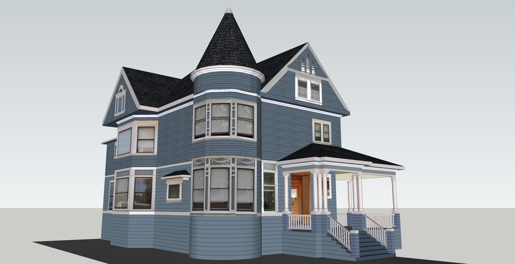

A slight Engineering question if I may.. How are you going to support the walls as you dig under them and tear out the old wall and add the extra height??
First dig a trench along the outside but not to the extent that it under cuts the existing foundation. Put down a temporary mud sill. On the mud sill build a temporary post and beam support that will carry sistered up extensions of the floor joists. Second dig on the inside down to the level that I need to go, build a second temp wall to support the floor. Now remove the old wall and dig down, frame up for the new foundation and pour. that leaving out a lot of detail but should give a rough idea.
I plan to do sections at a time. Maybe 6 or 8 sections in all

On having riggers/house movers lift the building and going at it full tilt, yes of course I've thought that through. To begin with the building is fully rented. It's a 130 year old Victorian in excellent condition (except for the foundation). If I have it lifted and all the foundation removed I would have to have everyone move out. The loss of rent will add up really fast. So it would make most sense in that case to just let them go full bore and finish it as fast as possible. And THAT IS expensive. There is a house mover that we have dealt with before that moved a house for my father, great people to do business with, the only ones I would consider working with. Cost for them to do what I want done, somewhere around 100K. There is a lot more to this but I'm not good at writing. (slow)
Also it's a designated historic building in an historic district and is under very strict architectural guidelines. Therefore I can't raise it. I can't do anything to change the look of it at all. Don't want to anyway.
As I mentioned, the plan I'm considering is to go at it a section at a time. There would be no risk of the building falling.
About the rain - this is California, after April - May, what little rain we might get would probably barely be enough to keep the dust down.

To be more exact. 896 square ft needs to go down 5 ft and the other area 608 square ft needs to go down 1.5 ft. I get 200 yards of dirt to be removed.
If this building were out in the country this would all be a piece of cake The 3D Sketchup model that I submitted might be a little deceiving, it gives the impression of lots of room all around. In reality there is little room to work with. On the side of the building with the round turret, the turret is 2 ft from the property line. On the other side, the driveway, there is 9 ft. anything 10 wide trying to move down the driveway would be gouging both buildings. My dump trailer is just under 8ft wide outside of tire to outside of tire, 94 inches to be exact. Try backing a trailer down a 70ft drive with 7in of clearance on both sides assuming you're perfectly centered. The working space behind the building is 36 x 46 max. Parking on the street is hit and miss. Sometimes you can't park on the street at all or maybe a couple of hundred feet away. If you need to park a big truck, plan on blocking off the area the night before. Move your truck and you'll be lucky if the space is still there in a half hour
To dig a ramp would require removing a section of concrete paved parking area, what ever size of the ramp
The 100k wasn't just to lift the building, that would be the complete job lift dig and remove the dirt, form it up and pour. But even that was just a ball park number.
Also you need to know that this is the center of Silicon Valley. Everything is more expensive here.
