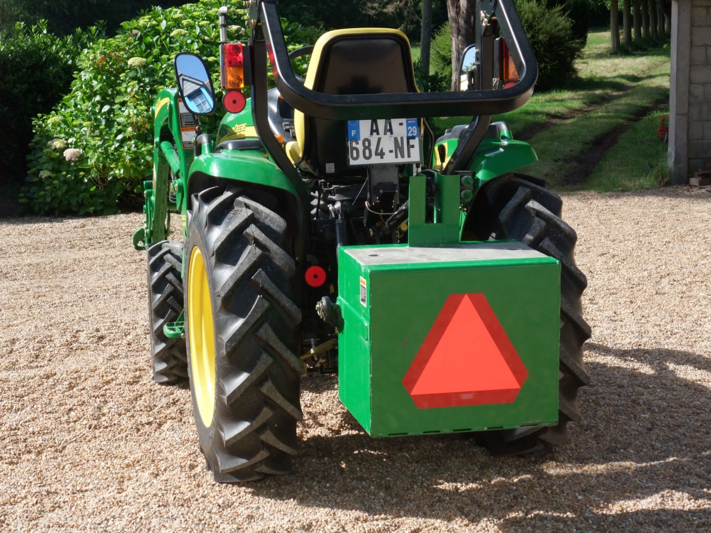

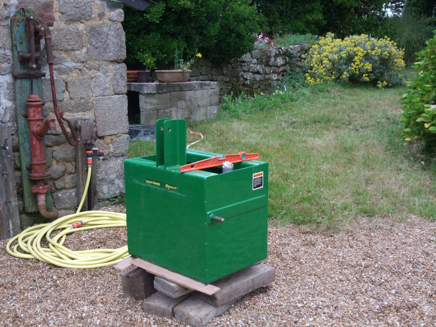

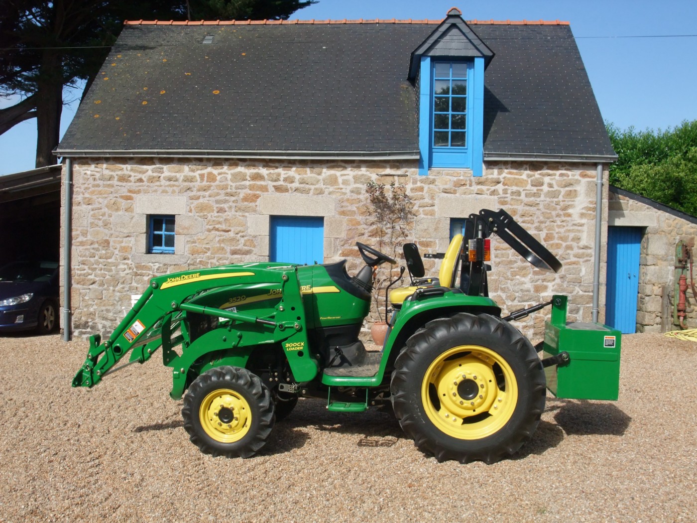

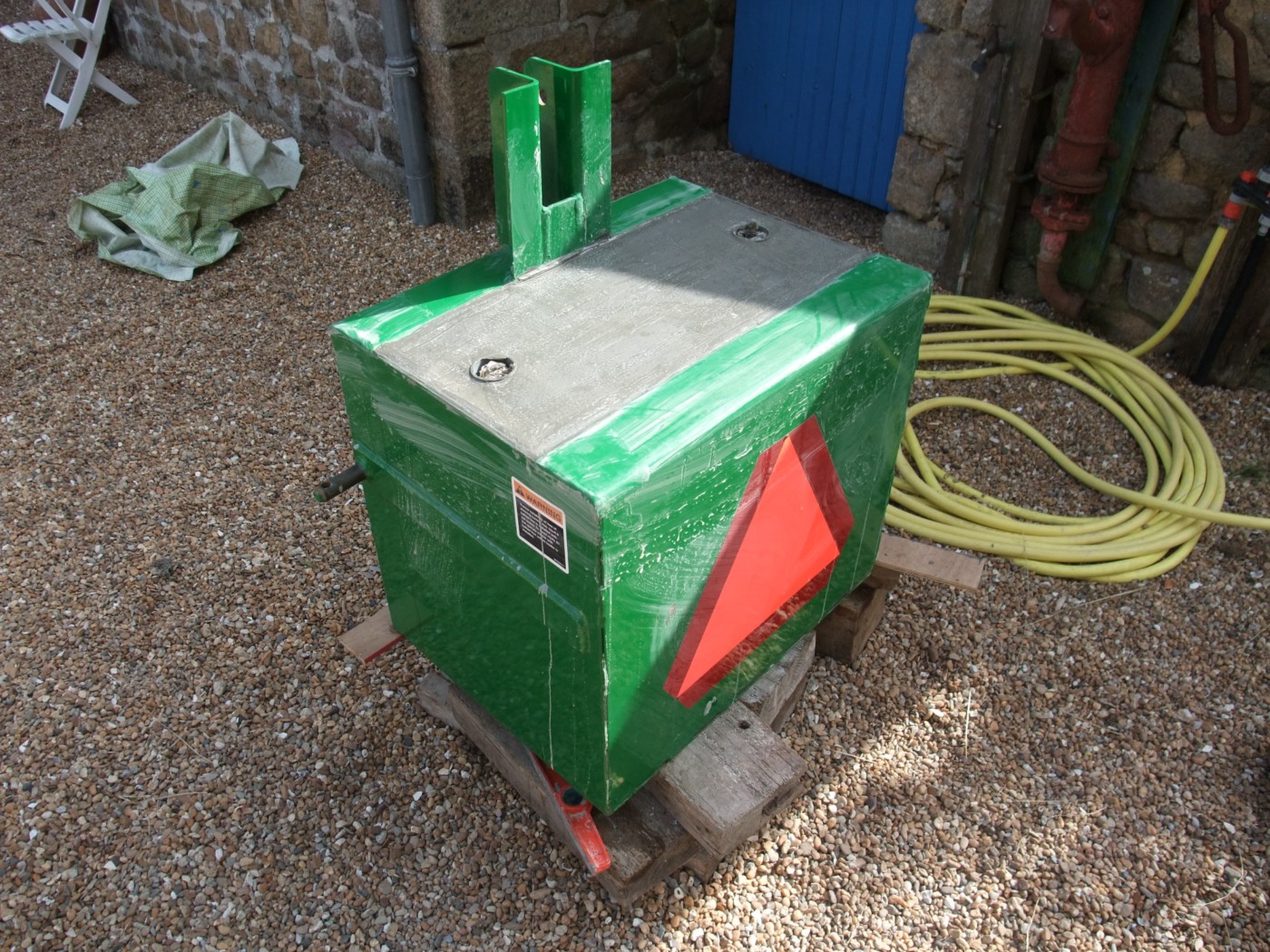

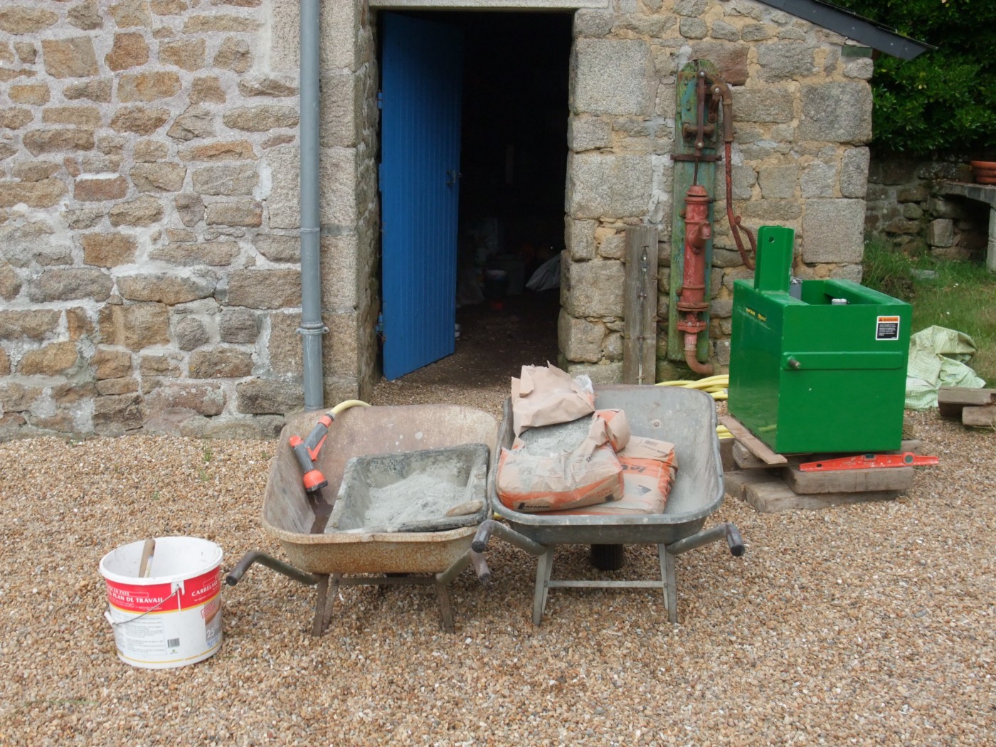

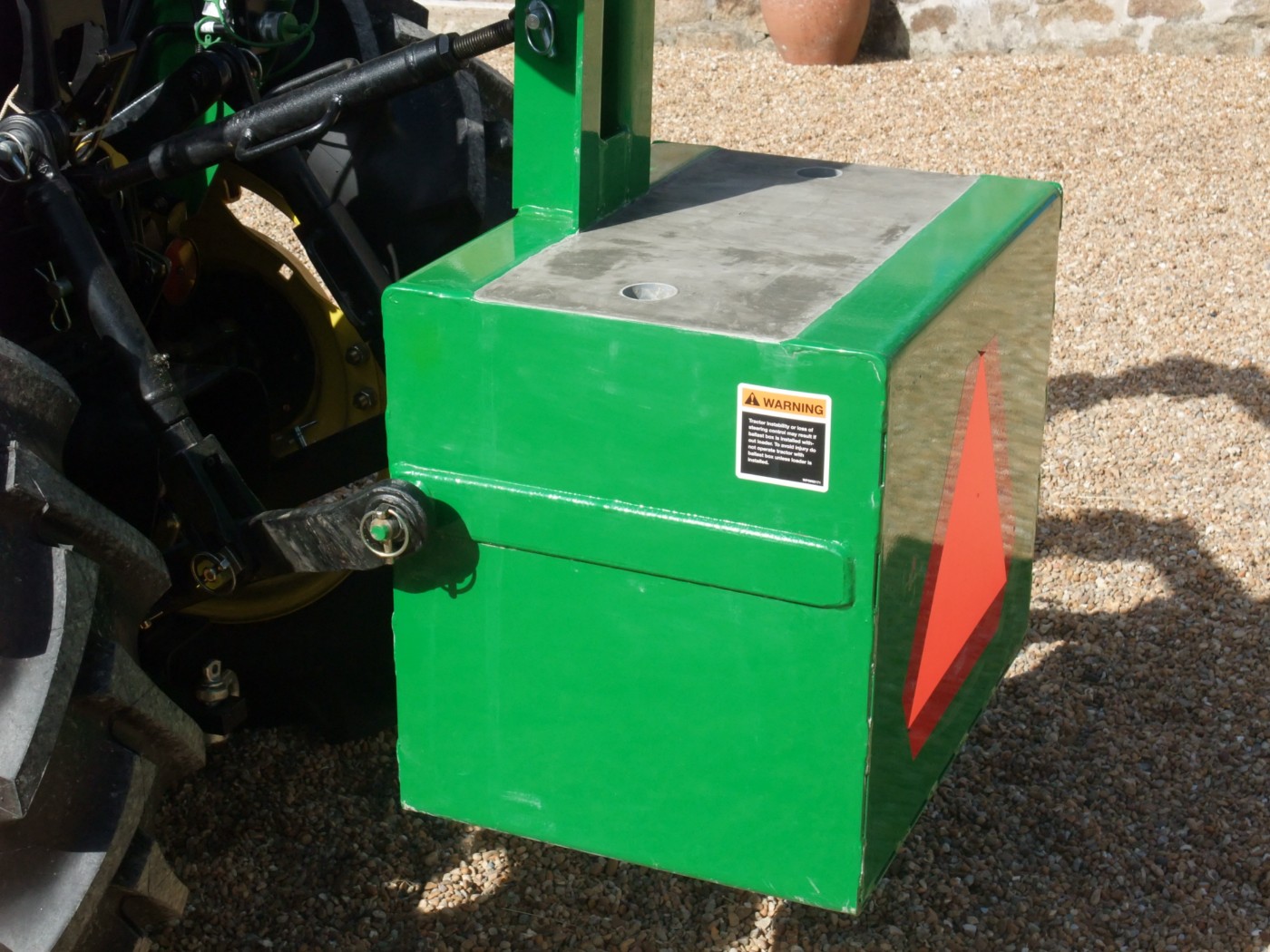

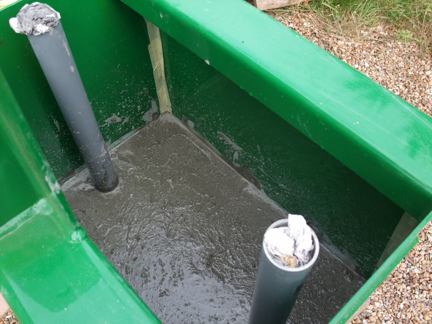

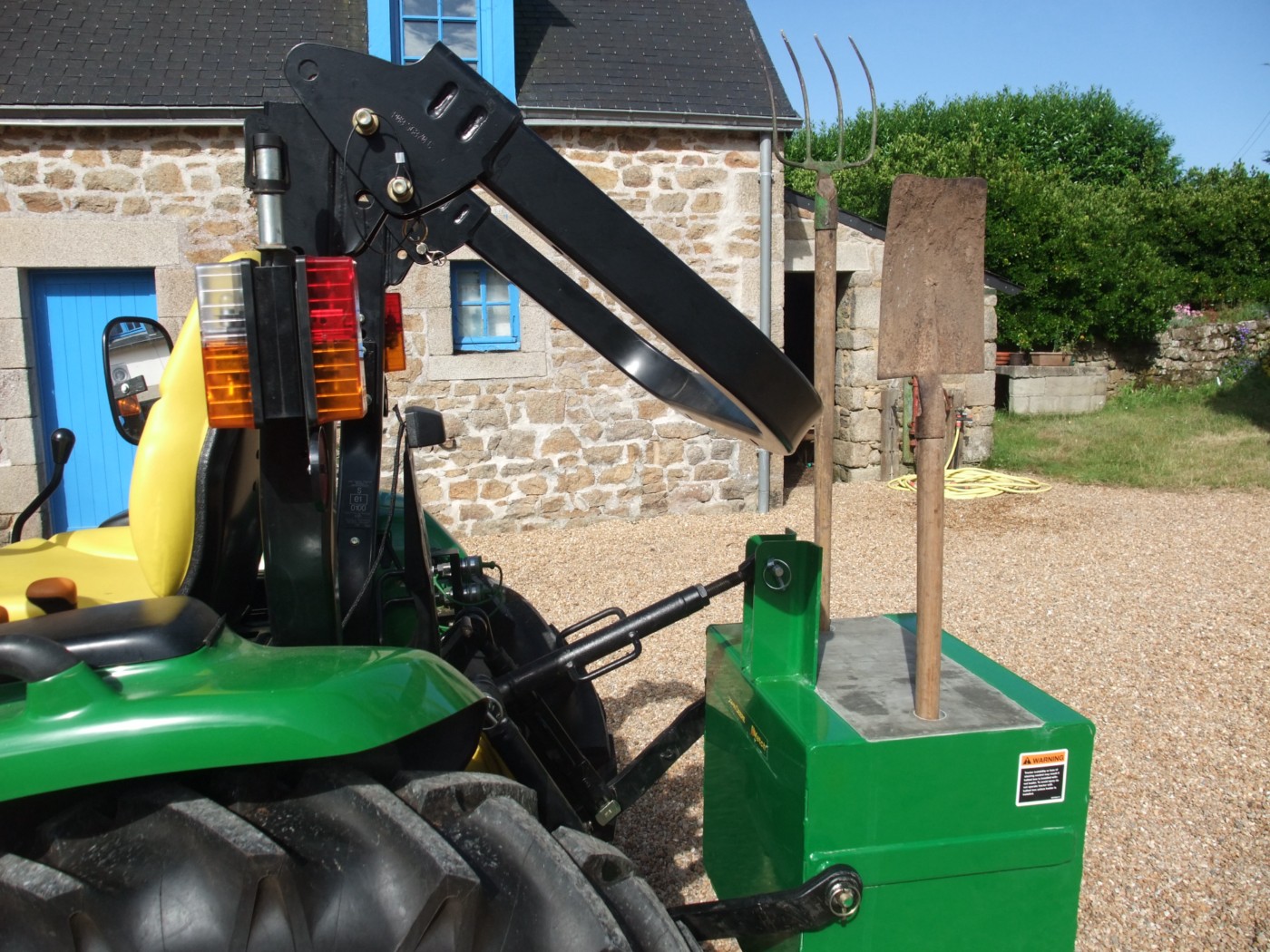

Of course sand or stone allow you to vary the weight. I have never found that very useful and if you use concrete you can forget about it once dried. I left two holes at the bottom for drainage, which helped hold the plastic tubes when pouring the concrete.

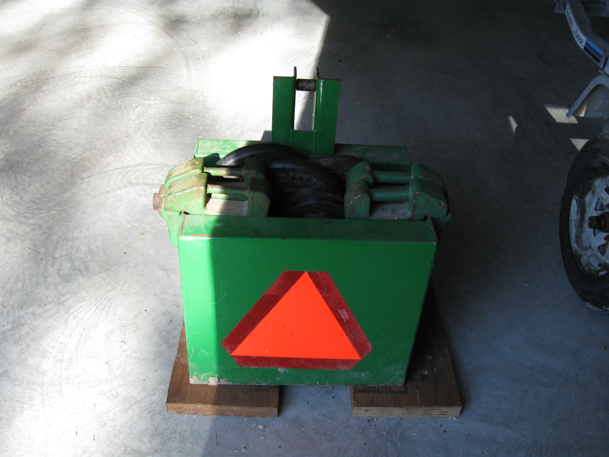

ANOTHER THOUGHT; a pile of old free weights.
