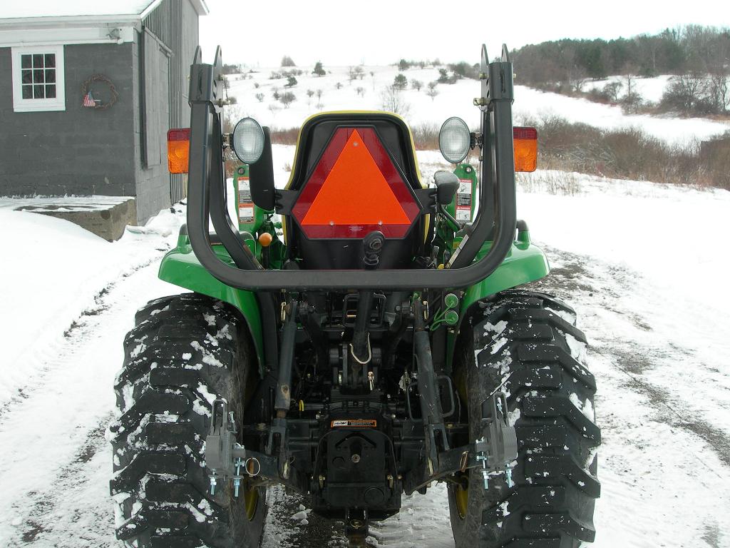

Here you go Beavis:
Lights on my 3320
   / question on lights for 3520 #12
Looks good--what I have on mine is similar--2 lights. I have the brush guards on the hazard lights (metal bracket) and have the work lights mounted to a magnetic base, which then mounts on the hazard bracket, usually keep one facing forward and one back, but it is really easy to swing them around if you want them facing in the same direction. The wires under the seat had the extra plugs in them so I wired the 2 lights together and then pigtailed them to these "extra" plugs so that I can plug them in very quickly, don't have the wires permanently installed as I mostly need them in the winter.

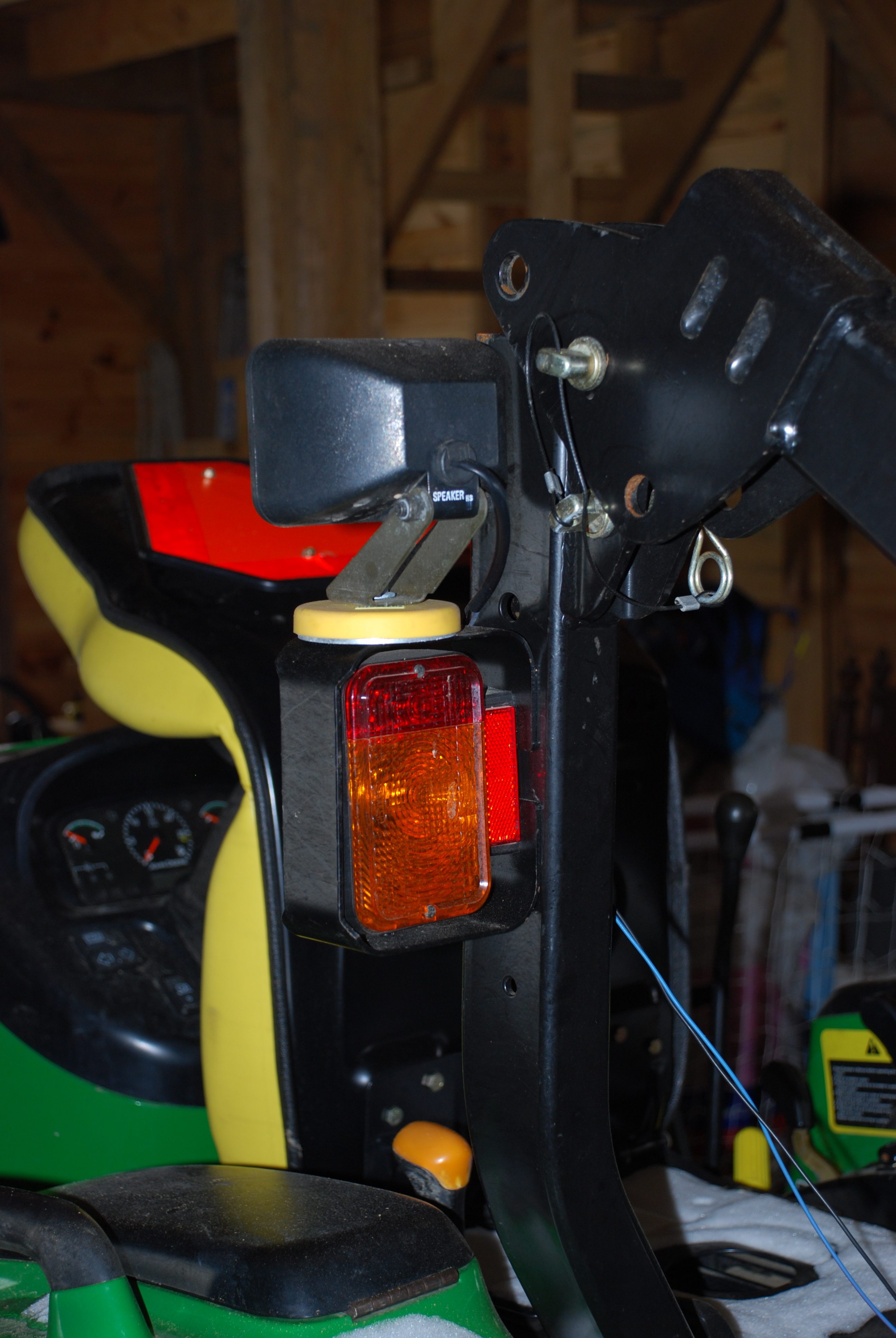

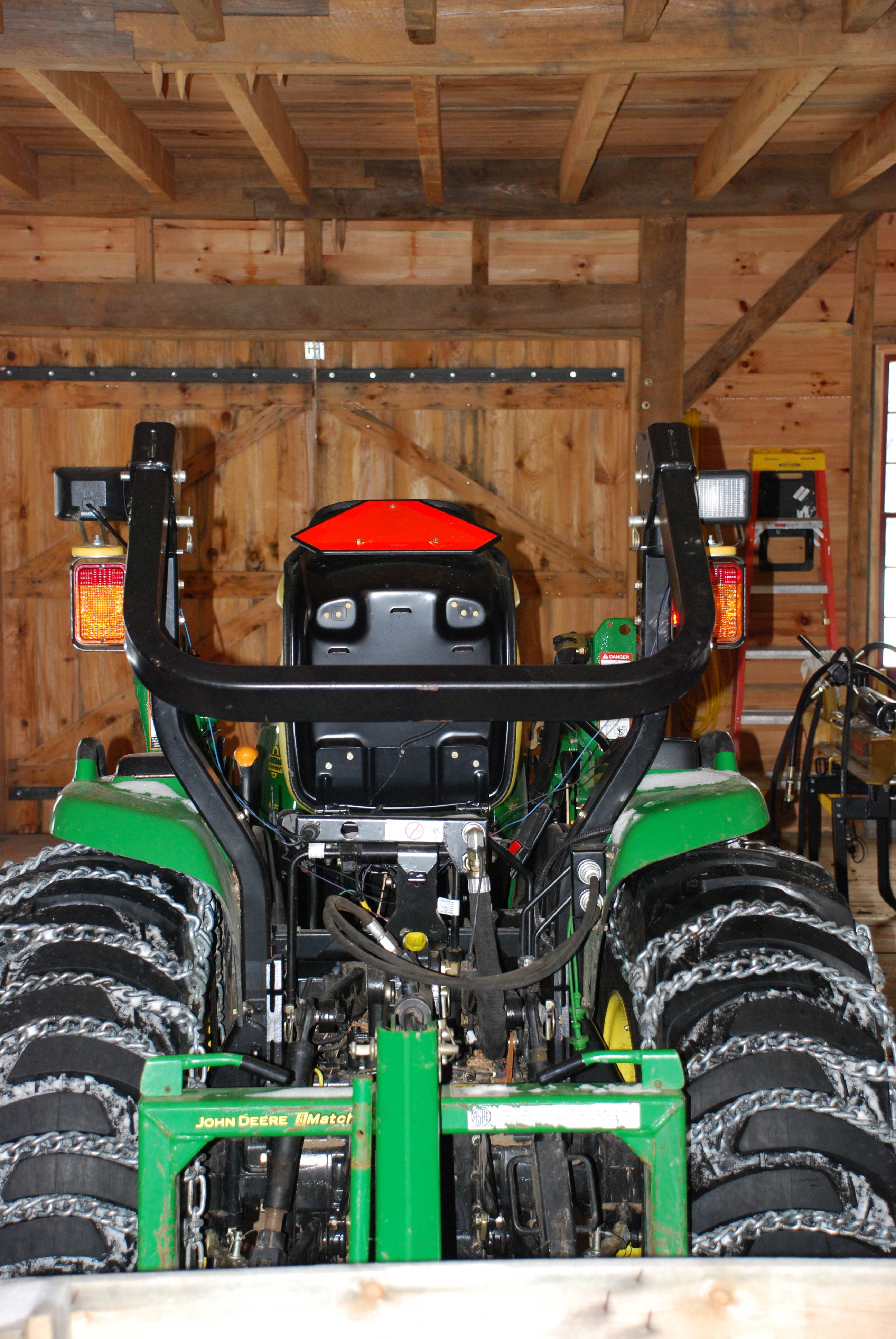

Some pics of what I have.
   / question on lights for 3520 #15
   / question on lights for 3520 #17
close-up of one side
   / question on lights for 3520 #18
Thanks, what are the yellow disks on top of the factory light?
   / question on lights for 3520 #19
The yellow disks are the magnets--allows me to face the light either forward or backwards.
   / question on lights for 3520 #20
Im sorry if I missed that before, but that is one of the best ideas I have read. Even if mounting them higher on the bar, with hd magnets, they are always adjustable.... Great idea.
