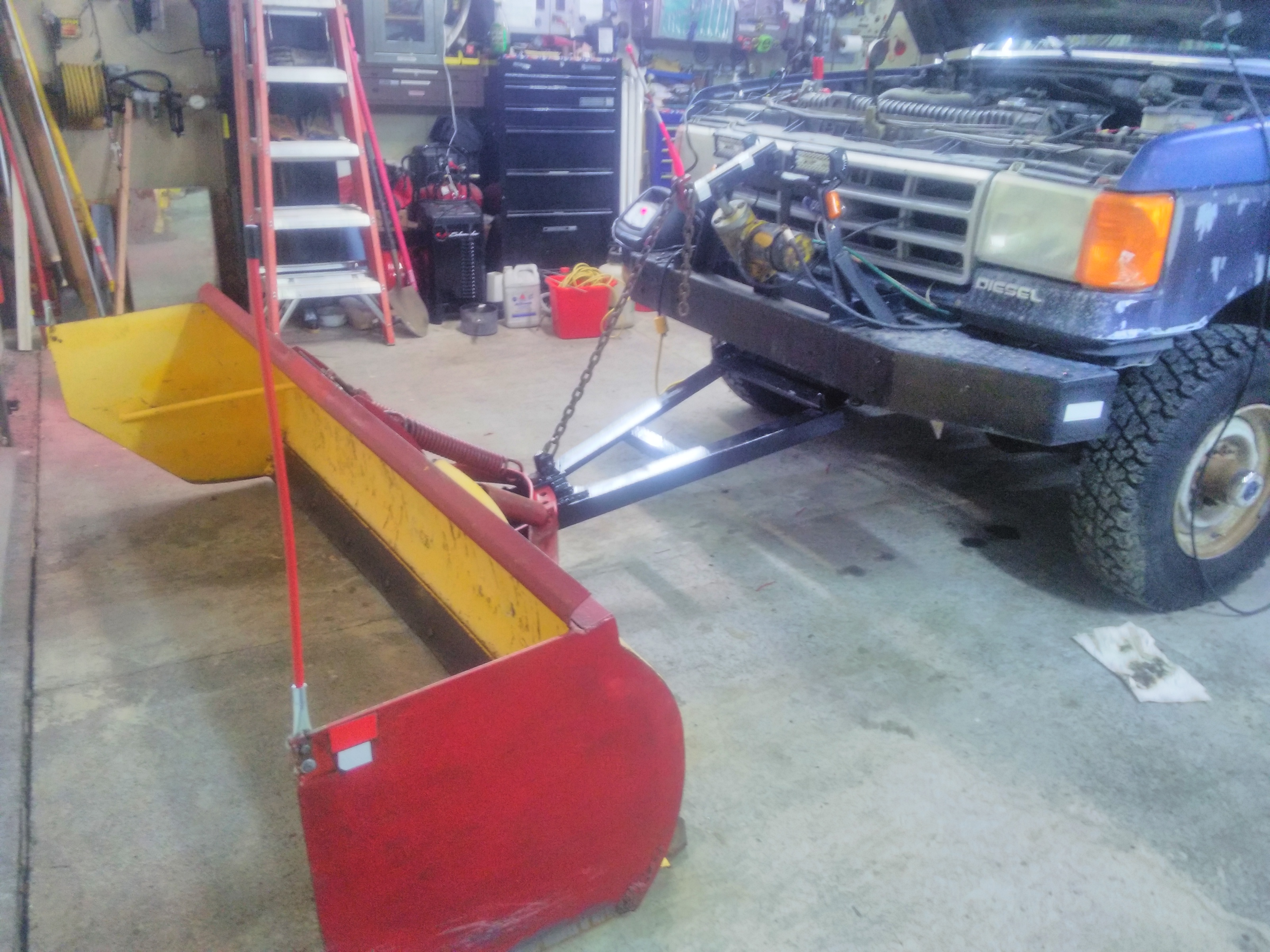

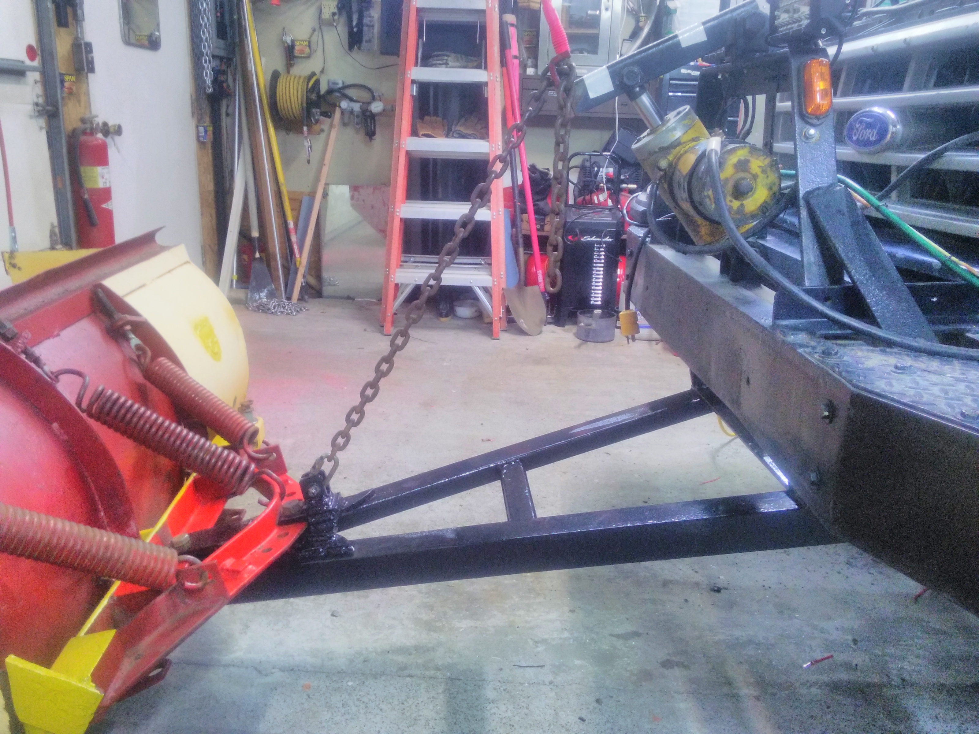

Any Mechanical Engineers or Math Wizards here to answer a question? I rebuilt my Snowplow A-Frame and made it one foot longer than it was, hoping to get a better angle. Question: Is the Lift chain at to great of an angle to the pump? Would a straighter lift, say to the center cross brace be less stress? Thanks for any insight.

Stress, as in internal forces and moments constrained within a material will be higher but probably well within the yield (strain) boundary of the metal. What you've lost is the displacement range (won't lift as high because of angle). So, put another eyebolt and the central crossmember and get it back Stress ought to be just fine.
The problem you face withe the extra length is steering. Any side-force on the plow times the increased moment arm distance means it must be counteracted by the front AND rear tires. If nothing there changes, you will have a harder time driving straight (or more correctly going where you want to go.)

Yeah, I would try it at the center cross brace as it is more of a straight pull for the lift arm. Yes, your plow is further out front and will take more pressure to lift it but it should do fine. It wouldn't take much to do a simple test.

Thank You for the insight. That Beast goes where you point it. F-350 Crew Cab Diesel with chains on the rear. Only problem is that the overall length is 27'-6". Glad I just do mine and a couple of neighbors and no real congested areas to plow.
Would there be any advantage to tying the front chain to the middle chain for the Lift? I would increase my blade lift some and also take some of the stress off of were the blade mounts. This is a Straight Push only, no angling.

Maybe you could extend the tube steel at where the top of your chain connects to regain your original lifting angle.

Why was the A-arm lengthened?
Moving the chain back would mean less stress on the chain and higher lifting height, but the pump might not lift it. Those meyer pumps are rated to lift the plow as designed and not much more. get some snow built up and packed on the blade and they struggle.
Just off the cuff, by moving the chain point back you will need roughly twice the hydraulic force to lift the plow....which I think it will struggle if it will do it at all.
And your a-frame angle is less than desirable. I hope you never plan on angling that plow, cause I dont think you will like what you see

You are going to get less lift, and you have increased the load. To get the lift back you need to extend the lift arm, but that will also increase lift load, but that pump looks healthy.

The mount points on the truck are to high and the angle was to sharp with the shorter A-Frame. The trip springs had to be tightened to the max to get the plow flat to the ground.
The welds broke on the cross support of the old A-Frame and I managed to twist everything in to a pretzel. The only thing salvageable was the front chain point and rear truck mount point. With the a-Frame 12" longer, I can loosen the trip springs up some and still have the plow sit flat.
Oh, that angle.....:confused3: Yeah, that set-up ain't right...:thumbsdown:

Why did you lengthen it? And your mount doesn’t look very heavy duty. The first fixed object you hit it’s done for.

I lengthened it where the plow would sit more level on the ground. The original was 1/2" angle, this one is 3/8". Hopefully, it will survive.

It's easy to jump in after the fact, but is there a reason you didn't drop the mounting point on the truck?

Yes. Not registered or tagged. This truck is only used for plowing us and 2 or 3 neighbors. I only have a Hobart Handler 140 wire feed welder which is a little to light duty for this purpose. A professional welder built my new A-Frame and his shop was 30 miles away.
/ Questioning Lift Angle #16
Lowing the mount on the truck, or raising the pin points on the plow, or a combination of both. All preferred methods over lengthening the a-frame.
The farther the plow is out front, the more stress there is in everything due to lots more leverage
And that downhill angle.....as you are plowing, you are trying to lift the whole front of the truck
