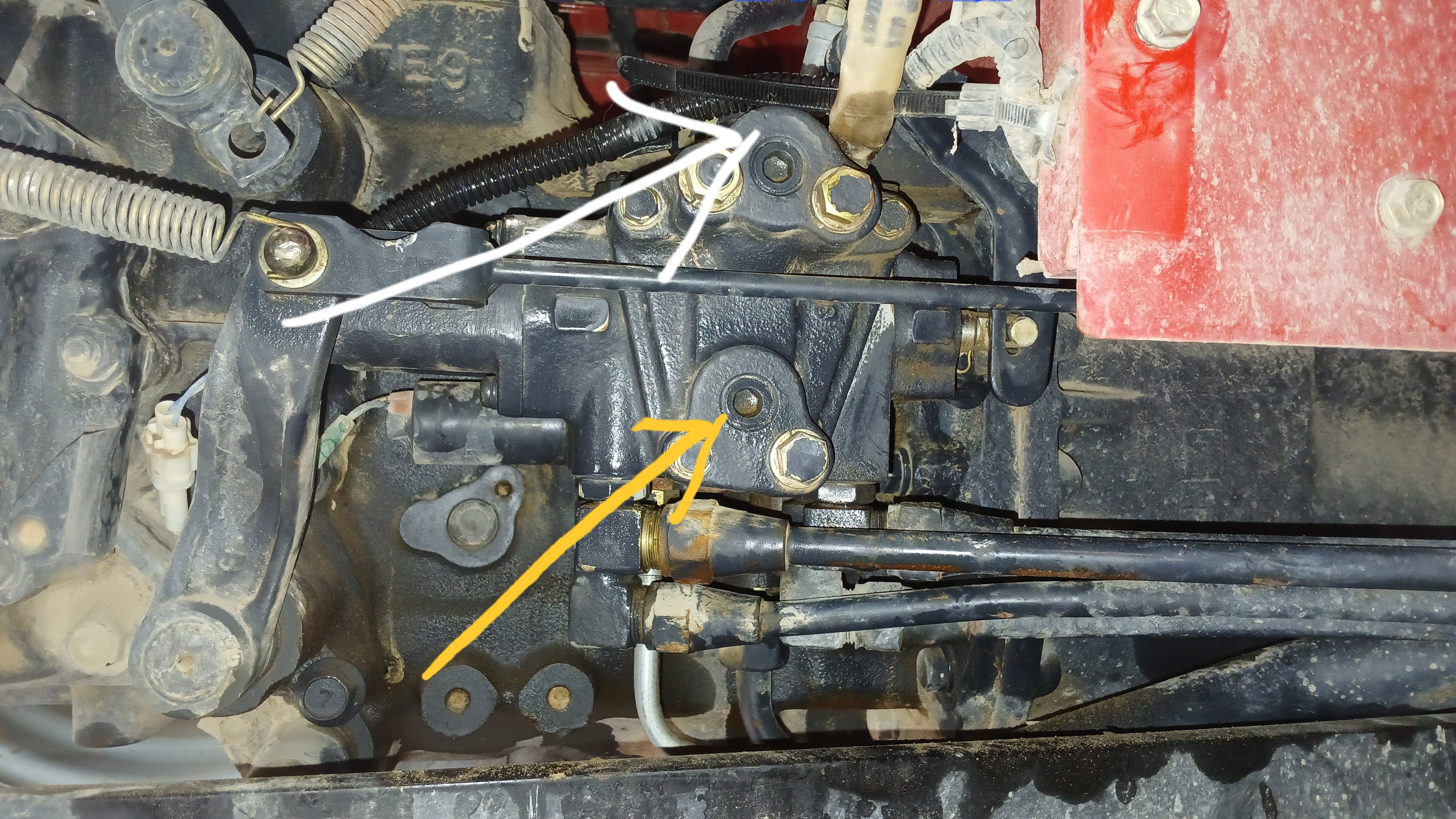

Are you talking about this plug? Thus picture is from the top side of the last picture you posted.
That’s the sump port for the third hose. I couldn’t see it in your other photo. So you have all 3 ports identified 👍🏻
It’s not the hex plug that gets replaced with a diverter plug, that I mentioned though. That should be directly on top of the return port casting, pointing downward

It’s not the hex plug that gets replaced with a diverter plug, that I mentioned though. That should be directly on top of the return port casting, pointing dodownward
Here is what I believe you are talking about circled in red. It's a hex capped pointing downward. The white is the return line flush allen head port.
Do I need a diverter plug in it if I'm not using it in a "rear remotes" setup and just using it as a "power beyond" style?

OK so if I understand the diverter plugs purpose. The cap that is there should alow for flow to that plug. (And give me power beyond, or "constant pressure") If I use a diverter plug it would be for a "third function" and would shut off the use of 1 of the loader functions. And diverter it to the 3rd function until I swap it back.
As I previously mentioned, I don’t know how the machine would operate without it. I don’t recall its exact shape either, so I don’t know if it’s actually diverting return flow from passageways internally vertically or horizontally for some reason , or if it’s only for restricting flow. I doubt you can buy it, and I doubt anyone has a dimensional diagram of it either.

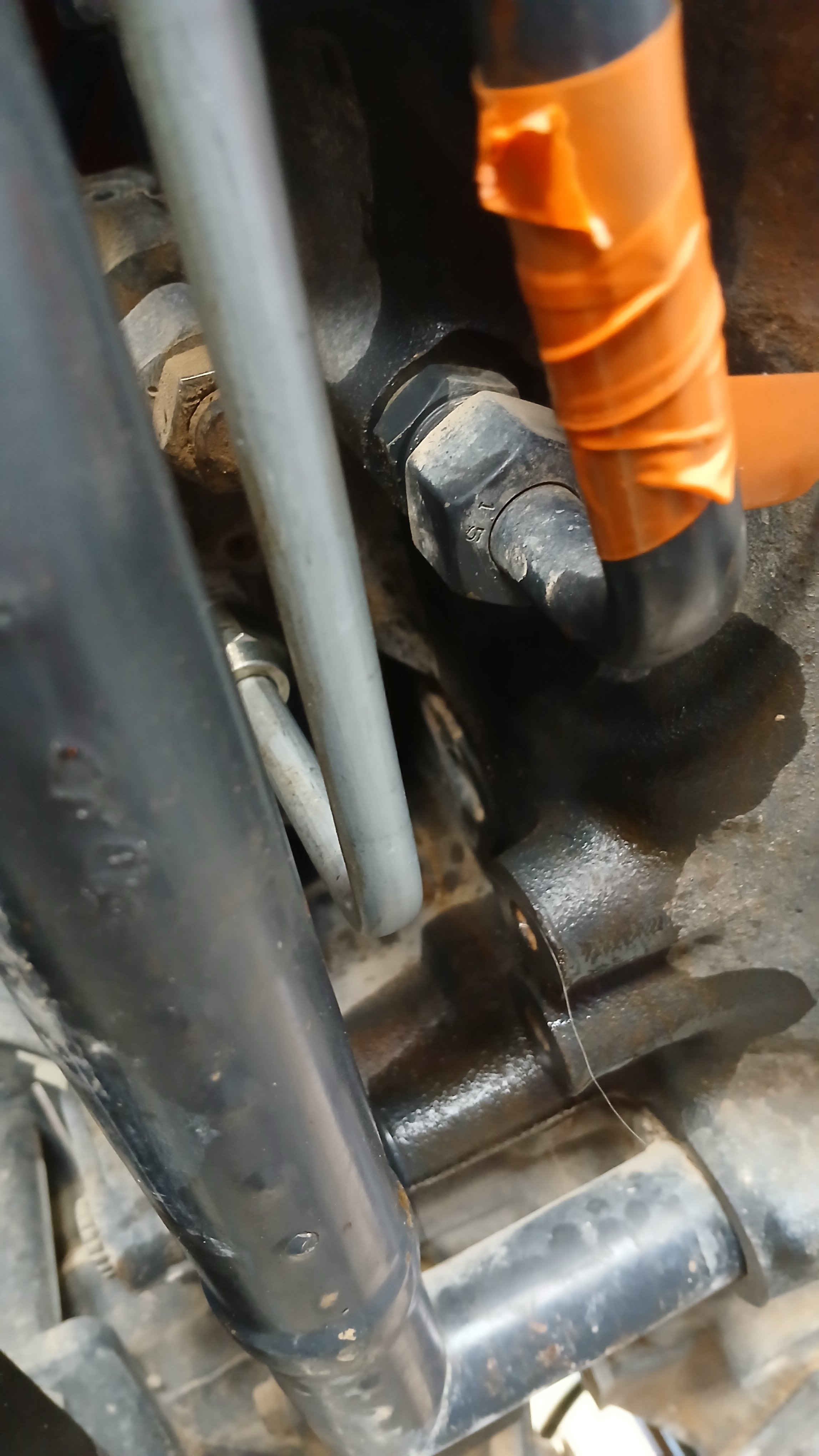

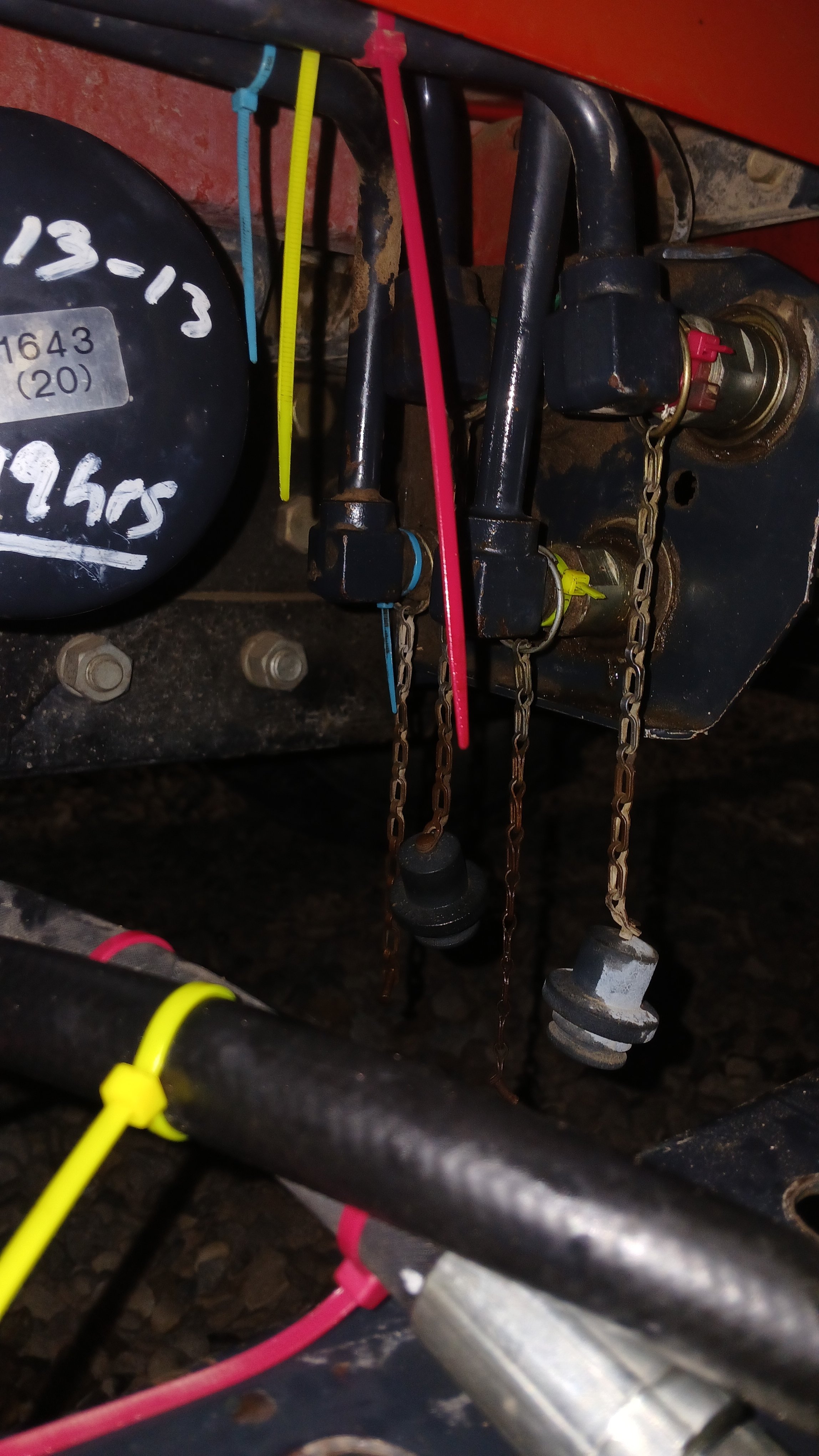

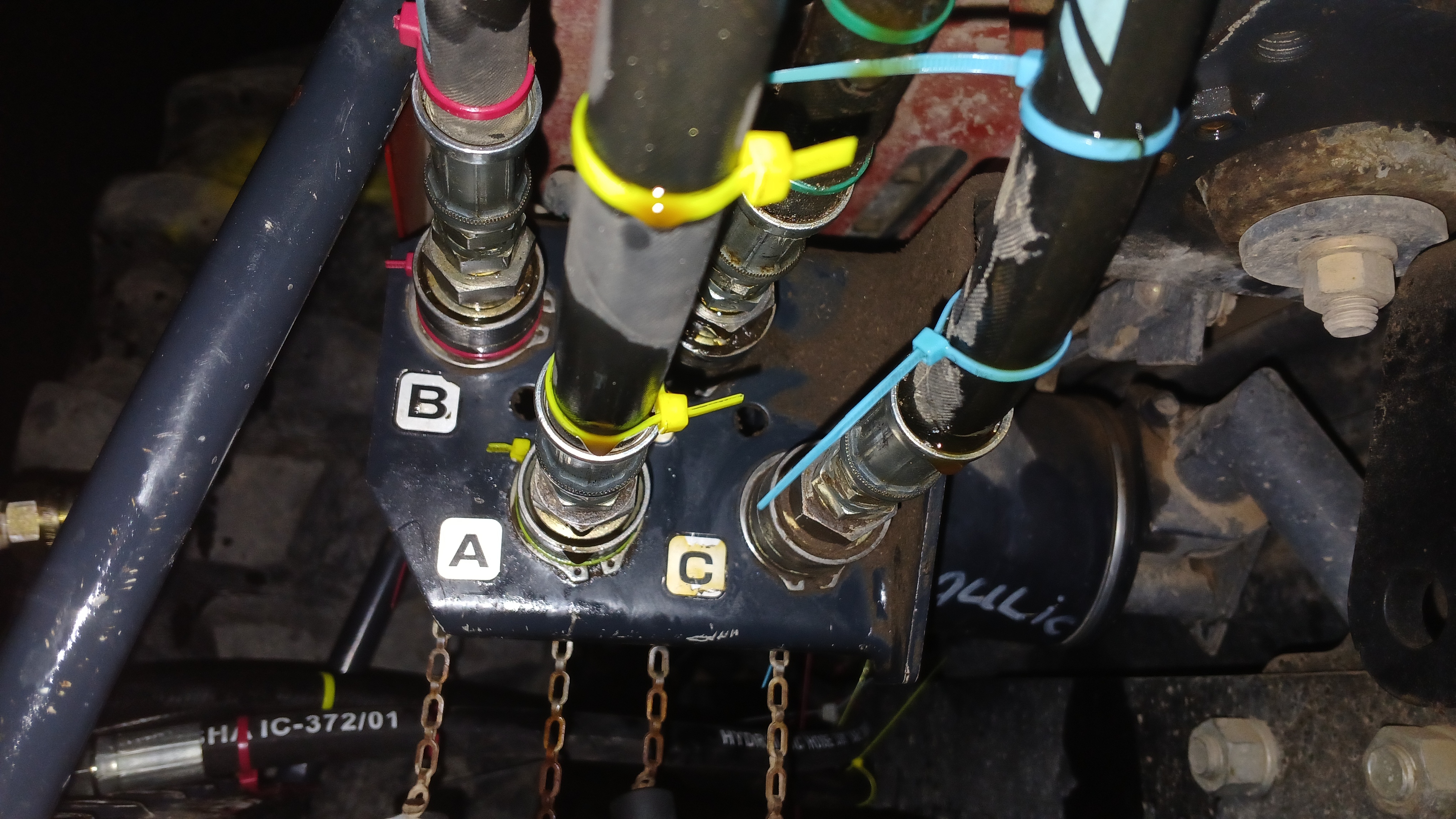

OK so. I apparently have 2 pressure ports on mine. Top and bottom are pressure out. Neither are returns. Both arrowed plugs are pressure

Isn't a sump line and a return line the same thing? Only difference is the return line feeds less used (returning pressure) to the sump and the sumps suction kills any pressure pushed in by the return line?

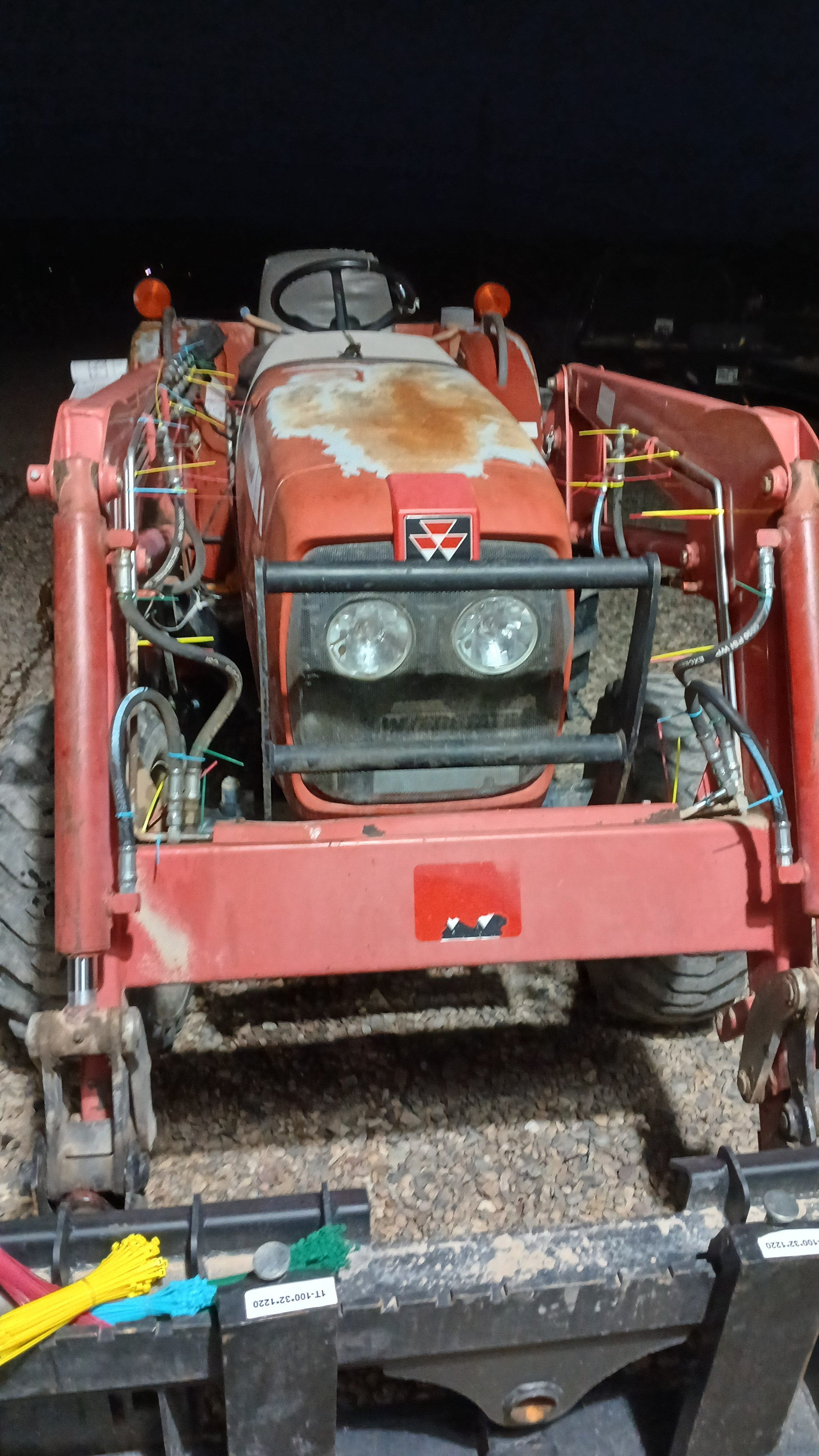

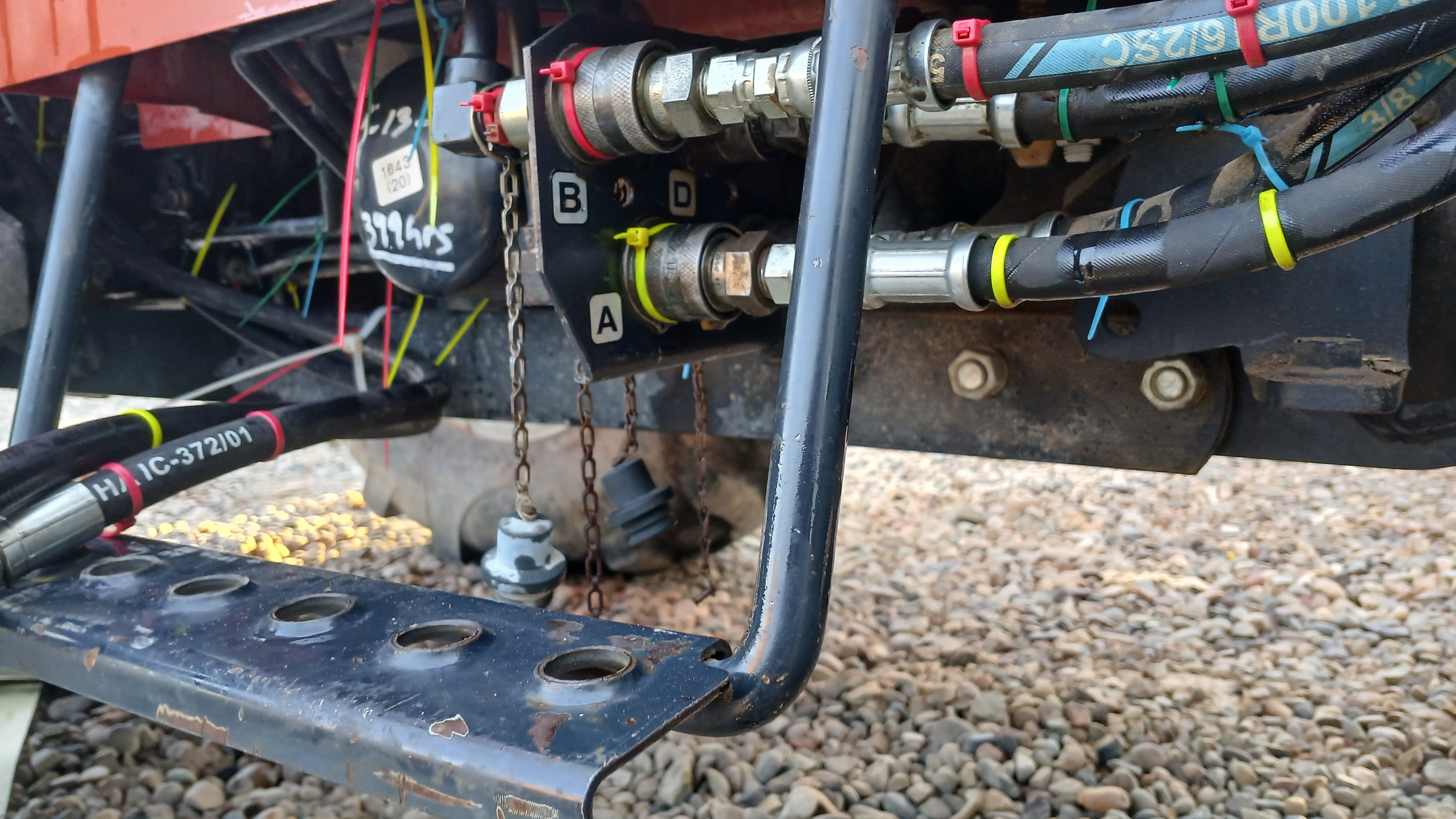

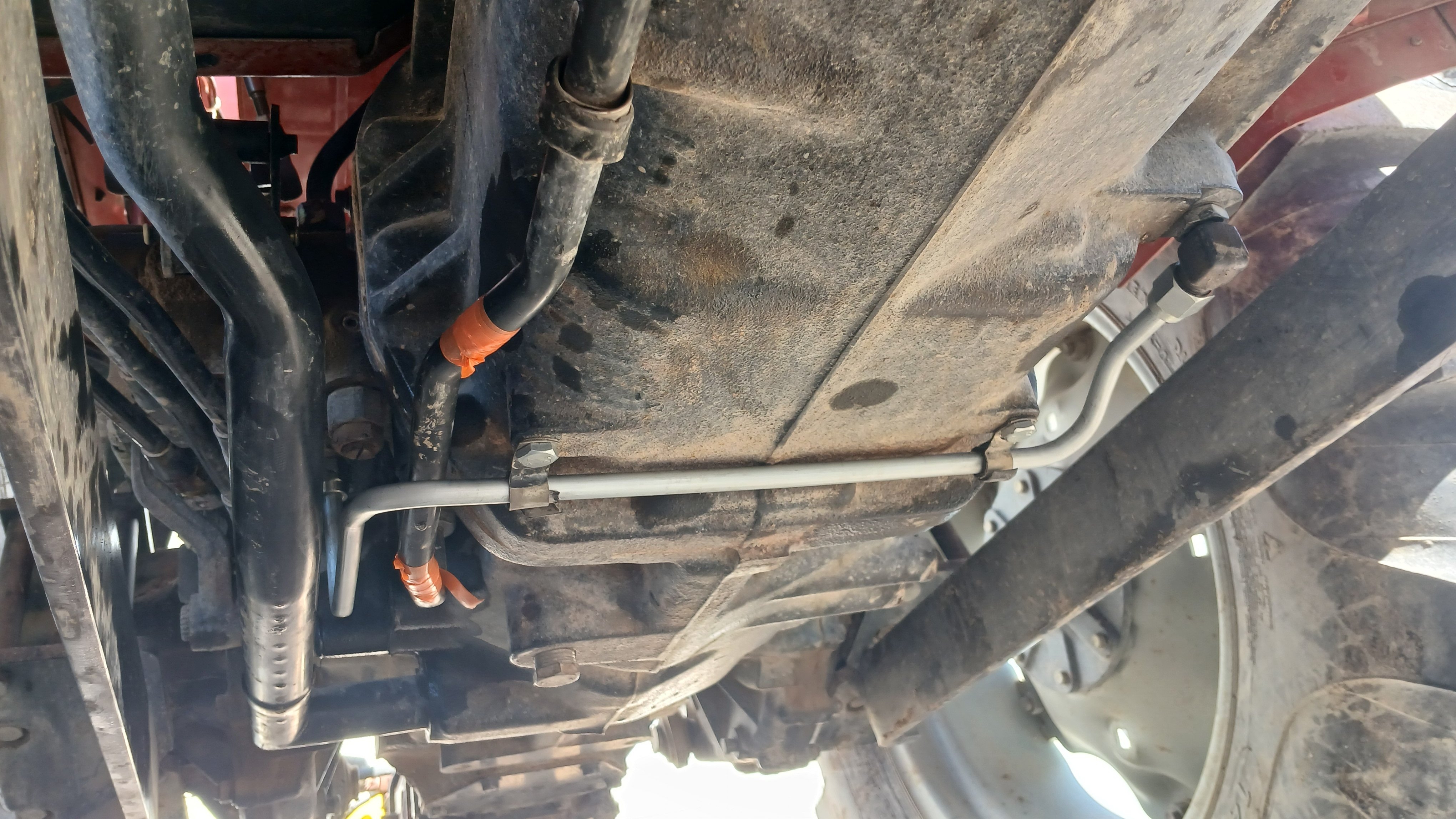

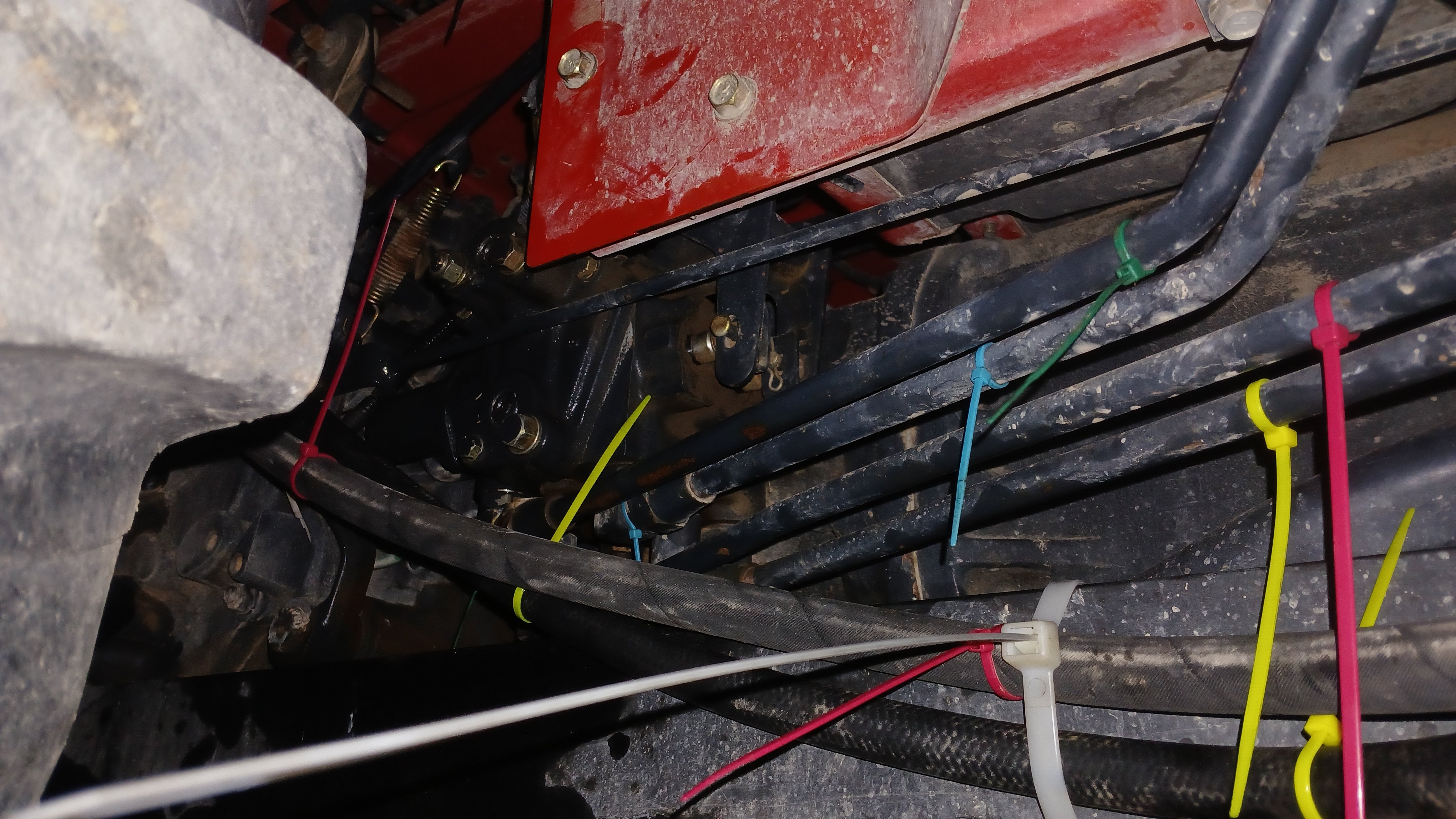

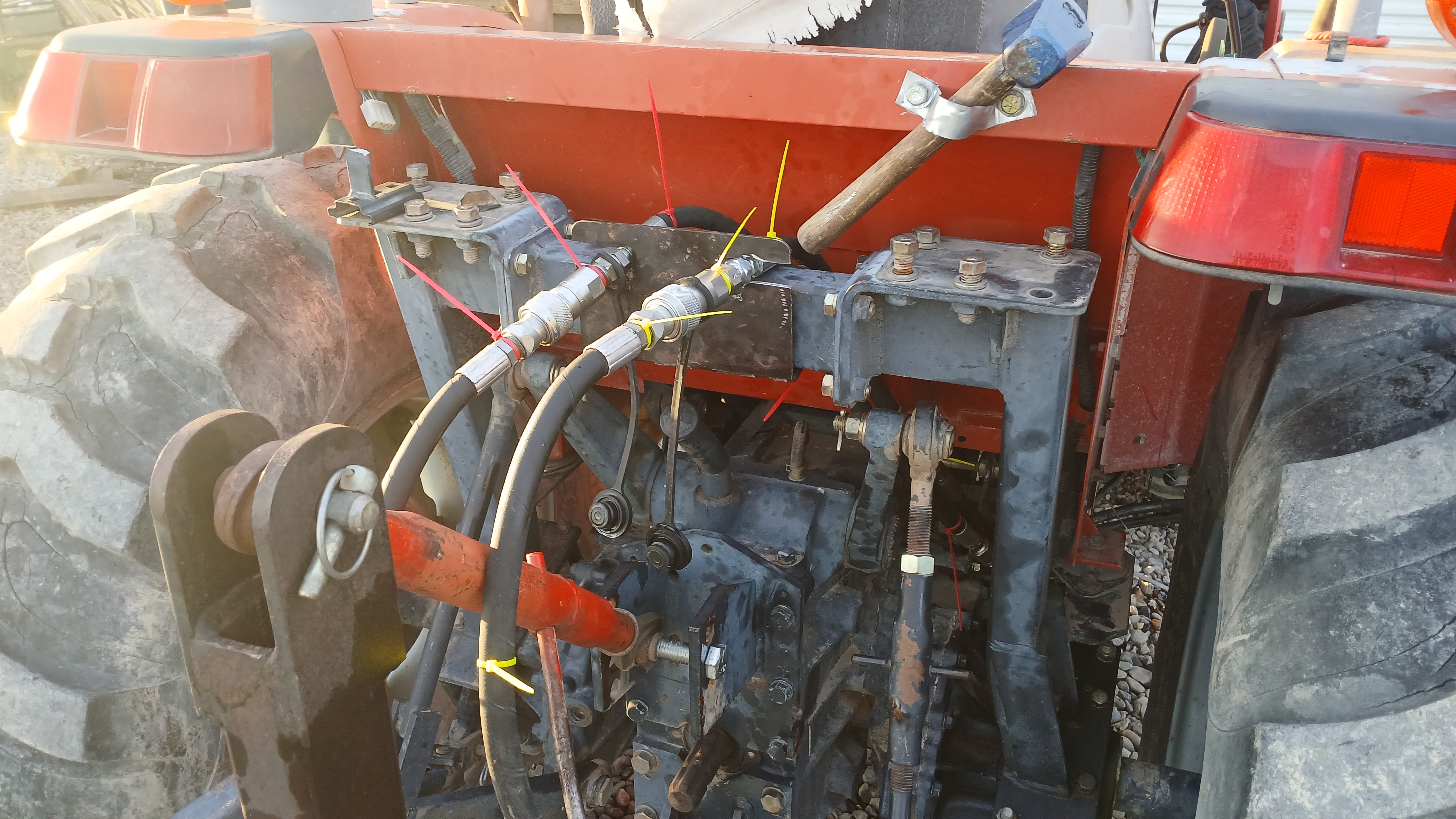

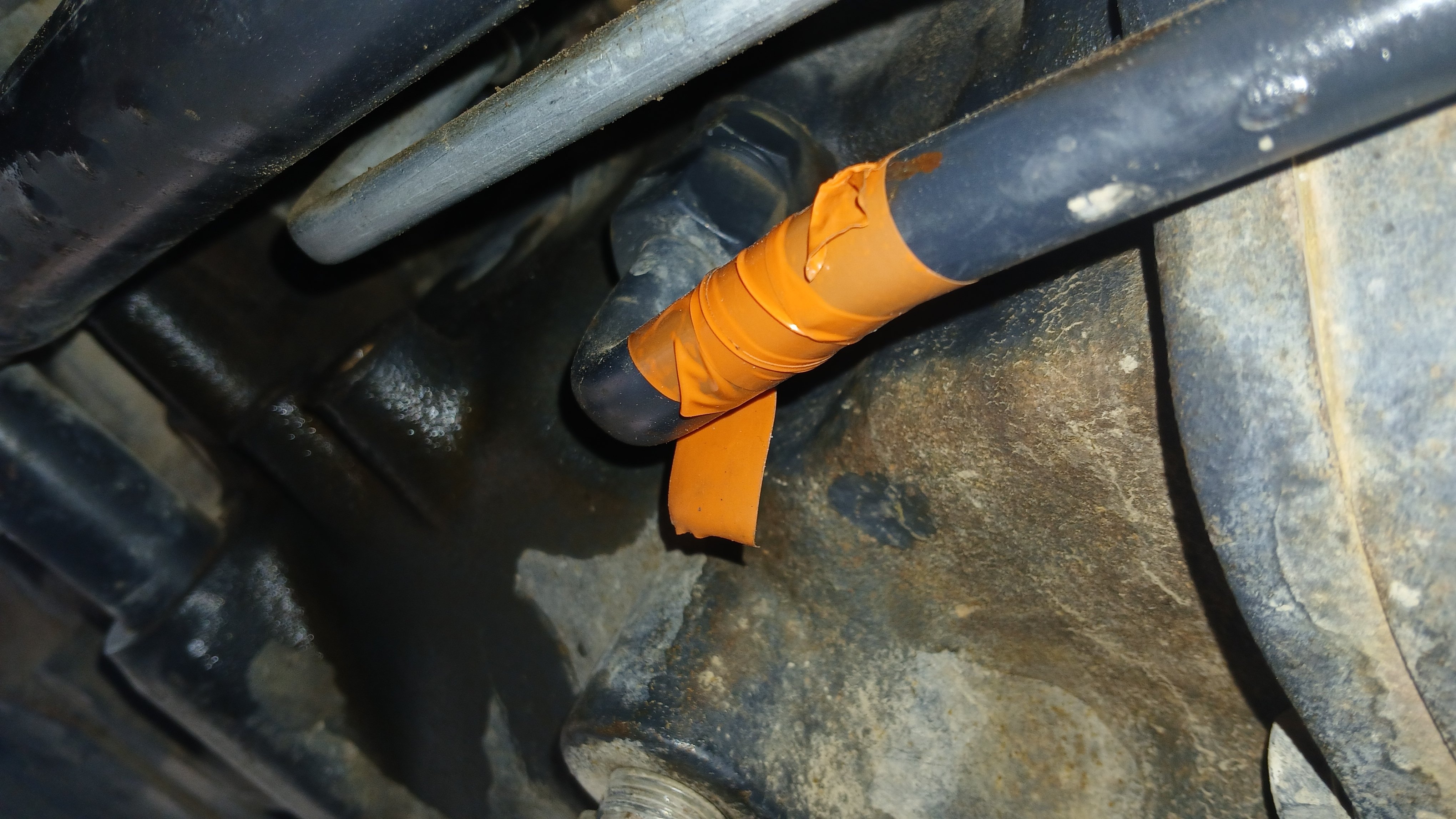

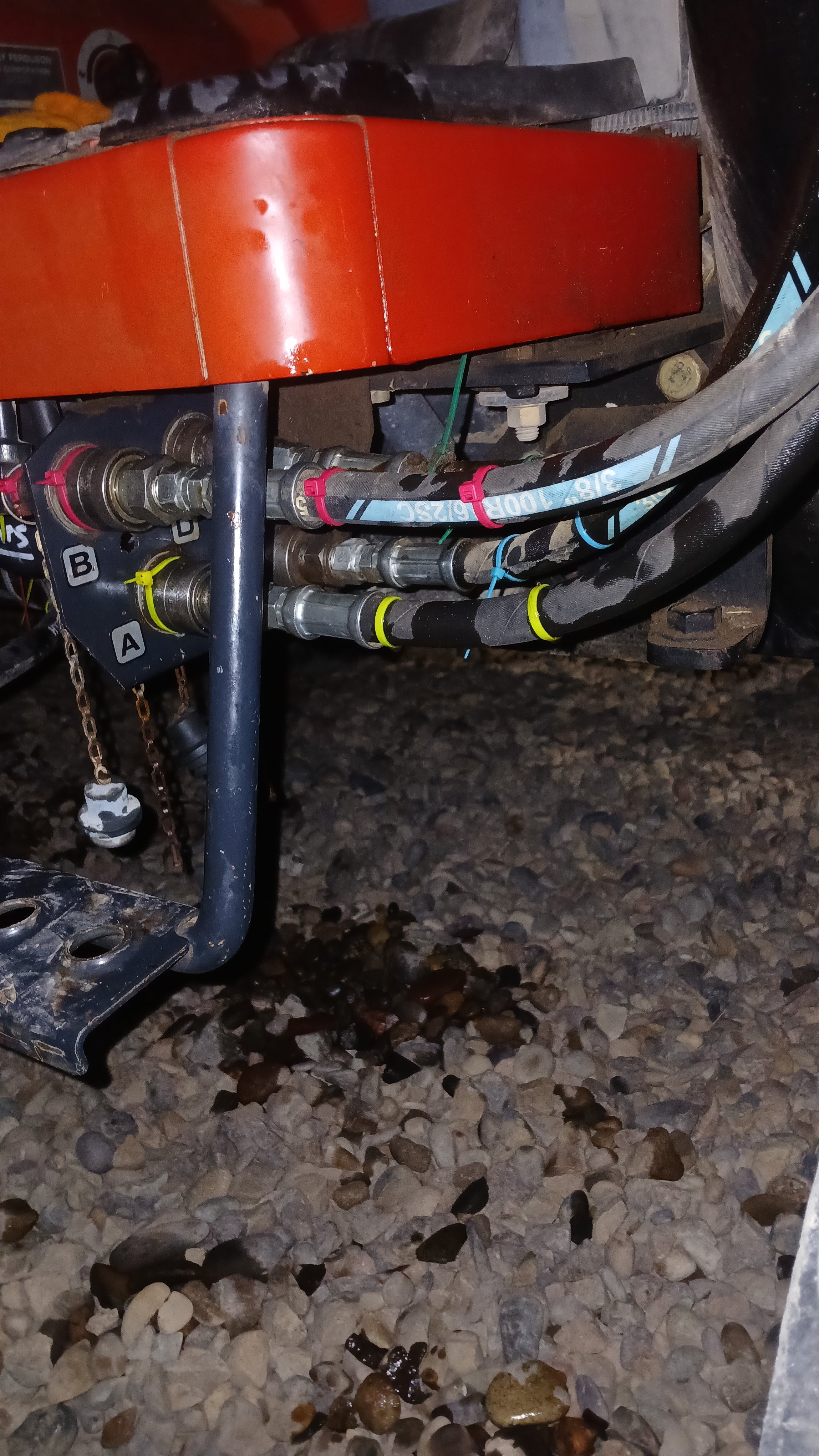

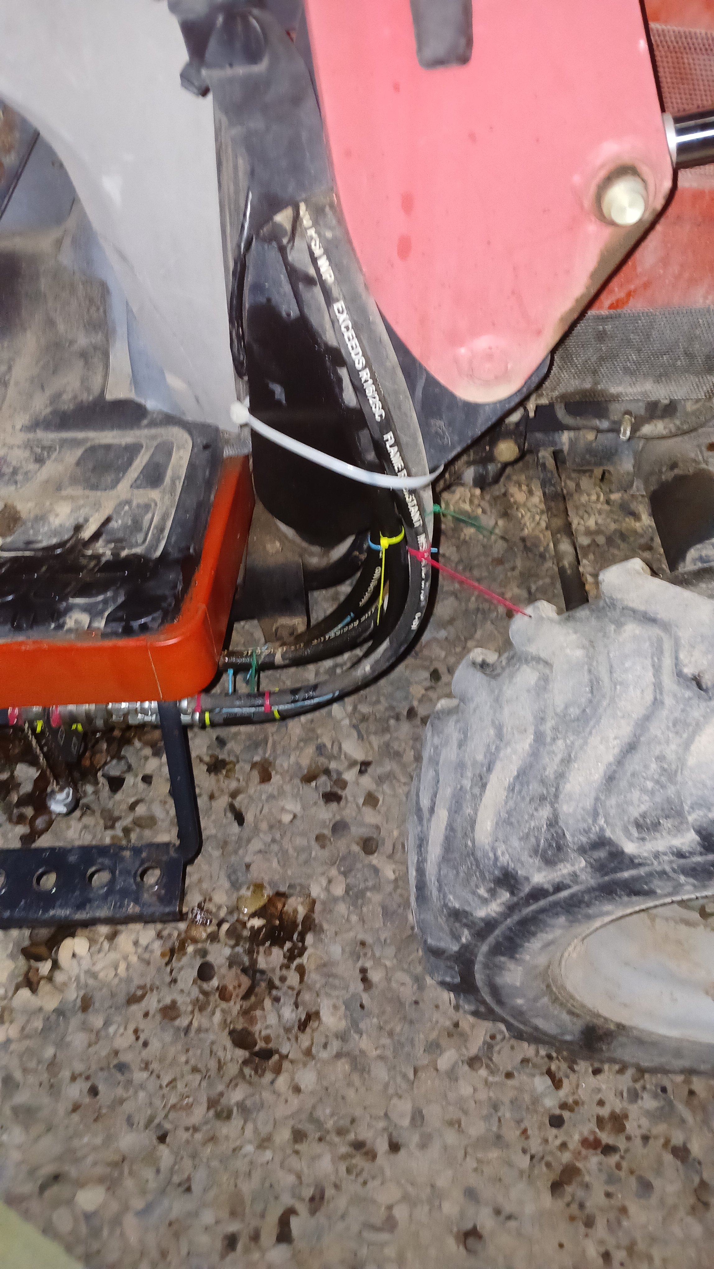

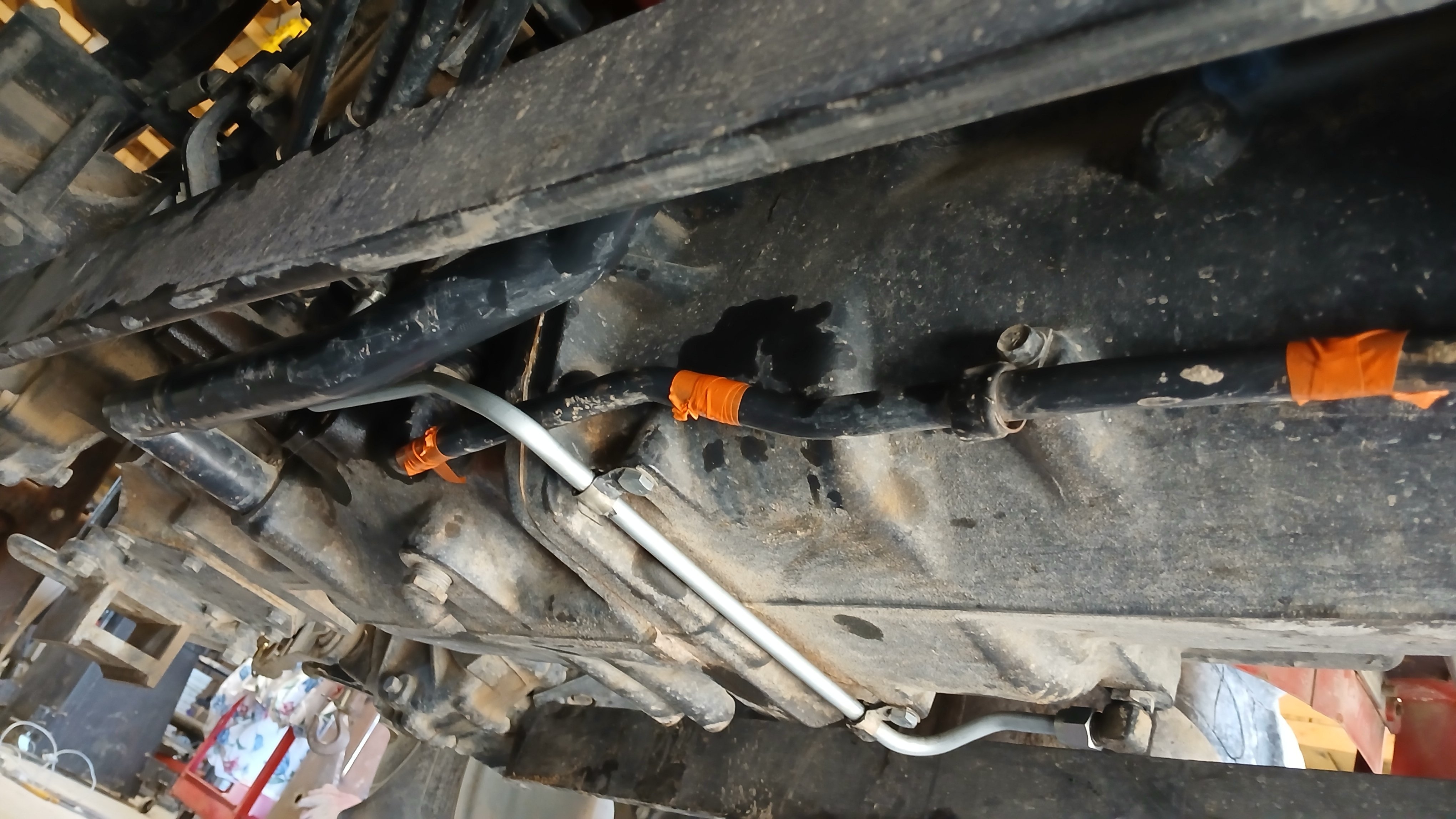

Well. Got everything together and tried it out and the control on the log splitter would lift the 3 point up until it was all the way up. Then it would allow the splitter to work. I just scrapped the whole idea and ran hoses from the pass side step quick disconnects, to the rear and have 2 female quick connects back there 1 for pressure one for return. Works fine and how it should. I'll just build a loader rest off the frame incase I need to use something in the rear while moving forward. Or I could just pony up and buy a 3rd function package off the internet.
   / Questions about 2013 Massey Ferguson 1533 Rear Remote install
#55
I'm done not knowing exactly where each hydraulic line goes. Even wrote the corresponding joystick direction and color for each line in the manual.
