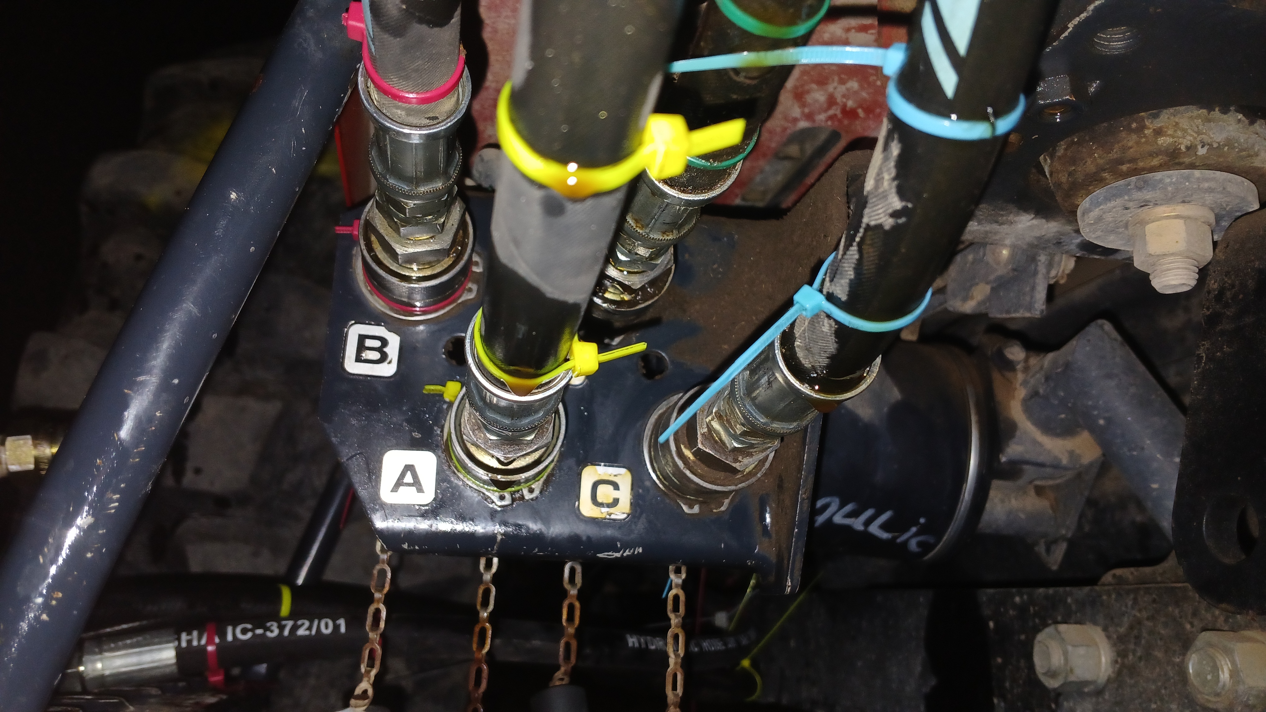

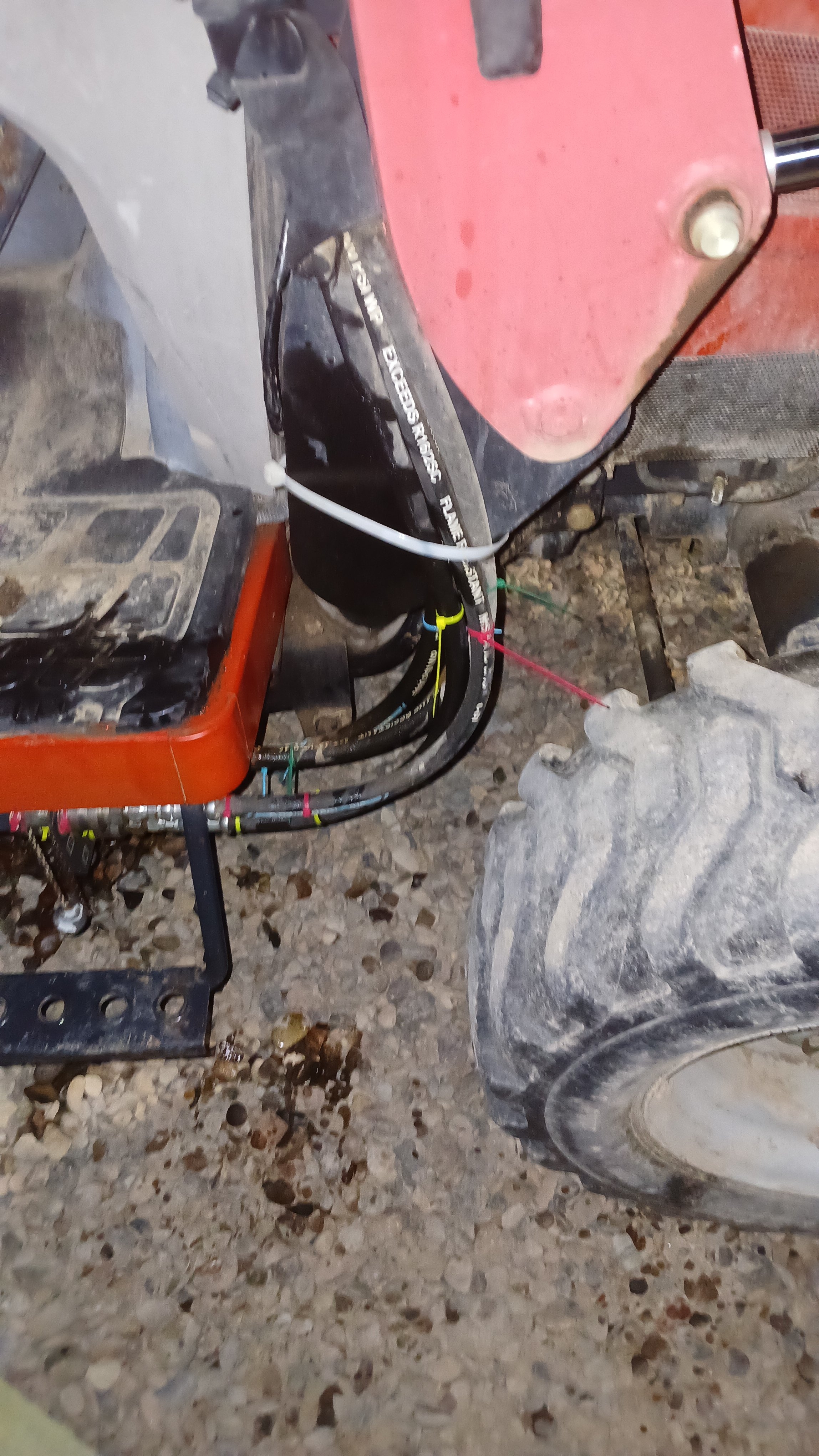

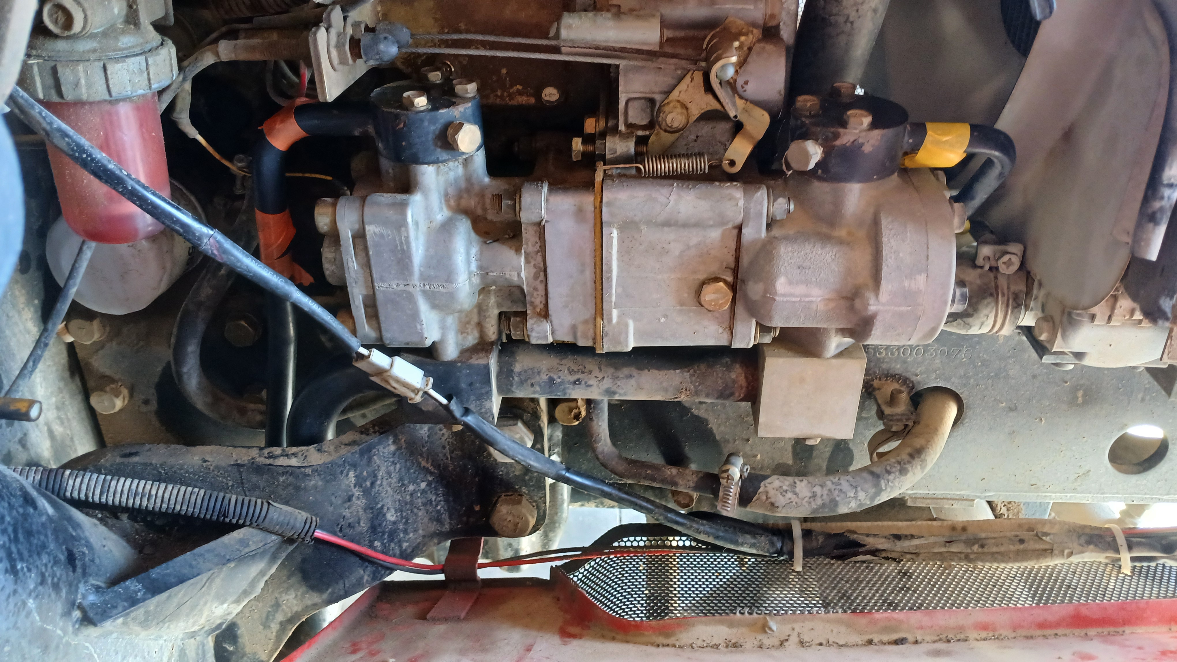

I have an old Ag tilling trailer that has alot of older hydraulic parts I can rob off of it. I made a temporary setup for now. Here's my Seatbelt throttle for it.
I am not able to follow exactly what you did (but that's OK as long as it works!) There is something rather undesirable about having to hold your joystick back (or in any direction) with a seatbelt or any other means. That says you must be disconnecting your normal front end loader hoses such that you can attach your "connect back at the rear" hoses. Then using the joystick to cause fluid pressure where you want it.
But I get it -- temporary is temporary. And amazing progress really. Pretty resourceful.

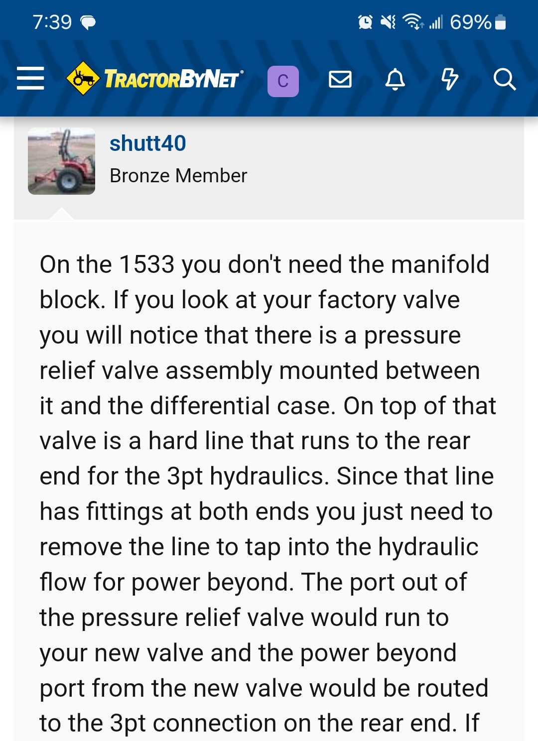

OK so according to this paragraph and my interpretation of it. All I need to do to have a "power beyond" is to intercept and tee off of this hard line going up next to the FEL valve and into the top of the 3 point.

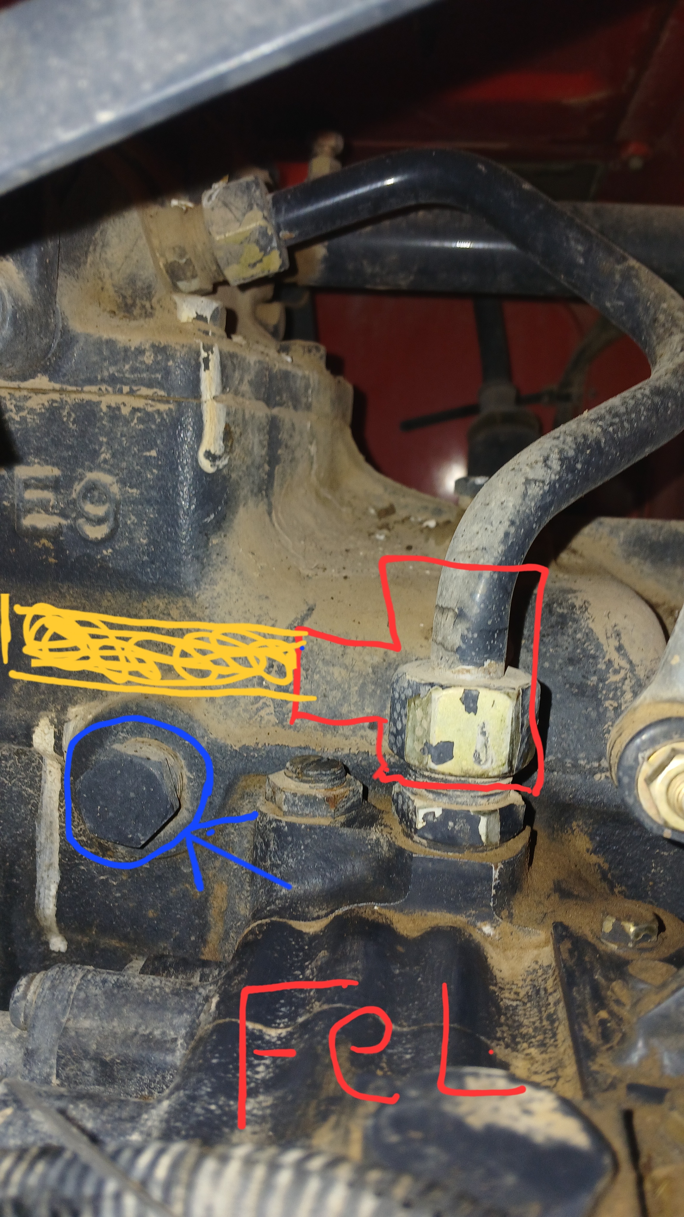

I believe this is the line they are referring to. It's the only line going past the valve towards the rear end.

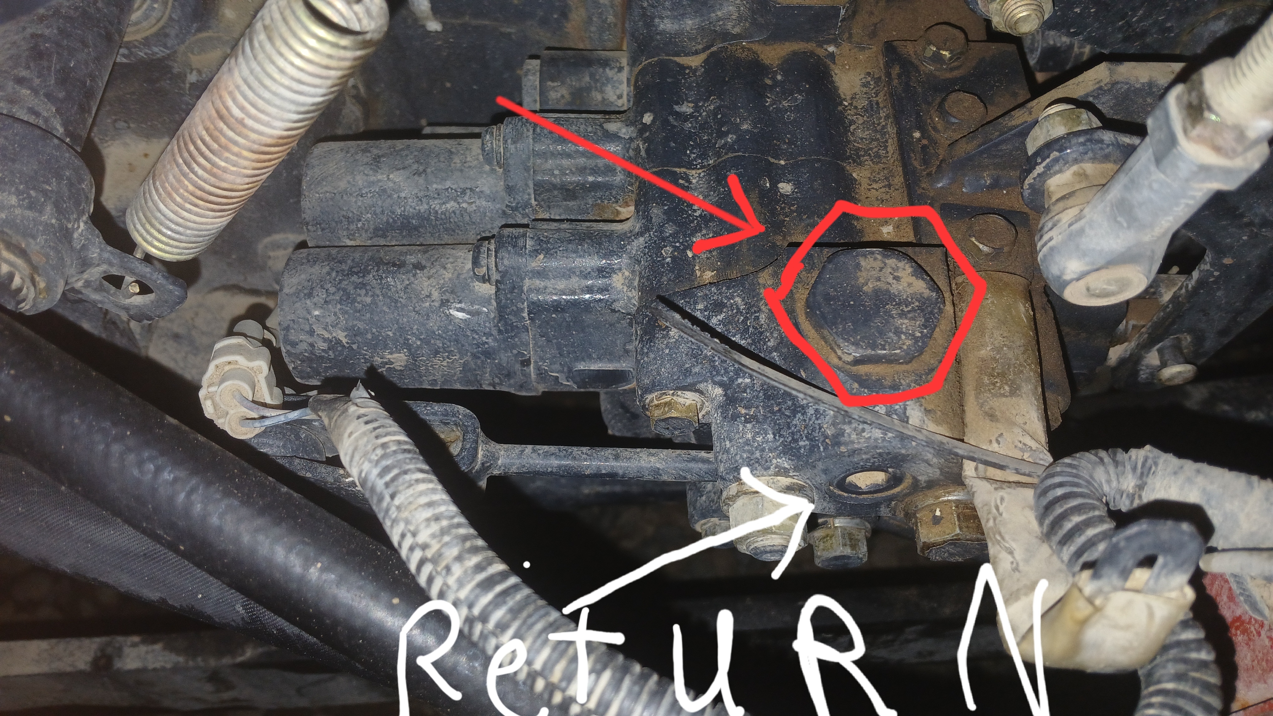

If I understand correctly I'll need this setup... is the plug circled in blue where I need to connect my return line?

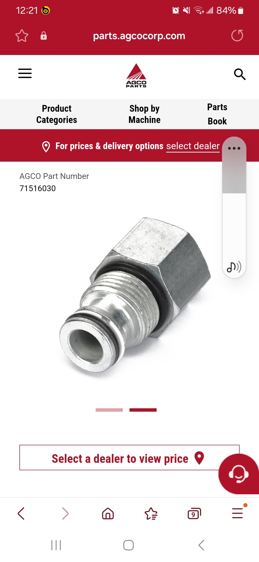

I have and with not a great outcome. They couldn't find one. They said it was a dealer option on new tractors but they don't do them anymore, as an aftermarket setup on older tractors. I called them today after reading your post and talked to them for a little bit. They're going to dive into it a bit further and see if they can find something for me. Thank you
   / Questions about 2013 Massey Ferguson 1533 Rear Remote install
#30
Did you call a Massy dealer to check price on a power beyond kit? I don’t remember it being super expensive
Got a call back. He said all they have on it is a power beyond adapter sleeve. It's like 3"s long and $97s.
